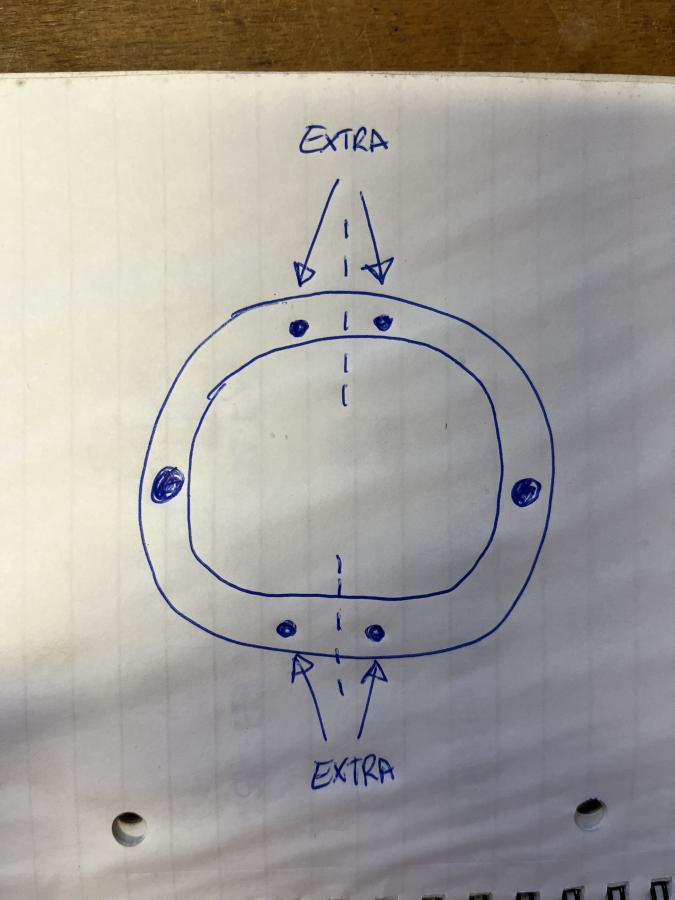

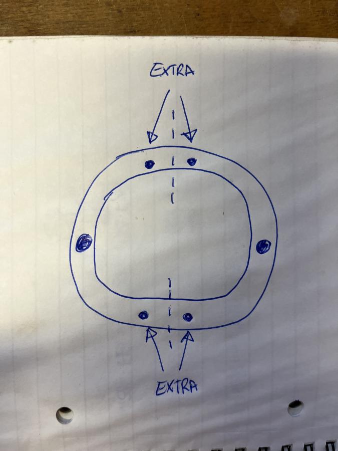

          Thanks for the welcome f4u ausie & Aros.
          first question i have is what is the recommended diameter and length of the extra carbon fiber rods for joining the two halfs of the fuselage together?
          thanks.

              Hi SR,

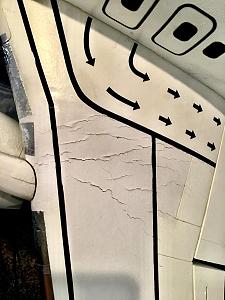

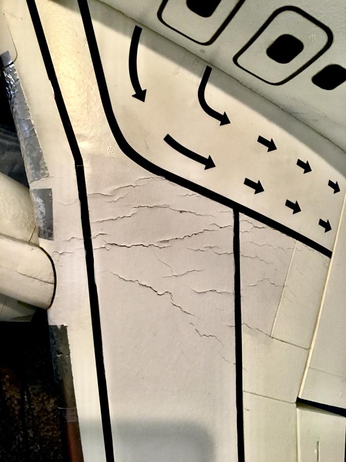

              I used what I had handy. 2 inches in length, and small enough diameter so you can drill holes in the fuselage walls and leave foam all around the rod.
              2 rods embedded length wise on either side of top dead center and going across the fuselage joint is all it takes. Go about 1 inch “into” each fuselage “half”.
              If you want to avoid top wing skin cracks that will happen after a lot of flying, remove the motor nacelles from the wing so you can get to the wiring channels in the wing. Flip the wing over so the top wing skin is on the work surface. Cut as long a piece of about 1/4 inch square carbon rod that you can fit into the length of the wiring channel and epoxy the rod against the inside of the top wing skin. Use 5 min epoxy because you will need to press the rod against the top wing skin while it cures.
              If you elect not doing this, after a lot of flights, she will look like this…..
              -GG

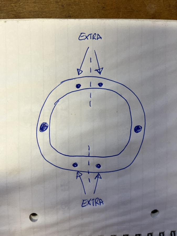

                Hi GG, thanks for your reply and great knowledge throughout this whole topic.
                if I have understood you correctly you recommend 2 x extra rods at the top, one each side of dead centre, and 2 x extras at the bottom , one each side of dead centre? I have attached what I think is correct.
ID:	387858 also , yes I read your post earlier in the topic and plan to insert a carbon square rod in the wing wiring channel.
                many thanks,

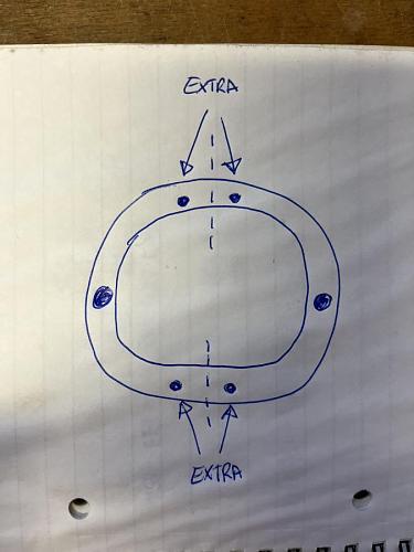

                  many thanks,
                    many thanks,
                    The bottoms are not needed. They won’t hurt, but the stress is at the top caused by hard landings.
                    Looks good either way.
