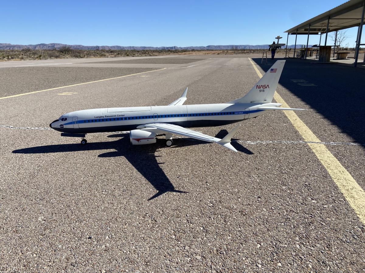

          • I've been flying mine with no gyro since day one. It's just a matter of personal preference. I use Spektrum but just a 8000 receiver nothing fancy. 100% throws with 30 to 35% expo. I did bypass the blue box on my elevator. I love the way it fly's.
            Click image for larger version  Name:	IMG_4239.jpg Views:	0 Size:	314.6 KB ID:	398005
            Mike

              Agreeing with the no gyro and expo comments.
              I installed the gyro to reduce the tail wiggle only. A gyro stops that nicely.
              -GG

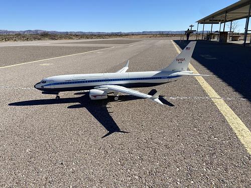

                                    • I haven't experienced that issue. I did bypass the blue box on my elevator.
                                      Mike
                                      Click image for larger version  Name:	IMG_4239.jpg Views:	0 Size:	314.6 KB ID:	400362
