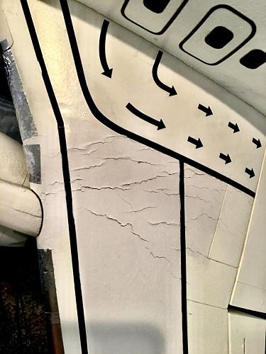

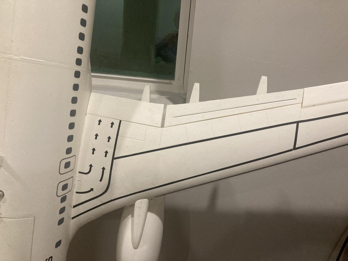

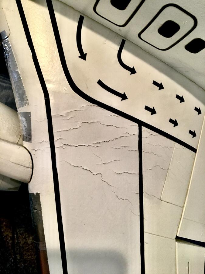

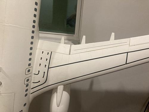

                      #2290
                      Click image for larger version  Name:	7296F5DE-CA8C-4C5A-ABBE-290DC194A2DB.jpg Views:	0 Size:	79.8 KB ID:	368773Hi Spad Driver,
                      Additional evidence regarding upper wing skin reinforcement with 1/4 inch square carbon tubing epoxied to the top skin inside the wing wiring channels.
                      Both wing photos were taken after a LARGE number (several thousand) of flights…and I do aerobatics.
                      Photo above is my current bird. Photo below is my RETIRED first bird (paint didn’t match after an attempted cosmetic fix).
                      The need for extra internal carbon is self evident, if you plan on flying her a lot and doing aerobatics.
                      It’s an EASY mod and well worth doing.
                      -GG

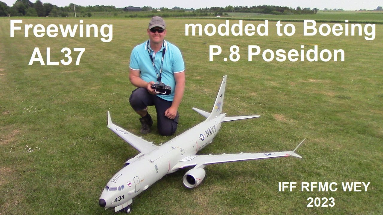

                                          #2300
                                          Here's a video showing the P.8 Poseidon from my friend Robert, recorded at last weekend's EDF meeting in Wey, Germany.
