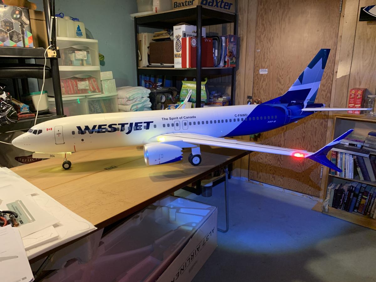

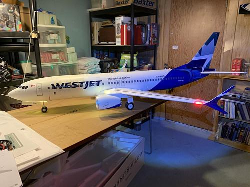

            As a Canadian who owns this plane, I can make some suggestions for you. My AL-37 came from MotionRC many years ago and the graphics from Callie Graphics in WestJet theme. However, times (tariffs, etc) have changed. We Canucks will pay the shipping again from MotionRC. Their prices already includes shipping from China to them but that free shipping only applies to US customers. Not only will you pay for additional shipping, you will also pay hefty brokerage fees and possibly additional tariffs. As for the receiver, there is no such thing anymore as a "MotionRC reciever" (Admiral). Those are no longer sold. They now sell the true "Lemon" that the Admiral was based upon.
            Now for up to date news for Canadian buyers. RC Castle, based in Hong Kong sell the AL-37 and the Lemon RX (get the 10-ch stabilized RX, also get the satellite RX for it). By today's standards, even after you've paid for the seemingly exorbitant shipping cost (don't select the cheapest method as that can take up to 3 months by surface shipping) and the small Canada Post brokerage (+GST), you will still save a hundred to 2 hundred bucks over the "to your door" cost from Motion. Another option for a RX is the latest Spektrum AS3X+, with serial satellite but that will cost you dearly. These can be purchased from your local hobby shop or from Great Hobbies online (they also sell the Lemon but it's cheaper from RC Castle if you include it in the box with the plane). Of course, what you use for a RX will be dependent on what transmitter you will use.
            As far as batteries are concerned, these can only be shipped via ground. Your best option is the buy them from Amazon.ca as ground shipping within Canada is fast and you won't have to deal with customs. Target the HRB, 6s, 50C, 6000mah. They will be cheaper than anything else you can buy from the typical US suppliers and HRBs will serve the purpose well. You can also buy Gens Ace from Great Hobbies if you like but these are a higher cost.

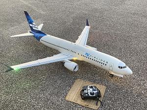

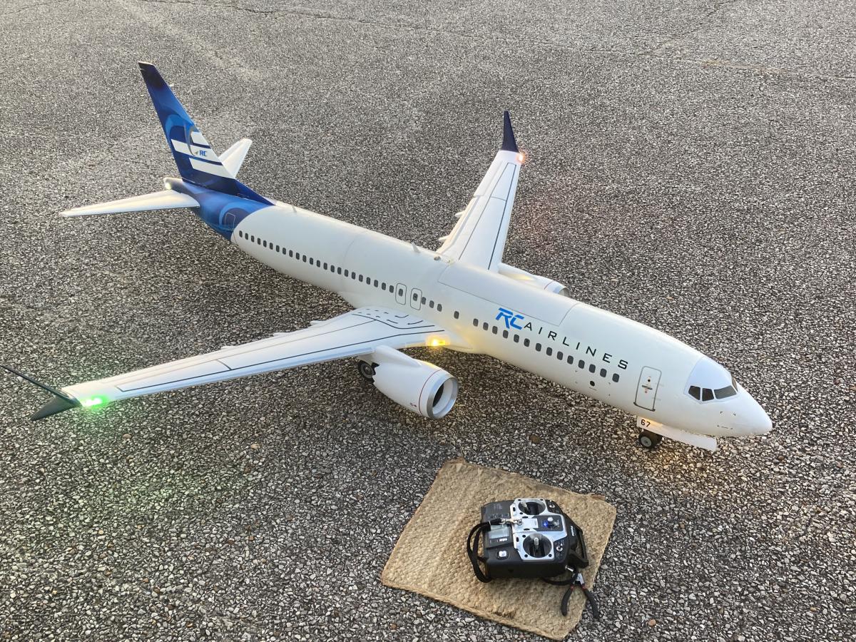

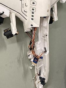

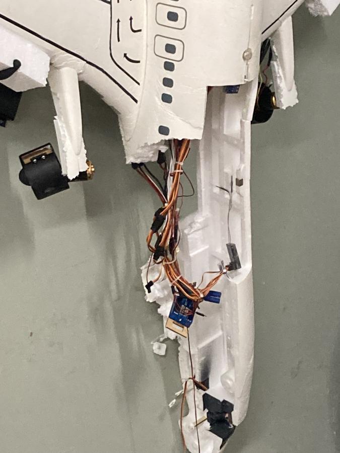

                  Say hello to Frankenbird! A crash pretty well took out my AL-37. But wait! There’s the hangar queen I’ve been using for spare parts for years! It was grounded because of wing stress cracks which kept coming back. The hangar queen’s fuselage was fine.
                  Soooo, I ordered new wings and had everything else on hand. 3 evening’s work, and Frankenbird had a successful test flight last week.
                  Many more enjoyable flights since last week’s “maiden” have convinced me that the effort was well spent.
                  The typical and suspect critical path failure points: TX? RX? Gyro? Capacitor on gyro? Servo? BEC? No way to tell…too many possibilities. Straight down from about 200 ft up.

                    Bad and good luck gg. Looks like futaba??? Even they get glitches Here or there
                    Great rebuild.. wish I didn't lose mine

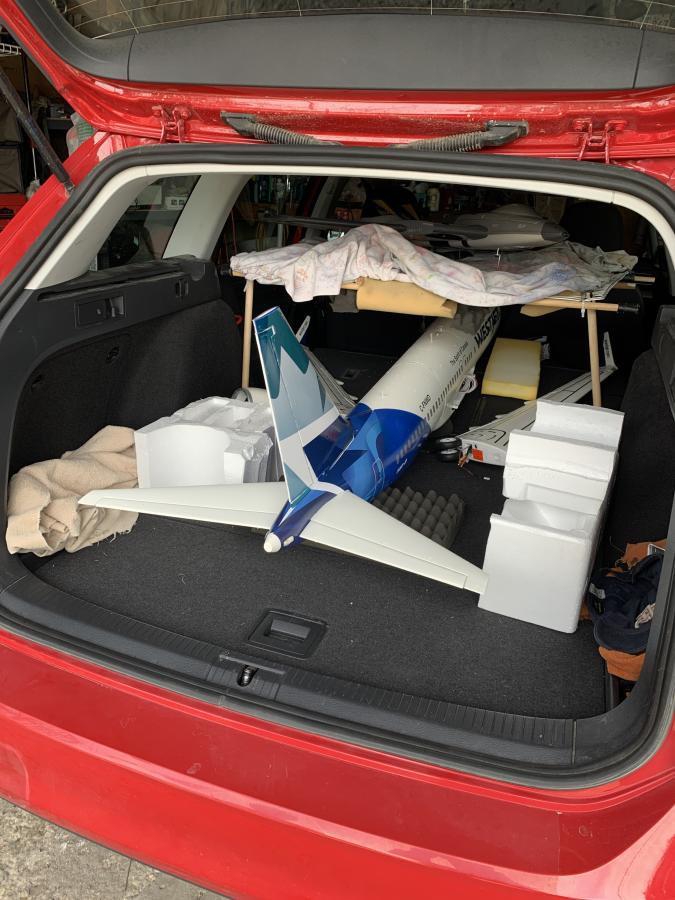

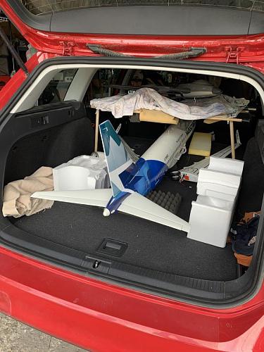

                                    Can anyone recommend or show how they transport their airline to the flying site? Looking for ideas for a cradle to support air frame and wings. Thanks
                                      • 8835
                                      #2418
                                      Gear up, wings off, fuse goes down center of SUV bed with nose sticking between front seats and onto center arm rest. Wings can go one on each side of fuse, with towels and foam pads to keep them from touching each other. With wings off, this plane can be carried almost anyway that will fit into the back of a car. I used to carry it in a Prius Prime and now carry it in a RAV4. It doesn't have to be neat and pretty unless you must insist it looks neat and pretty.
                                      I have a second shelf with foam padding and a soft bed sheet. I can carry other planes and parts up there.

                                        Here's a photo of the AL-37 in my old Golf wagon. The Prius was next and it still fit in that one. Now with the RAV4, I think I could put 2 ALs in there - one upside down on the top shelf.

                                          Thanks viper.
