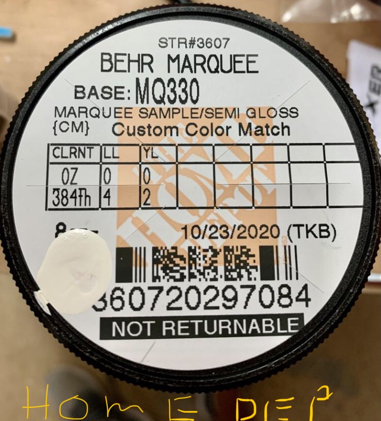

      • If I buy the plain white one, does it come literally painted white, or is it bare foam? Looking to put American Airlines livery on this plane.

          Painted…actually a slight cream color. Home Depot mix shown below:

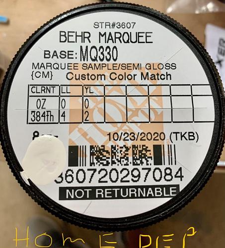

            This same paint shade is also a dead-on match for the FW F14 (bottom side), the Avios Mig17, and the FW T45.

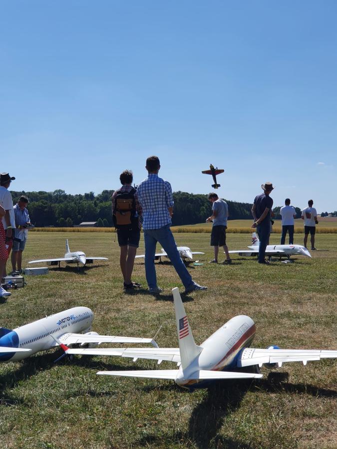

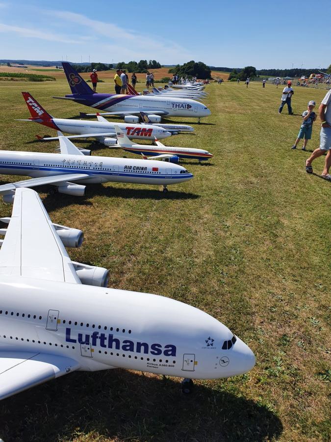

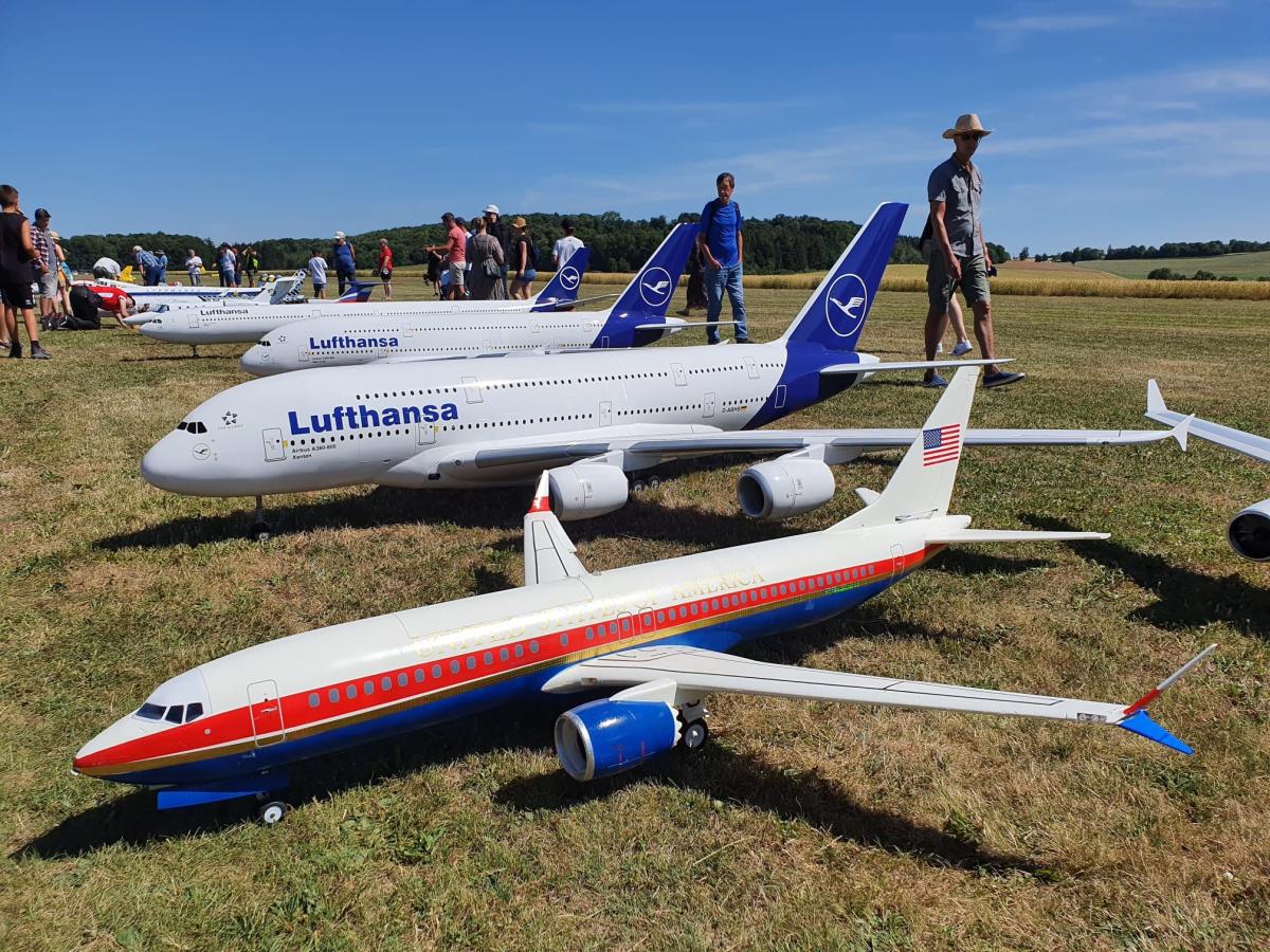

                                • our 2 FW Boeings at German Airliner meeting in Oppingen
