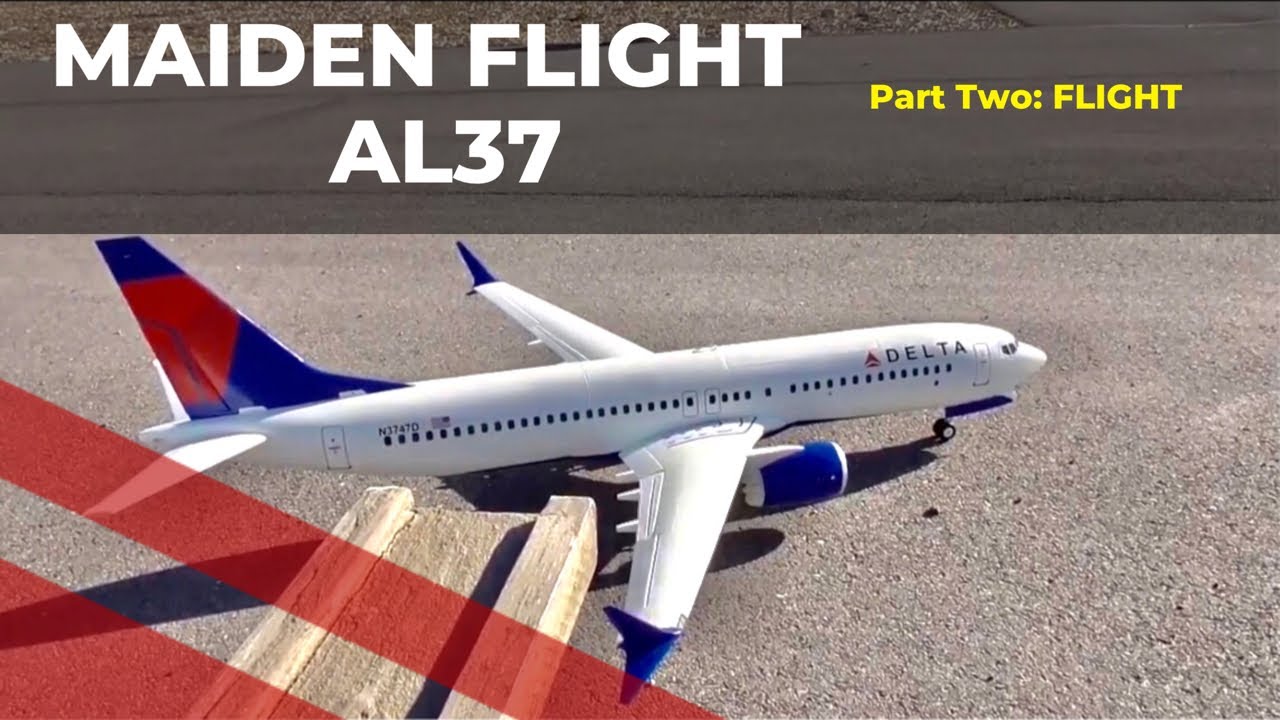

    Finally finished mine up! Pretty happy with it, definitely a couple mistakes though.

        Has anyone had issues with the back half of the fuselage kinda falling off/drooping down? I took a pretty big slam on my maiden flight landing after the battery shifted forward, glued it back up and it happened again on my next flight with a much better landing. The 2 carbon spars through the fuselage are fine and not cracked or anything, but still doesn't seem super solid.
        I just went through and lined the inside where it meets with packing tape which should help, but is this common for you guys? Anything else you've done to strengthen that area where it connects?

          Yes….known issue and discussed in this thread. A proven solution is (before assembly) to insert some short carbon rods into the fuselage top near the top center…one piece on each side of top center. The side rods are not sufficient unless you did an excellent job of gluing this fuselage joint. Typically, a perfect glue job is not made.
          Post assembly, however, your option is to glue in several pieces of bracing inside and in several places along the seam from the top around to the sides. I even did this with hot glue, but CAUTION you can get a bad burn.
          Packing tape may not be the best answer…needs to be a more permanent fix. This joint sees a lot of stress.
          Check the bottom of the fuselage, you may find compression fractures. I had to add some external bracing there, too. But…the bottom is out of sight.
          If you are good at cosmetic skills, you can trench each side of top dead center of the outside of the fuselage and insert/glue in some carbon or plywood into the trench. Fill/sand/paint - Could even use the white tape provided in the kit to cover your work.
          Bottom line….make it STRONG by any method you choose. Tape is NEVER a permanent fix for anything.
          -GG

            Yeah, I have a couple of decent pieces of wood I was thinking of using as spars for the top and bottom, think that should help a decent amount. Glad to know it wasn't just bad assembly on my part, but wish I would've known before I assembled it! Thanks, man

                Took your advice and added some more internal support with a few wooden spars glued around the seam, and my third flight felt awesome and completely locked-in. I had some issues with the battery moving and shifting the CG a bit on the first 2 flights as well, but have that sorted now too. Appreciate the help! Here are the 2 sketchy first flights, ha:

                  Never could quite understand why the tail end would bend and fall off. Then I see in your video that you don’t use the tape that comes with the plane. I’ve had some fairly hard landings but not to the extent that your video shows. I think the tape helps. I’ve never had any indication that the tail end on mine has ever even thought about bending.
                  • GliderGuy
                    • 1417
                    #2049
                    From each side carbon rod up to the top center and over to the other side carbon rod is an unsupported glue joint as you know.
                    It’s all a matter of how well the assembler makes this glue joint. Did they score the faces of the foam with a razor knife? Did they use sufficient glue? Etc…. The variables can make for a weaker glue joint.
                    A hard landing, or multiple hard landings, or a moderate crash into an unseen hole (YouTube video) provide sufficient stress to open this glue joint.
                    My #1 AL37 did it, too. I was flying off a short runway area and could not allow ANY float. I had to “drop her in” so to speak. The glue joint opened up after several landings. Repair included adding internal braces across the seam.
                    After I wore out #1 and retired her, #2 bird got the carbon rod treatment. I drilled two small diameter holes into the foam running parallel to the side carbon rods but located on either side of top dead center of the fuselage about 2 inches apart from top center. I also read about scoring the foam faces of the joint. When all this went together, now there were 4 carbon rods supporting the joint. 2 small ones about 4 inches long each at the top and the 2 long side rods. Actually, even hardwood dowel rods would work. Anything to strengthen the bare glue-only joint across the top.
                    This glue joint isn’t about to split now….cosmetic joint tape added or not.
                    As posted prior, pilot error and the distraction of a non-extended main gear lead me to fly #2 bird into a lamp post. UGH. Total loss. I can happily report #3 bird got the same carbon rod treatment at the top and isn’t showing any signs of splitting even after several hundred flights.
                    Also, posted earlier, addition of carbon glued onto the top skin of the wing INSIDE the wing wiring channel is a proven way to prevent foam cell boundary cracking on the top wing skin. Bird #1 was retired because of this…got too ugly to look at….see below (my poor attempt to repair the cracks didn’t work).
                    #3 isn’t doing this. Even after lots of non-scale aerobatic flying. The added carbon inside the wing wiring channel works like a charm.
                    -GG
