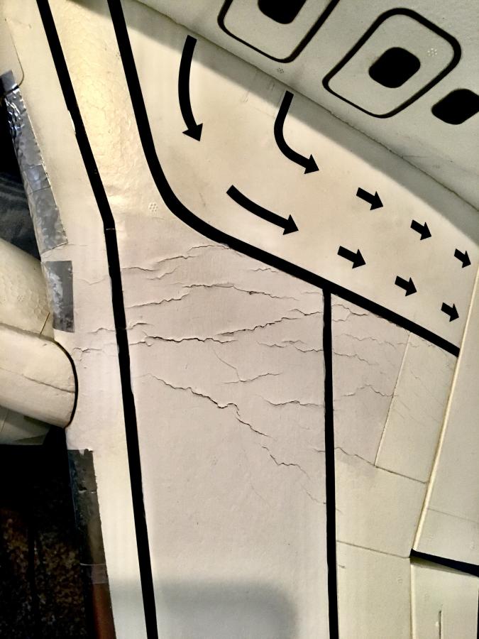

    Especially for those of you getting new birds (or anyone), if you will insert a small carbon rod or square or tube in the wiring channel that extends from the root of the wing and make it long enough to extend past the motor mount...and epoxy glue it to the top of the wiring channel, it will prevent this from happening...see photo. I retired this bird and got another one.
    After several hundred flights on the new one...not a single ripple or crease in the top skin. The addition of the internal carbon reinforcement REALLY works. If you do this reinforcement, your top wing skin will stay in like new condition.
    Click image for larger version  Name:	AL37_Top_Skin.JPG Views:	0 Size:	74.0 KB ID:	301177
    This bird was retired after about 2,000 flights even though the cracks aren't of structural concern, since the main loads are handled by the main wing spar. But, they sure don't look pretty.
    -GG
    P.S. Yes...I did aerobatics with the bird. But I also do them with the new bird. The wing skin on the new bird is staying perfect...due to the carbon glued inside the wiring channel to the foam that forms the top wing skin.
    I did attempt to fix the cracks, but failed. They came back and just kept getting bigger. Paint didn’t match....LOL
