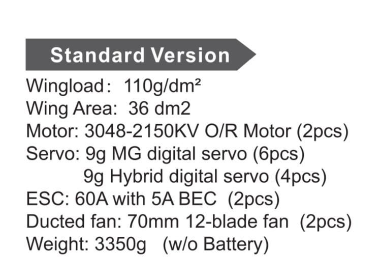

      • Anyone calculated the Wing Cubic Loading on this plane?
        • From the manual....
          The 110g/dm^2 is calculated with the weight of the battery included.
          Click image for larger version  Name:	062FFDD7-578B-4447-A540-9DD9B2418B28.jpeg Views:	0 Size:	68.8 KB ID:	281048
          • I'm actually just trying to confirm my calculations. My plane has come in at 4962g all up flying weight, and with the wing area of 36 dm2, gives a wing loading of 138 g dm2 (44.37 oz/in2 !) or a CWL of 22.9. This seems astronomical considering how nicely it flies. Anyone else do the calculations?
            • Works out to 0.313 oz / sq in
              Based on the following:
              1 dm^2 = 15.5 in^2
              28.4 g = 1 oz
              wing area = 36 dm^2
              4962 / 36 = 137.8 g / dm^2
              137.8 / 28.4 = 4.85 oz / dm^2
              4.85 / 15.5 = 0.313 oz / in^2
