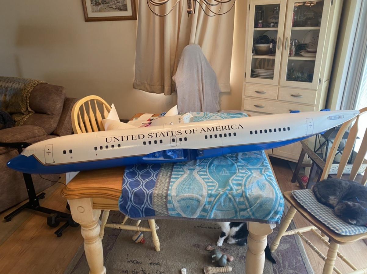

              Rebuilding my AL-37 from a battery connector failure. Had to replace the fuselage. I tried spackle on the fuselage seam last time and it didn’t work out too well because I noticed small cracks in it. The provided tape doesn’t look too good either. Anyone have any tips to share on how they addressed the seam? I’m thinking of doing an American Airlines silver bird version. Silver is notorious for showing poor workmanship.

                I use the paint I am using on the fuse and paste on a strip of gift box tissue paper as it is thinner than the tape they include. Then I paint over the tape. You can get the gift paper from Target or Walmart. But the seam must be aligned well all around before the job. I can still see the seam but it is better than the tape.

                  I just left the seams alone. Adding graphics now. Will clear coat before assembly .

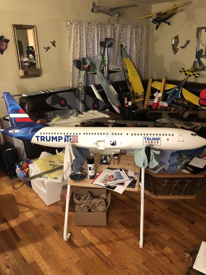

                            Originally posted by Wild Man
                            I finally got a few planes built and assembled for a few others. Now I can spend the rest of the week on my AL-37. I have got the fuse together and started dome of the painting and installing Decals. I hope to have it done this week end if I do not have to go out on call. Looking good so far
ID:	271883Click image for larger version
