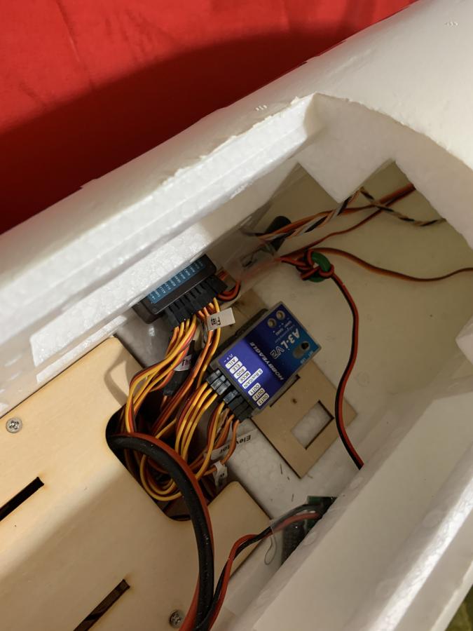

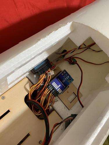

ID:	260409 Got my Max 10 configured with an FPV setup. The camera has a pan function but not tilt due to the limited lines of sight. I tried to make the FPV gear as unobtrusive as possible. Can’t wait to give it a try from the cockpit! Click image for larger version

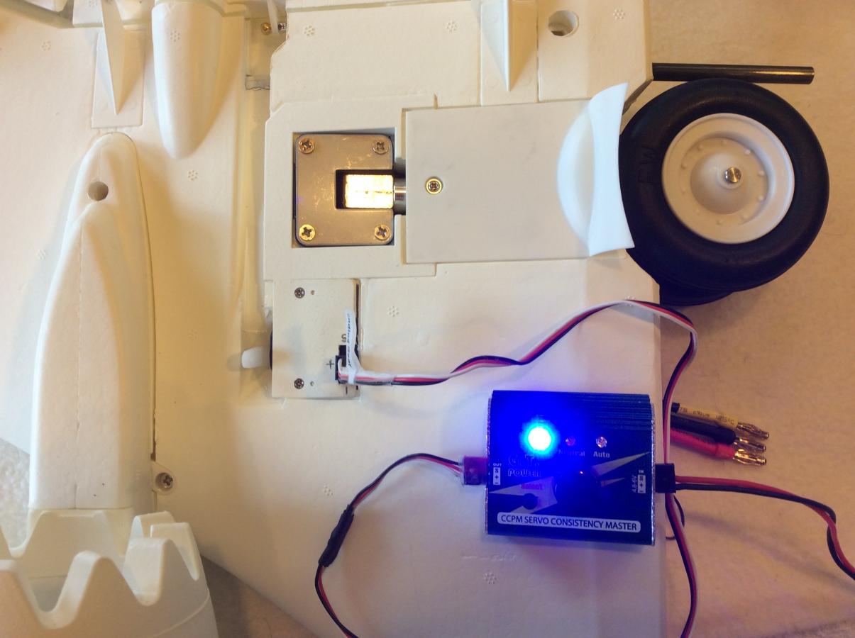

                      I’ve fitted the motor pods onto the wings, and at the same time modified the wiring for the retracts using a y lead to allow the u/c to drop by connecting a servo tester.
                      one socketend of the y lead has been glued beside the flap servo with the socket flush with the wing surface. (see piccy).
                      Once I’ve tested them a few times I’ll paint the ends white to blend.

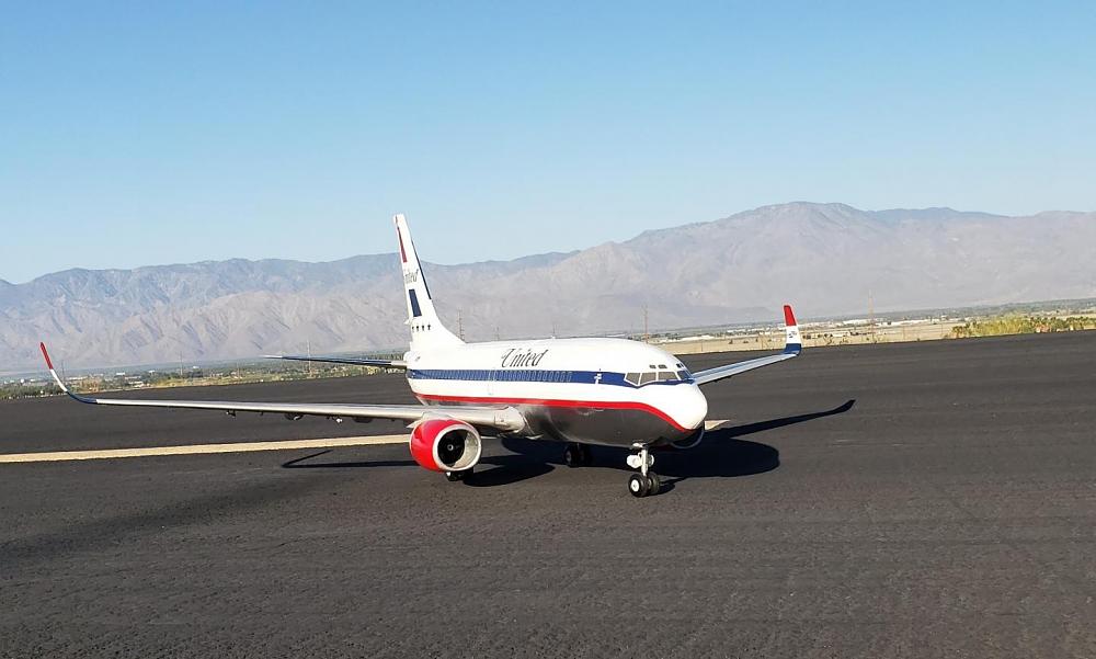

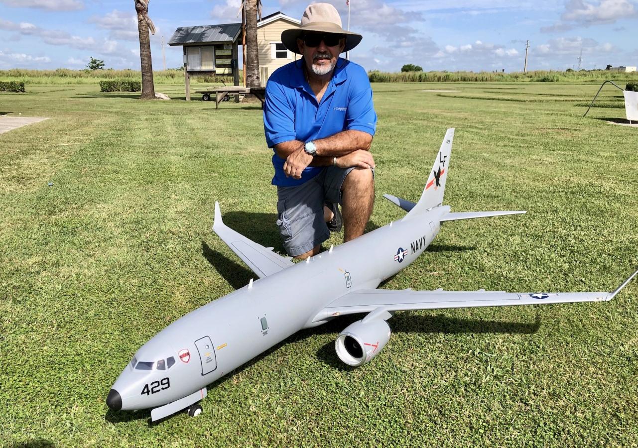

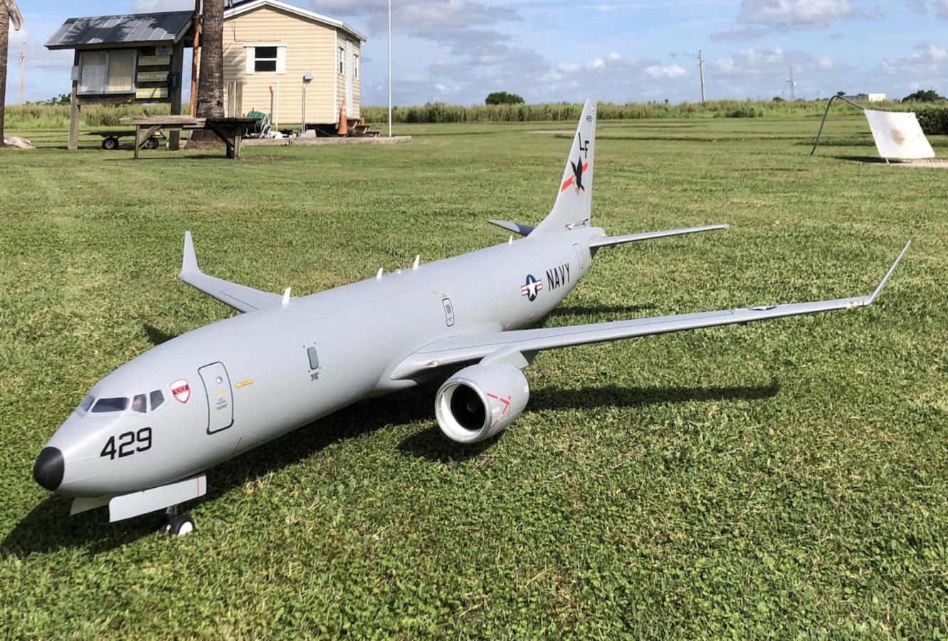

                        For what it's worth, the graphics scale wise from Callie also works for the Winrider 737. I can transport the Winrider without removing the wings.

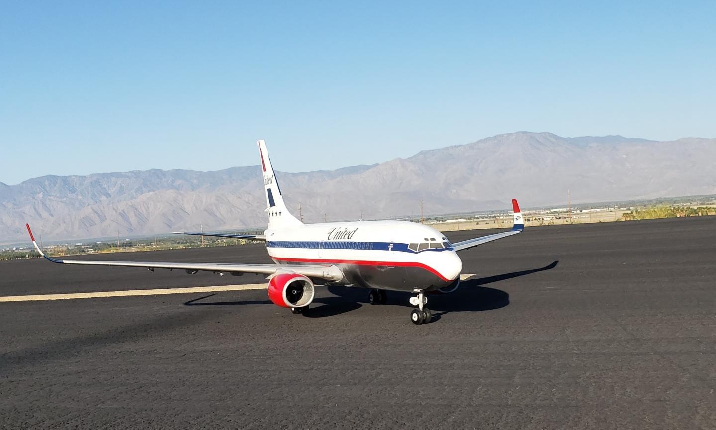

                          Finally had a good day for a maiden, not a perfect day but good enough, my last attempt was cancelled due to high winds. Today I got there early since I knew that wind would pick up. Flight was uneventful , winds 10-12 MPH right down the runway, I advanced throttle flaps at take off setting, after a roll of about 100 ft she rotated and up she went, gear up flaps up and she settled into a gentle left turn, no trims of any control surfaced needed, I was amazed. She flies great at 1/2 to 3/4 throttle, on a calm day 1/2 is all thats needed. After a few passes and about 4 min I lowered flaps on the down wind flowed by the gear. Since Im used to much larger warbird my flap setting were much less than recommended, is my experience that model plane do not need as much flaps as the full size counterpart, too much flap and you’ll just adding unneeded drag. So once lined up with the runway I reduced power into a glide slope, with the head wind she floated a bit on the flare till mains touched down. This is one fun plane and very realistic in the air, the lack of gyro made it wiggle a bit on cross wind but other than that it was a great maiden. My only complaint ....the paint scheme, the gray is hard to see, I had to ask my spotter to remove my sunglasses cause I had a hard time seeing it with clouds in the background. Great job Freewing.

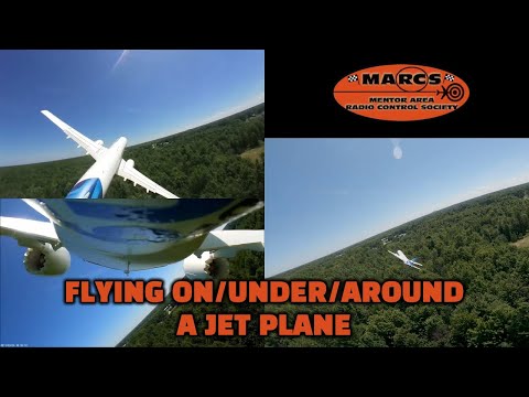

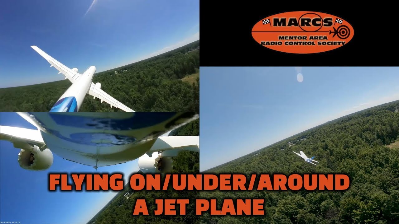

                                This afternoon my buddy Jason Bennett put together a really cool video presentation of the AL37 flying today, which consists of three different videos playing at the same time - one shot from the tail fin (using a stabilized Insta360 GO micro camera), one shot from the belly (a RunCam) and a chase video shot from Jason's drone. There are some really cool views here, enjoy!
                                I am still getting used to landing this thing correctly, I always seem to need a little more "up" at touchdown. But it was a pretty good landing.
