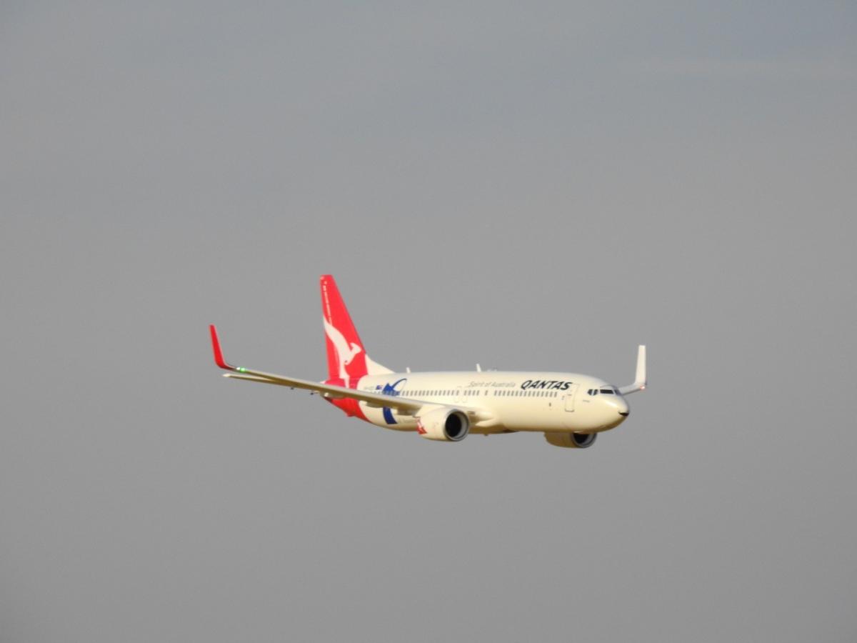

          Mounting an action camera at the base of one of the winglets is also a terrible idea if you like a plane which behaves consistently throughout its roll axis. Or, so i hear.
          But it does make for some great shots, as demonstrated by QF667 on short final into YPAD (notwithstanding bank angle far in excess of SOP).

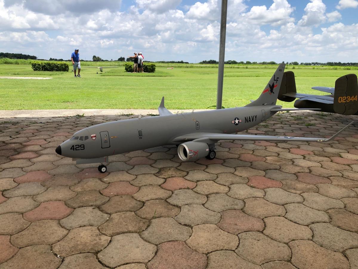

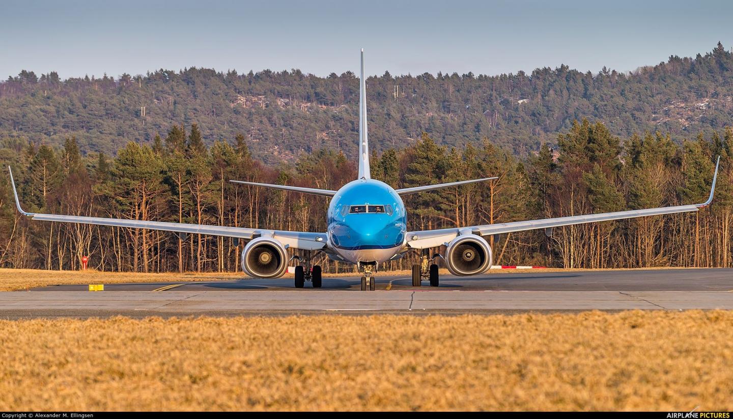

              I'm not finding a lot of photos of them but I am partial to the blended (not canted) winglets that have a significant curve at the base like the ones below. Most I see are more angular. Not sure what the aerodynamic difference would be however...

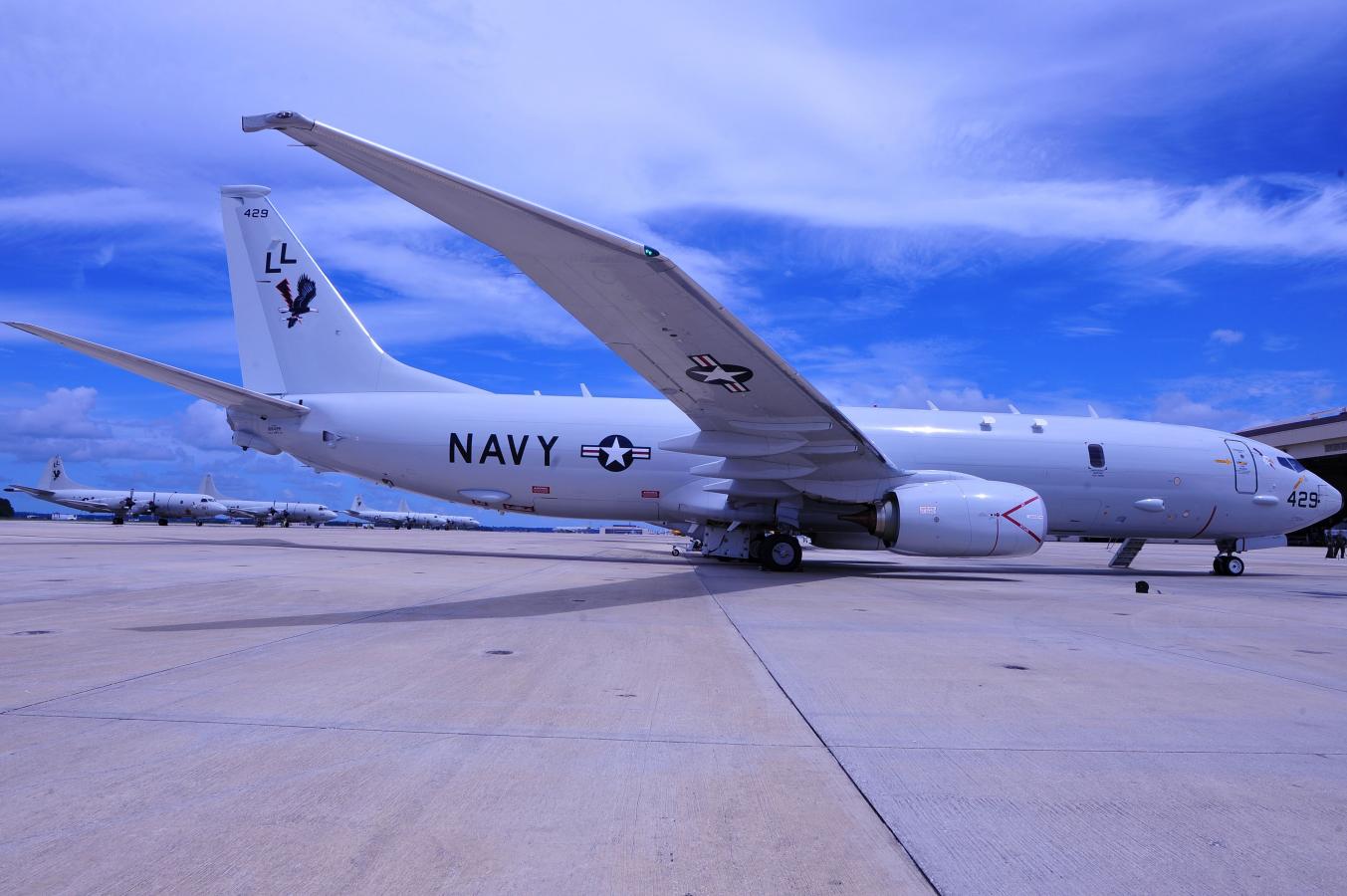

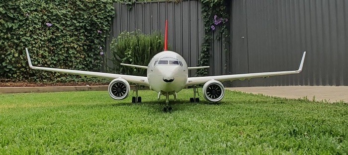

                Im biased but agree they look so much better. It's the backwards sweep that makes the radius of the blend look larger than it really is from certain angles.

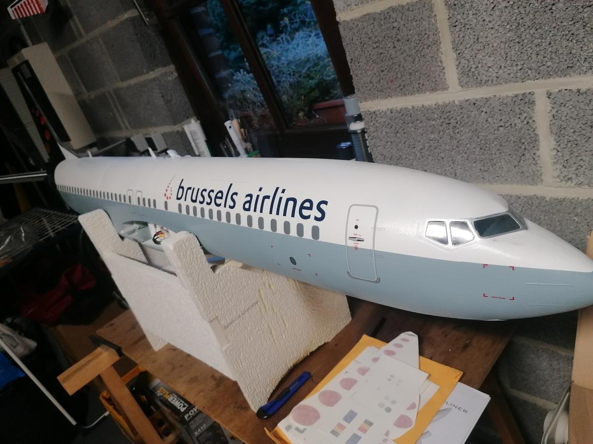

                        Hi
                        I'm Philippe from Belgium. I'm finishing a Brussels airlines livery and I'll post pictures in the appropriate section.
                        I'm experiencing troubles connecting the blue box on a Spektrum AR9030T receiver... It looks like channels are not linking properly when connecting ail to ail, rudder to rudder etc...
                        If someone flying her using a Spektrum rx/tx...could you please advise if any specific setup is required?

                          Im using a 9030 had no issues, I connected it as per instructions , Maybe is how your radio is set up?

                            There is nothing special about hooking this plane's leads to any receiver. If you have everything plugged into the blue box and then use the pre-connected leads from the blue box to the RX, it's very straight forward. The only thing I can think of that you may have done is to designate the incorrect aircraft type (wing type) in your TX. It should be "1 AIL, 1 flap, normal tail". If you are using the blue box as it came and you are telling the TX that you have 2 AIL and 2 ELE, it won't work.
                            If you are by-passing the blue box for the primary control surfaces, then it's still the same "wing type" but you must "Y" the 2 ailerons together and "Y" the 2 elevators together, so you have only one plug for each for the RX, unless you really want to have separate ELE and AIL channels.

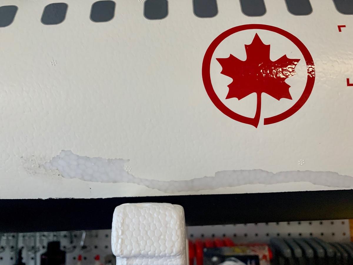

                                    Gents -
                                    I am almost done assembling my AL37 and I have a few questions.
                                    I used blue painters tape to mask the belly so I could paint it and when I removed the tape it took along some of the paint with it. What color can I use or buy to fix the damaged area?
                                    I also noticed the winglets don't fit flush with the ends of the wing? is this normal? They seem off even though I slid them on with pretty good force.
                                    Any insight is appreciated
