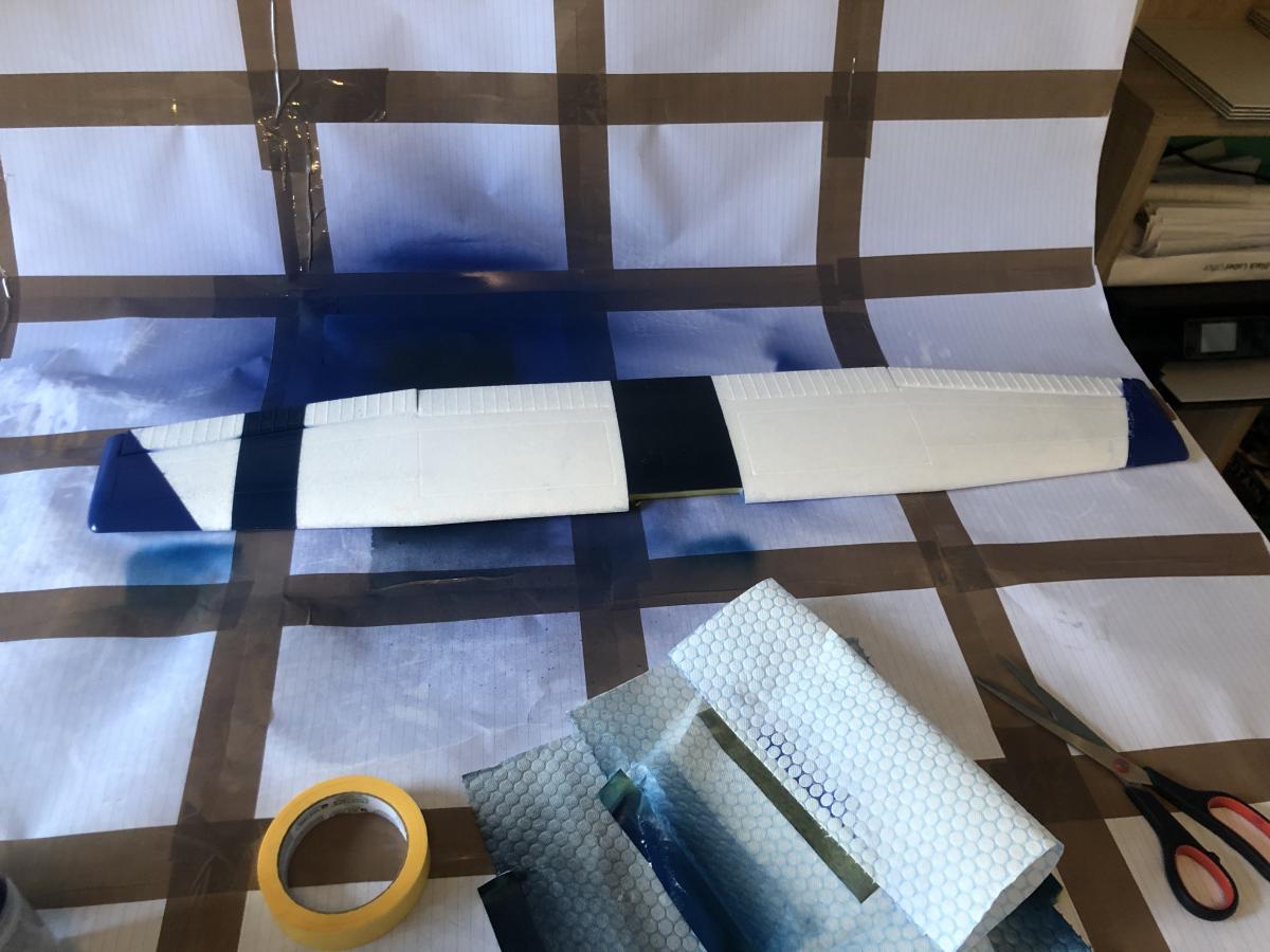

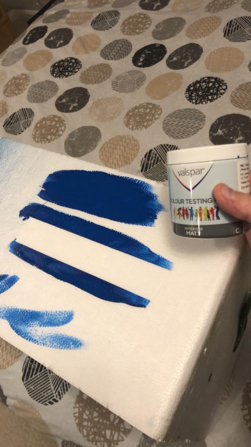

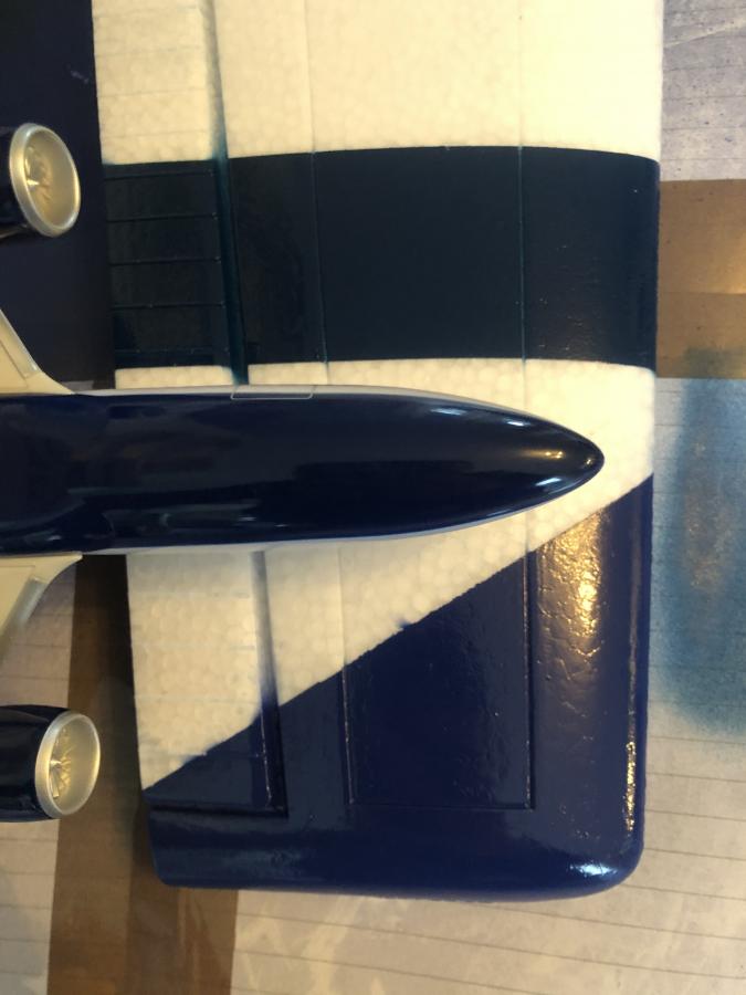

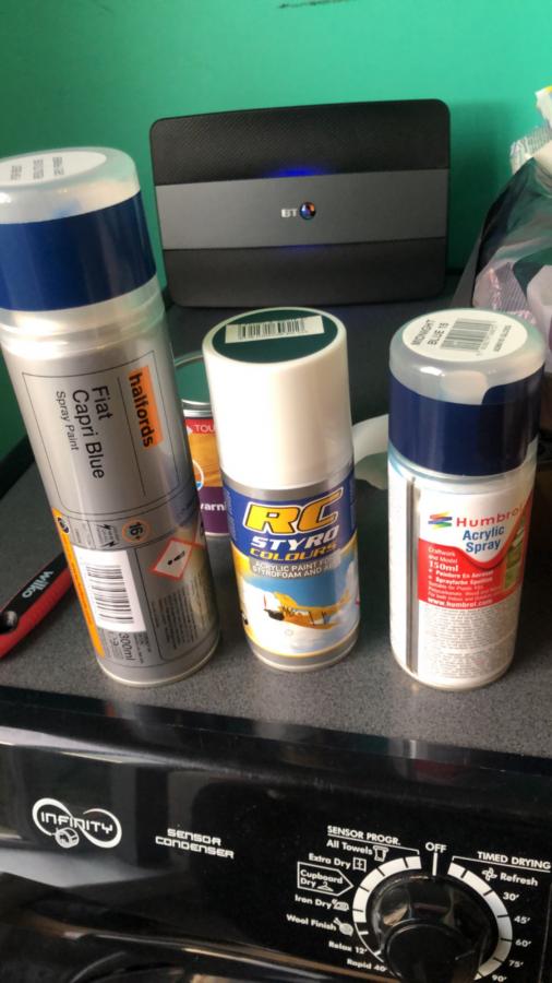

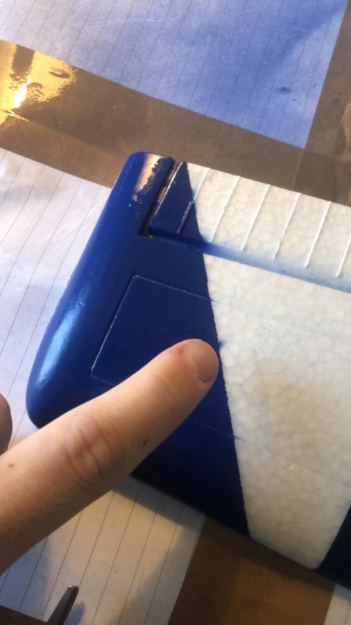

                          • Apriliamgt
                            • Oct 2017
                            • 73
                            #633
                            Originally posted by Styk
                            Thanks Apriliamgt So you don't think that there will be any issues with compatibility with the EPO foam then?? You planning on priming it before the top coat. Want to get this right as the last thing I want to see is the foam dissolving before my eyes lol
                            As you can see , I brought a test EPO wing I’ve been trying different various paints on.
                            all the paints I’ve used the epo has done well, just spray about 10”-12” away in a sweeping motion and not to close . I’ve found 2 coats with the Halfords blue goes well
                            also the stock AL37 has a base white paint already , so I’m not going to use a primer .
                            even the bare EPO has come up well

                                    #637
                                    *please ignore the other pictures * uploaded by accident* if the admin can delete the Iceland air pic and the Hobbyking screen grab. Thanks *
                                    Thanks a lot Apriliamgt for being so helpful and taking the time to answer my questions. Mine is coming on Monday and I've decided to do it out in a Thomas Cook livery. Just waiting on the Decals from Callie

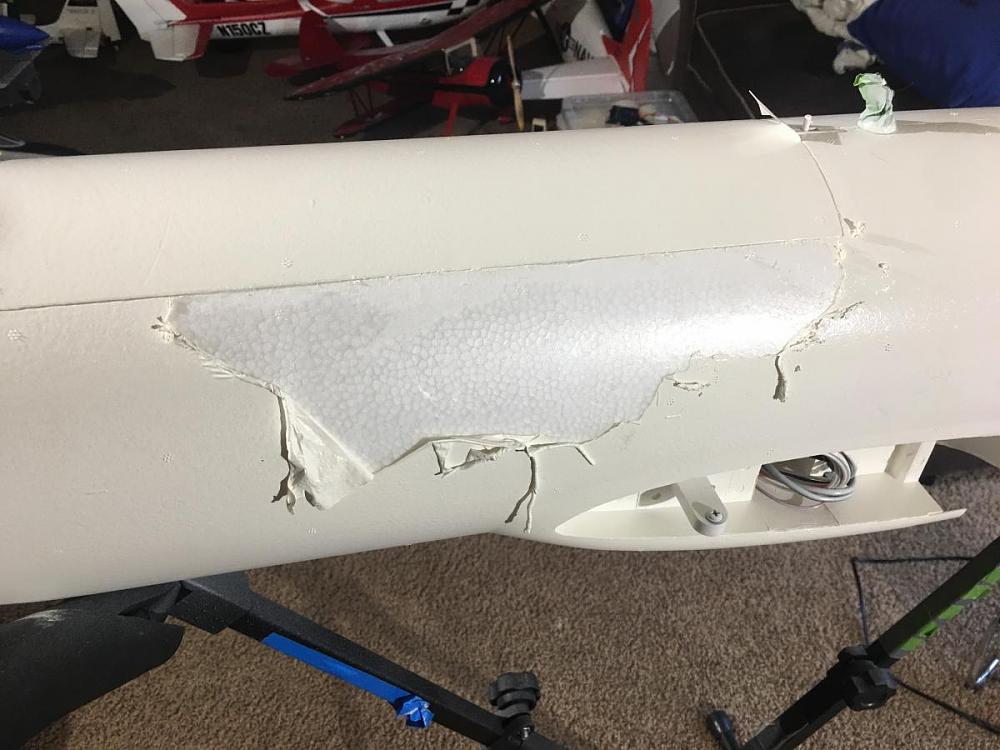

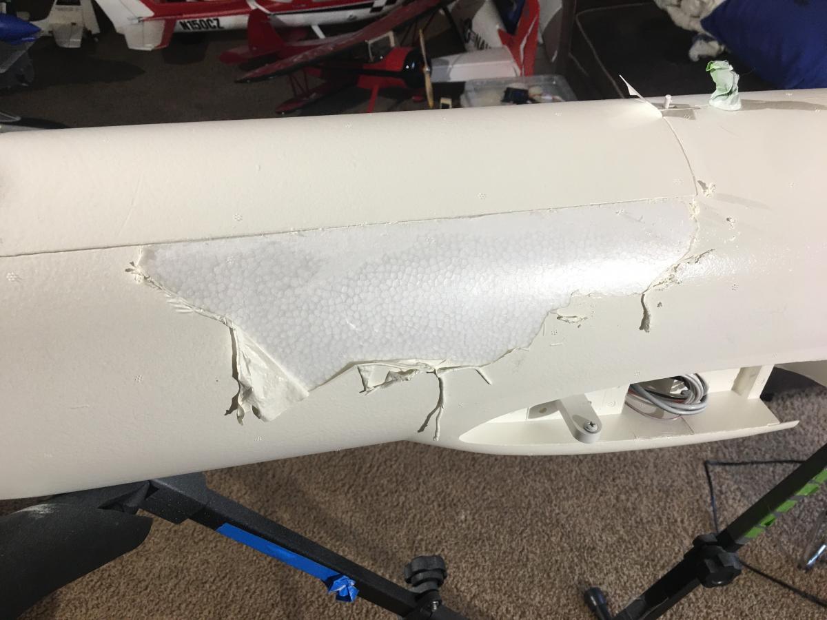

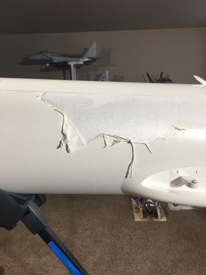

                                        • Jetman64
                                          • Jun 2017
                                          • 113
                                          #640
ID:	222822Click image for larger version
ID:	222821 Here’s something different. Anyone having this problem with their plane, the paint is bubbling up and peeling right offf.
