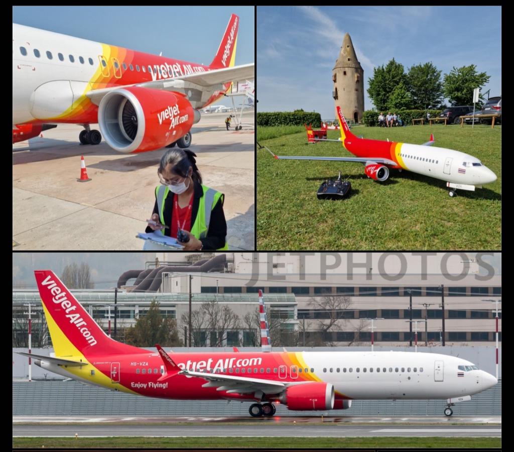

                maiden flight went well
                setup NX8 w/ar10360T+, HRB 6Ah for 5min flight time, battery back with separate wood tray as in previous posts, 110A max, reverse on moment switch w/90% throttle
                she requires 100% elevator for lifting front wheel with full flaps at landing Click image for larger version
                still need remaining decals and windows
                ready for Oppingen airliner meeting
                pic show also my original maxx from BKK to CNX

                  I agree needs Lotsa elevator. To get off grass.. think I have around 120 percent
