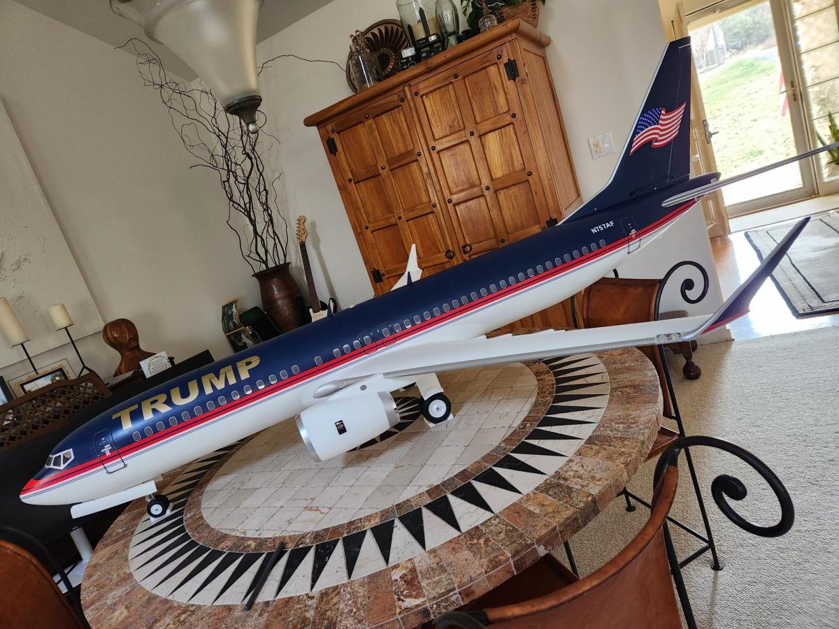

              Click image for larger version  Name:	20260301_154127_resized.jpg Views:	0 Size:	195.0 KB ID:	445008 Winter build ready to maiden, cg on lines, . Is it really a good # to have +- 28mm throw on ele ?? Seems like allot. Just waiting for weather and ground crew THANKS to Callie, great as always, a few touches to make he closer to the original plane, happy with this one for sure.
                FJ,
                Best of luck on your 1st check flight.
                She's a beauty.
                LB

                  Reckon U need all elev U can get . Very small surfaces. No expo on ailerons. No mix 4 flaps. Rudder mix if U r like me .. not mr rudder. 10 percent throttle on landing. U good to go. Almost fgot. Looks awesome 😎
