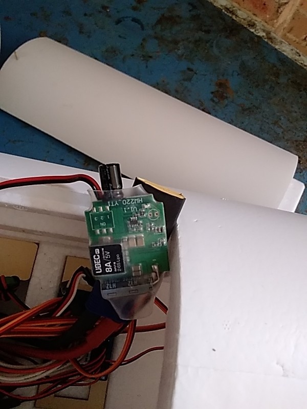

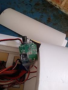

    LOOKING FOR SOME HELP TEAM FIRST PLANE 4 ME WITH THROTTE AND UBEC WIRE.. SO THROTTLE IS INTO RECEIVER AND UBEC INTO BLUEBOX,, NOT SURE IF THATS CORRECT Click image for larger version

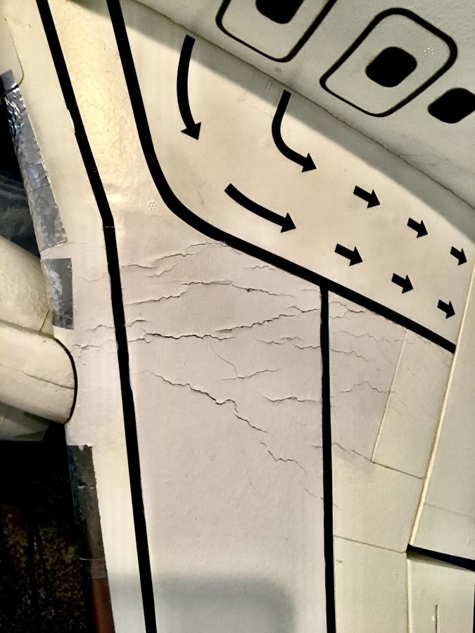

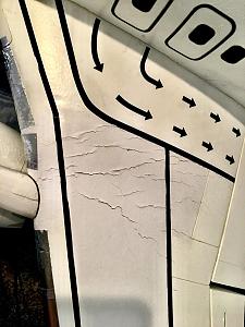

              One more thing….
              6) Install RF chokes. Remove the battery tray to do this. You can put them on both ends of the ESCs, but the forward end is more important.
              If you plan on flying her a lot, wing skin cracking is minimized by epoxying in 1/4 inch carbon square rods into the wing channels. Remove the nacelles and invert the wing and epoxy a long rod to the top skin inside the wiring channel. You’ll have to hold it while it cures.
              Elect not to do this, and you will get top skin foam cell boundary cracks eventually.
              -GG
