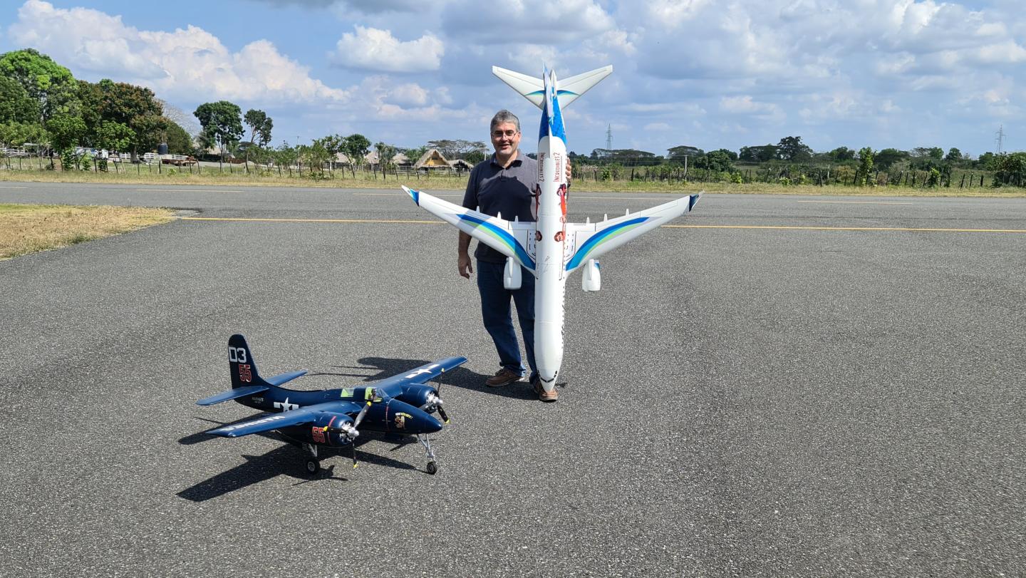

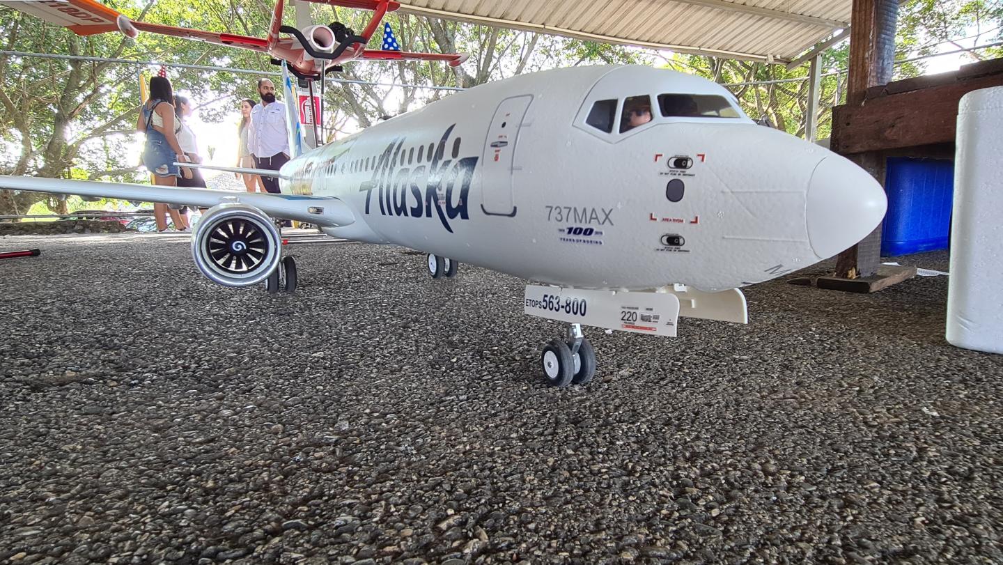

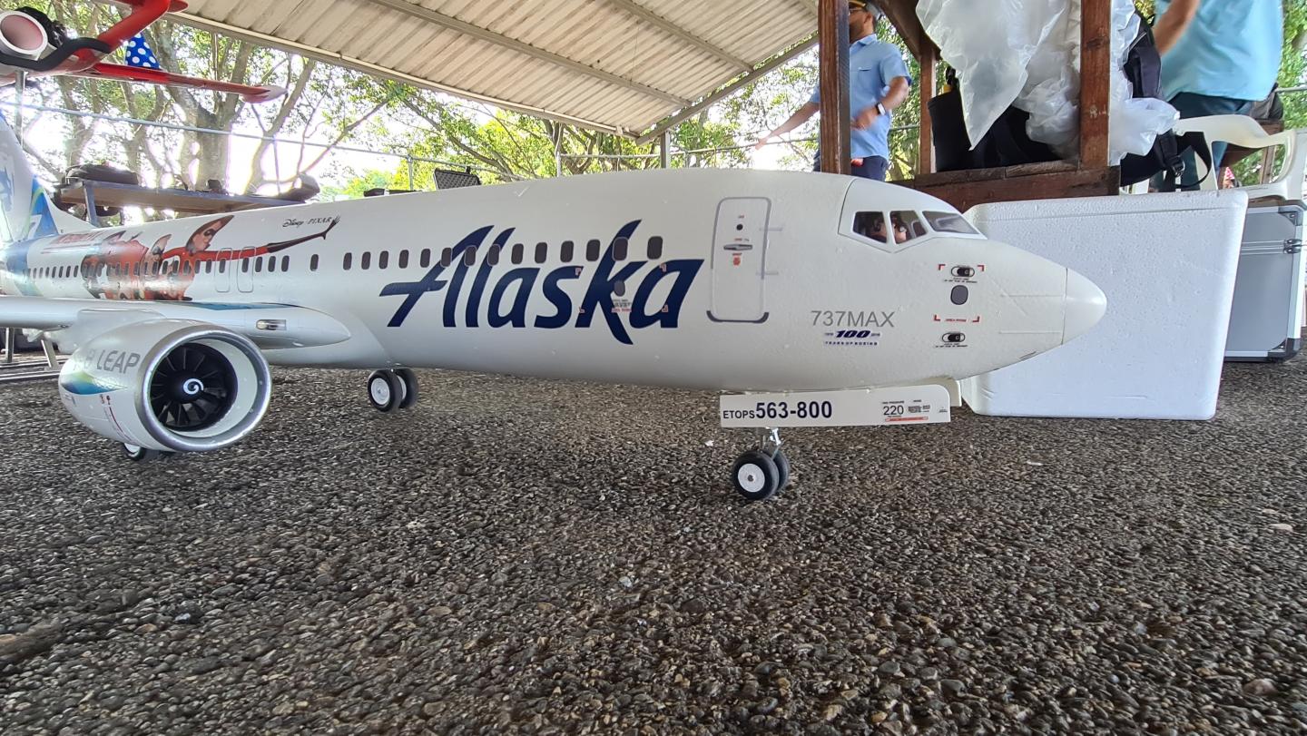

                      • Hello to all again. Today was the Maiden of the Al-37 and it flew great !!!! Photos attached. Click image for larger version
ID:	336100Click image for larger version
ID:	336099Click image for larger version
ID:	336098Click image for larger version
ID:	336097Click image for larger version

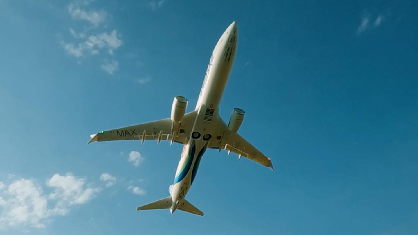

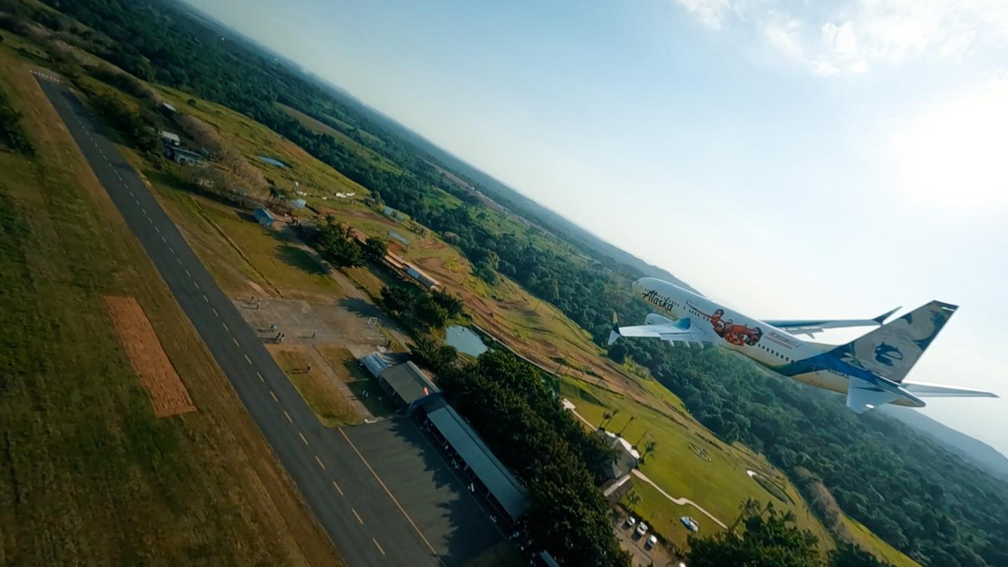

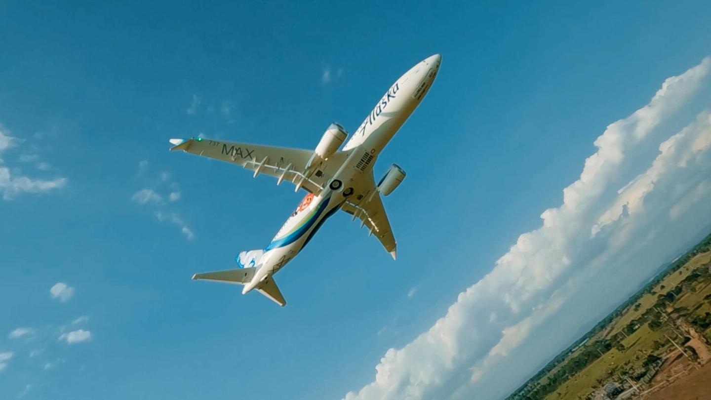

                        • Here are some photos extracted from the maiden flight using a drone as a chasing camera.
                          Also you can see the video from this link: https://youtu.be/fac5T2A1mJs
