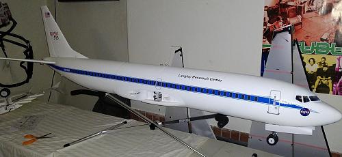

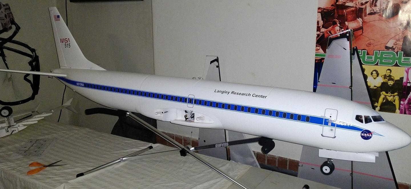

    Almost done getting the graphics on.

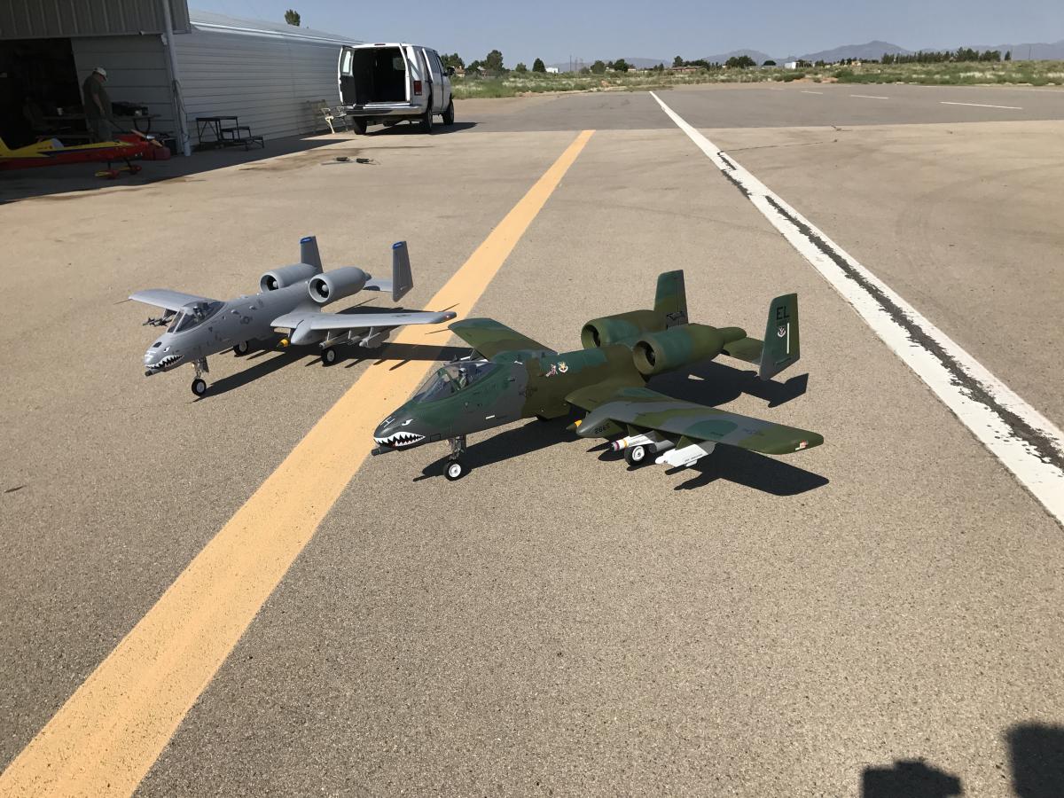

                    I used it on all my motion stuff with no prep short of wiping the model down to be sure there was no oil from my shin on it.. I haven't top coated any
                    of my stuff.

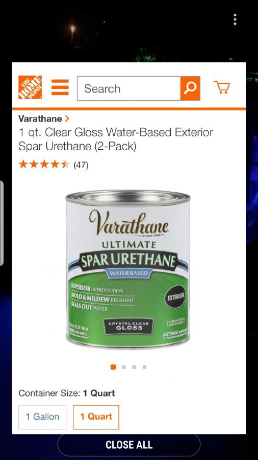

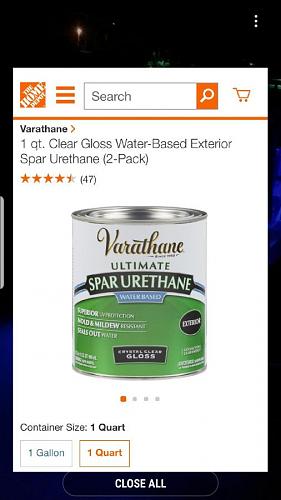

                          With you 406PIlot . If I'm doing a full repaint, usually first put a coat or 2 of the Varathane Spar Urethane, clear gloss exterior water base (available in hand paint cans or spray from HD or on Amazon) just to keep the factory base in place, then cover with the spray Rustoleum 2x white primer. Then I can mask any area with a "delicate" tape or tamiya trim tape without peeling the base paint off. Then use the same type spray Rustoleum for the colors you choose. Most of the time (always) I also end up doing some final trims or even larger sections with the testors enamel, hand painted. Then apply graphics and then another 3 to 4 coats of the Clear Gloss exterior Spar Urethane (must be exterior as the interior will eventually yellow from the sun). I do that final clear coat on all my foam aircraft, mostly for protection as it gives it a nice "shell" which resists paint chipping and even finger denting. It comes in gloss, semi-gloss, satin or matte so chose your final finish to your liking. I happen to use gloss on all mine as I like the way it gives a nice sheen in the sun. I did the first 15 or so foamies by hand painting the clear coat on with a sponge brush, but recently am using the spray on, which gives a smoother even finish. Just needs a lot more prep as you don't want that clear coat on a lot of areas (aileron hinges, servos, etc.) as after it dries, it's like a glue, so these need to be masked. Remove all hardware first, but then you've had to do that anyway for the repaint. Others use the MinWax, which I think is about the same, just started using the Spar Urethane at the beginning so I've stuck with it, no complaints. Just make sure it is the exterior and water based, as it also comes in an oil base.
                          This is the Hand Paint version, spray version looks similar and just ordered another 8 cans of that from Amazon (the HD store never has the correct one in stock so you need to get it online-perfect for me, I can sit in my Lazy Boy, smoke a Cuban and sip on a bottle of Jack and they drop it off at my door): :pop

                            Awesome, I feel like this is pretty much all the info I need, and glad to hear I can probably find some more accessible paints that won't be sold out.
                            I was honestly a bit concerned using something like testors enamel outdoors given the UV and general wear-and-tear, feel like with your recommendations of the rustoleum it'll tend to hold up a lot better. May head to home depot later to see what they got! Appreciate the help, guys.

                              I sometimes find that the exact Rustoleum 2X I want, HD doesn't stock. So look for any specific colors/finish on line and you can always order it. Common colors yes, usually in stock. For my F-18 Canadian, I used an unusual red main shade something called Strawberry Fields in gloss (as the red was too red), something no HD store stocks. Then the darker shade of red was some other weird color. Ordered everything on line. Also, as I said, the Urethane spray or paint, they never stock the exterior, so that's ordered on line as well. For testors enamel paint, a couple sources, including HH, scale Hobbyist and others. I've probably amassed about 600 bottles of the testors enamels in maybe 100 colors/finishes. Yes, I'm a bit out there, but like to have some options (man, an air brush system would be so much easier, but I'm a caveman). Happy Painting.
                              But don't worry about using testors enamel hand paint outdoors. I have some on many aircraft and it gives a very hard shell finish, always stays glossy and never changes color. I do coat over it on the final coat with urethane, but even before I did that, absolutely not trouble. It will take the sun/heat and never change. The urethane, on the other hand, covered over the stock foam and factory paint, if left in the hot sun too long will actually cause the underlying foam to gator a bit more, but leaving a foam plane in the sun for extended periods is never a good idea.

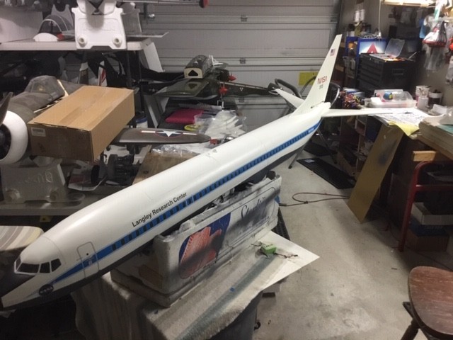

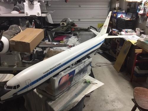

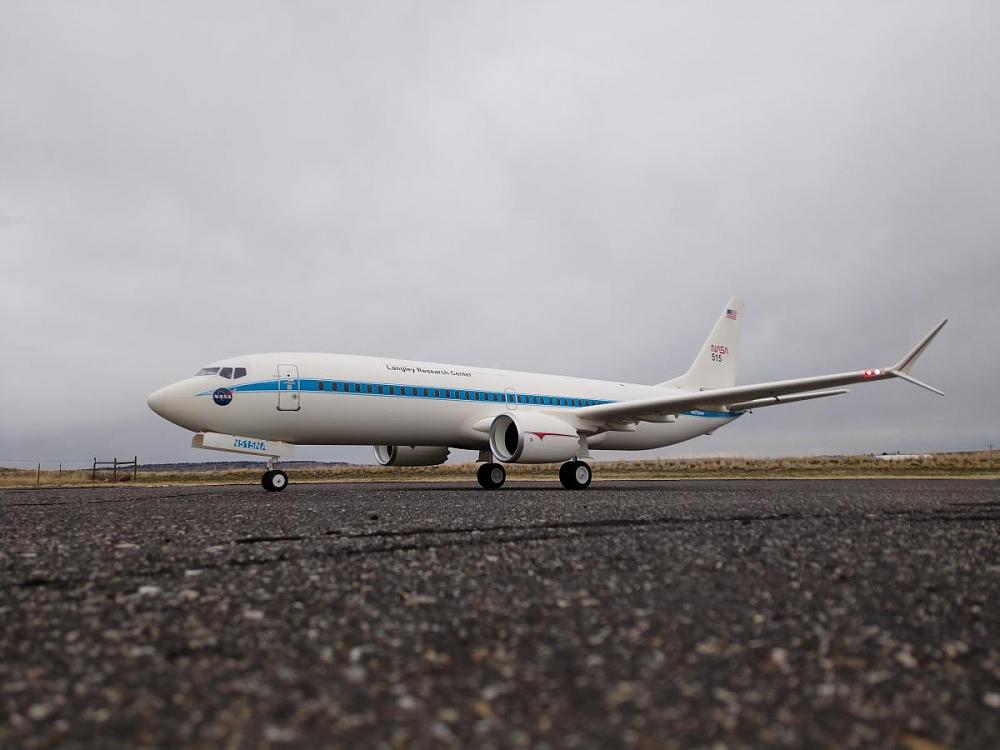

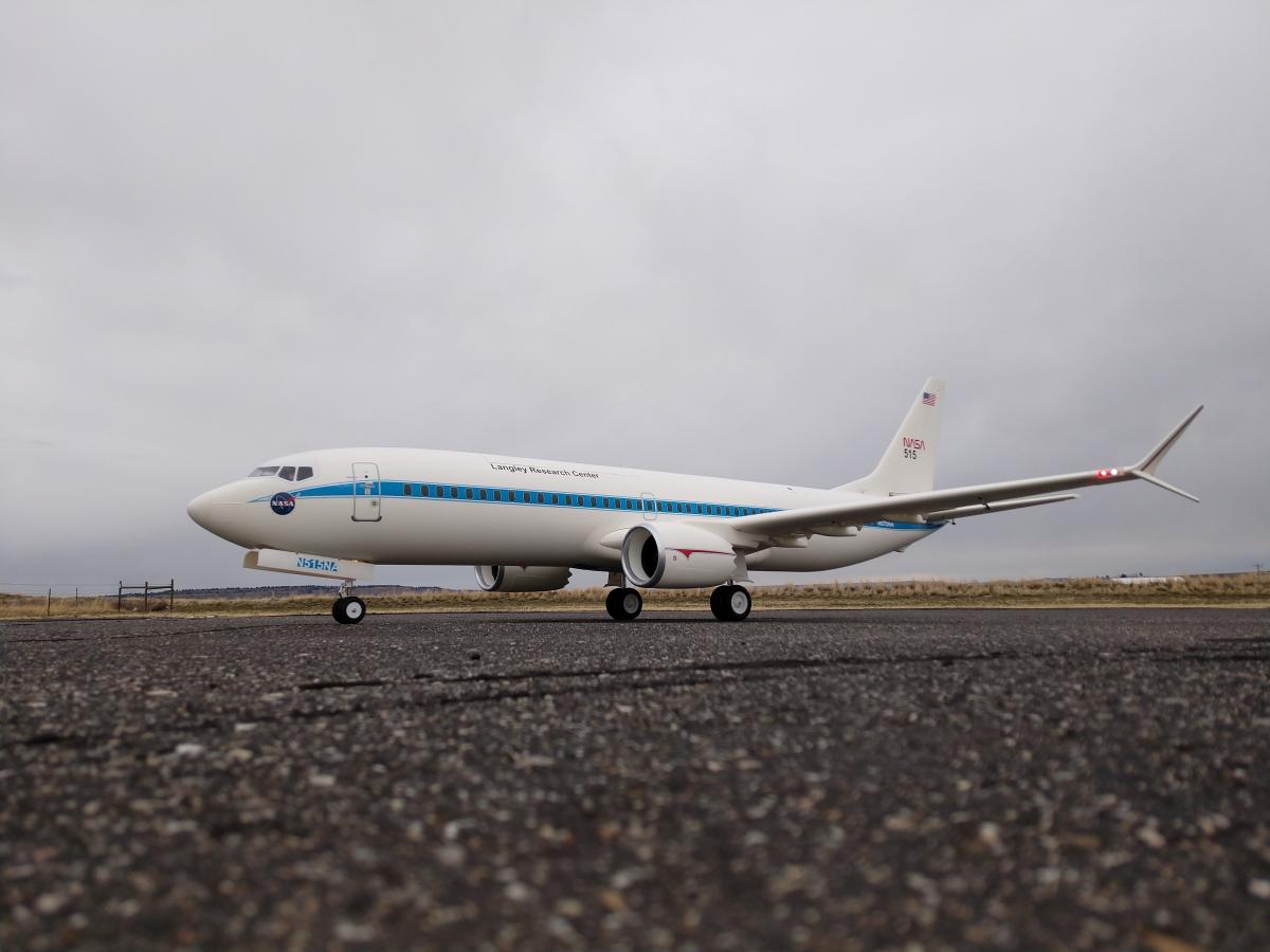

                                  First flight after getting all the Callie Graphics on it.

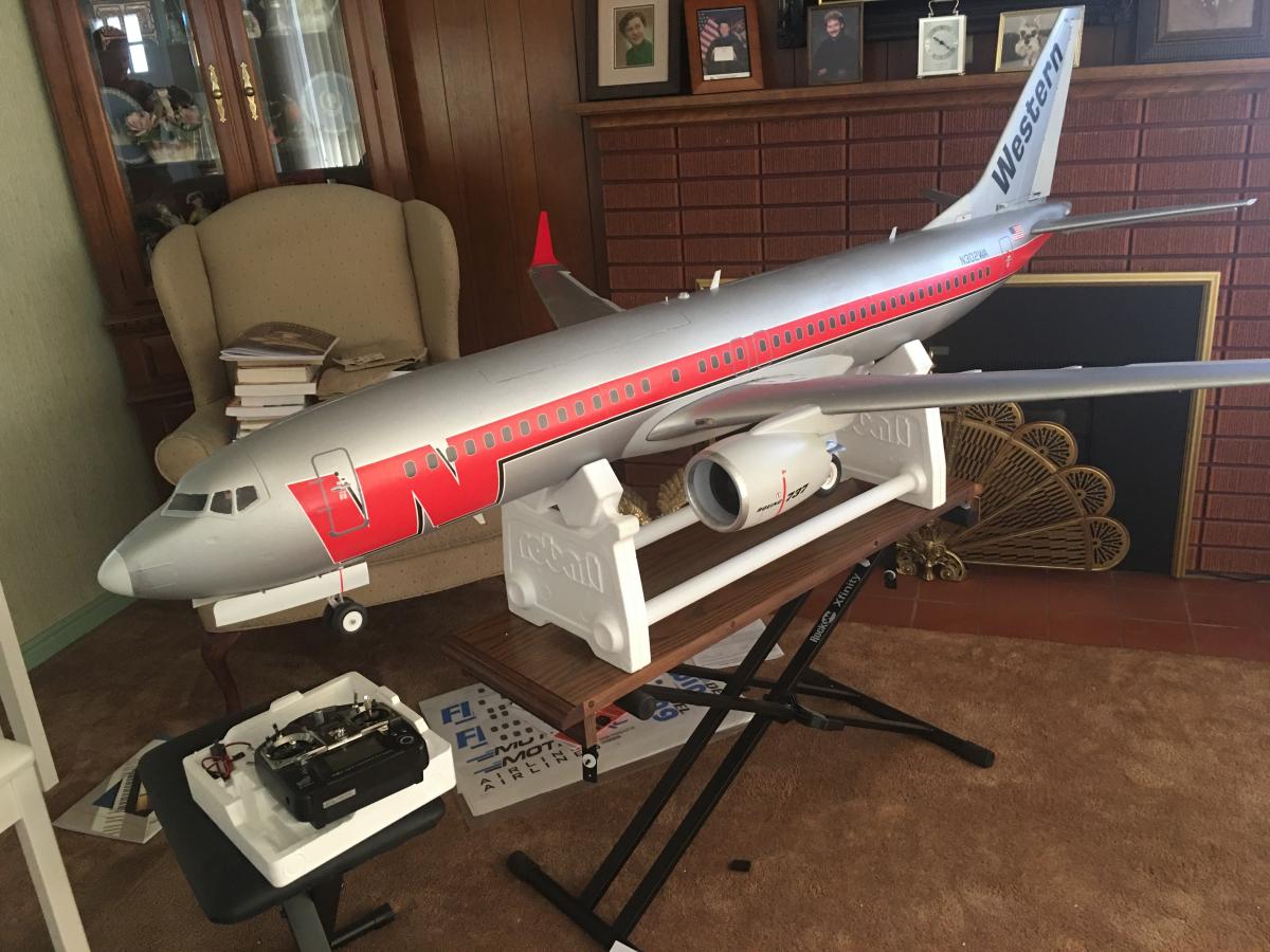

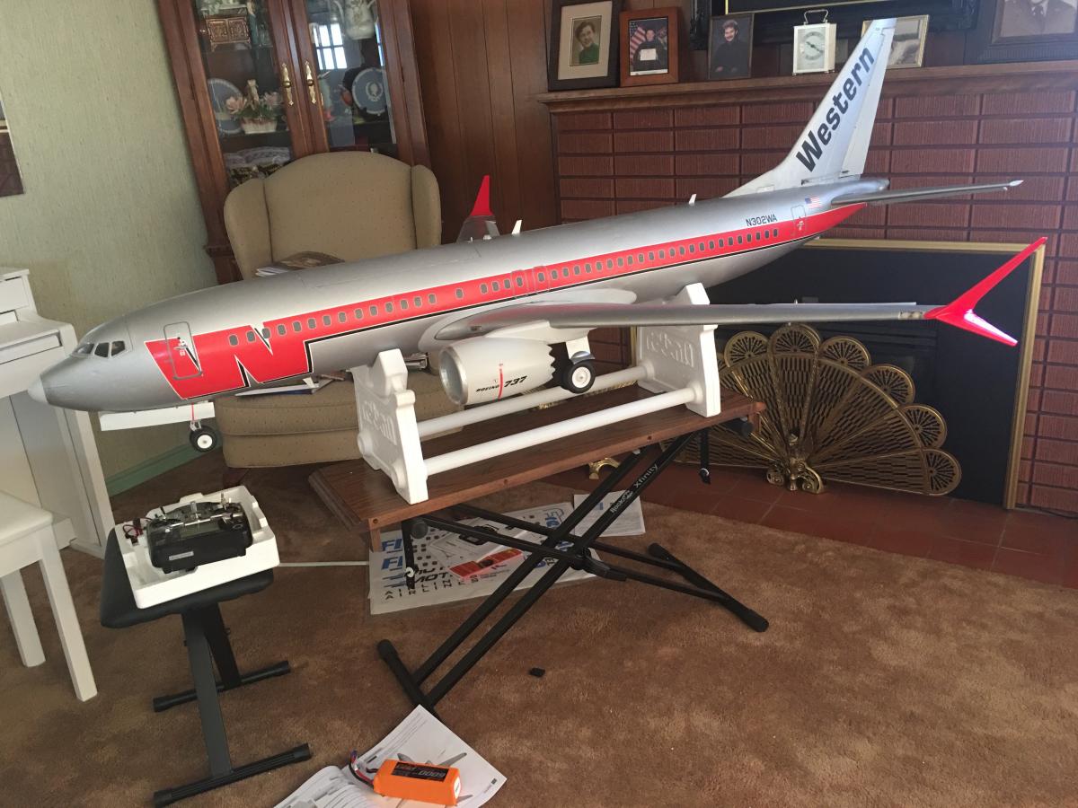

                                    Thought I’d try a Western Airlines Bud-Lite scheme.
