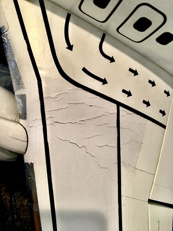

          Rogerio "Noted GG, and thanks." / (Reference my prior post #1893...adding weight to the fuselage will also likely accelerate the foam cell boundary cracking I experienced on the wing's topside after many, many flights due to the added stress on the wing caused by the added weight.)
          Adding / FedEx notification just received for a "today" delivery of my new AL37. Woo Hoo! I'm going to attempt to engineer some internal bracing to the topside skin area of the wing that has been shown (on my bird #1) to be prone to foam cell boundary cracking (due to flexing) . Or...I may decide to add a layer of glass externally to the topside of the wing. But, I'd rather not get into a sanding/repainting job on the wing, if possible.
          We'll see how it goes. I'm not overly concerned about the wing structure (with the cracks), but it is not pretty...and everyone comments about the cracks when they see them. UGH. I want to avoid having the cracks re-appear on the new bird. The strength is in the carbon rod...not the skin.
          Here is an ENHANCED CONTRAST photo of the cracks on Bird #1....after 1000+ flights / normal and aerobatic flying (I didn't quite match the original paint when I attempted to fix these the first time they showed up). Note: There are no cracks on the bottom wing skins. Raised bump/nature of the areas around the cracks indicate compressive stress in the skin likely resulting from loops and recovery from spins.
          Again, Bird #1 is being retired. :disappointed:

            Update to Post #1904....
            New bird is ready to go! Hope to maiden Bird #2 this afternoon, if the winds cooperate.
            I was able to add a span-wise reinforcing carbon rod stringer in the wiring channel in the area which was found to fatigue crack in Bird #1. Remains to be seen if this is successful.
            -GG
            Update - Maiden was a success! Needed about 3 clicks of up trim is all. Flies GREAT!

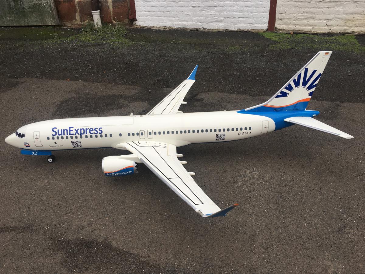

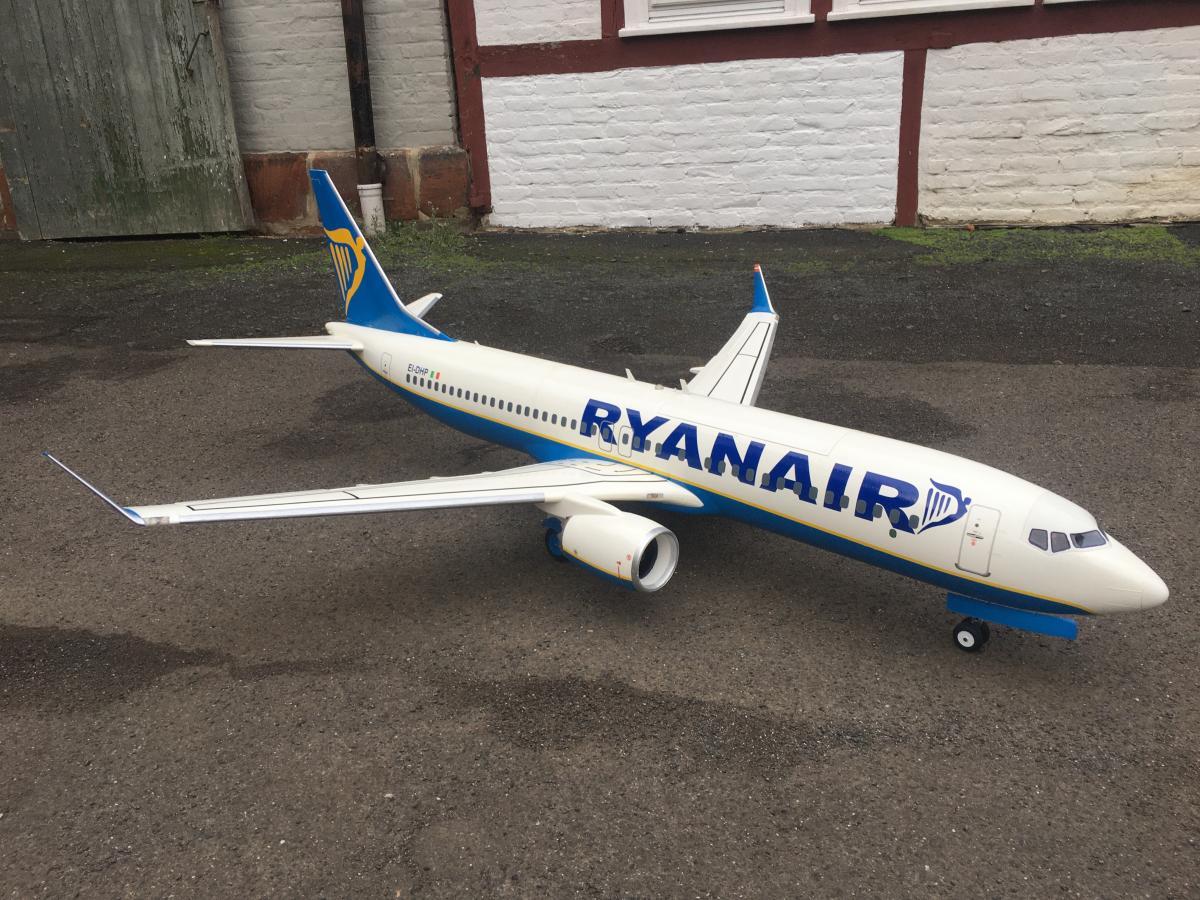

              Hello at all from Germany
              I'm now also a AL37 owner. Bought it in white and designed it with the help of callie in two airlines.
              The right side Ryanair and the left side SunExpress.
              The reason is, our son took the Ryanair EI-DHP factory new by Boeing in Seatlle and with the SunExpress D-ASXD he was the first to be allowed to use the callsign sunrise .

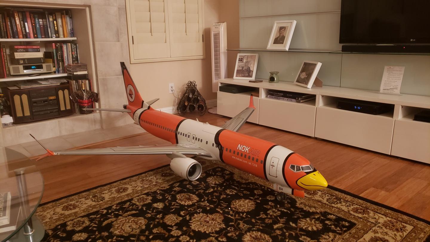

                Nok Air Thailand low cost carrier. Nok Cartoon Livery. Maiden soon. Click image for larger version

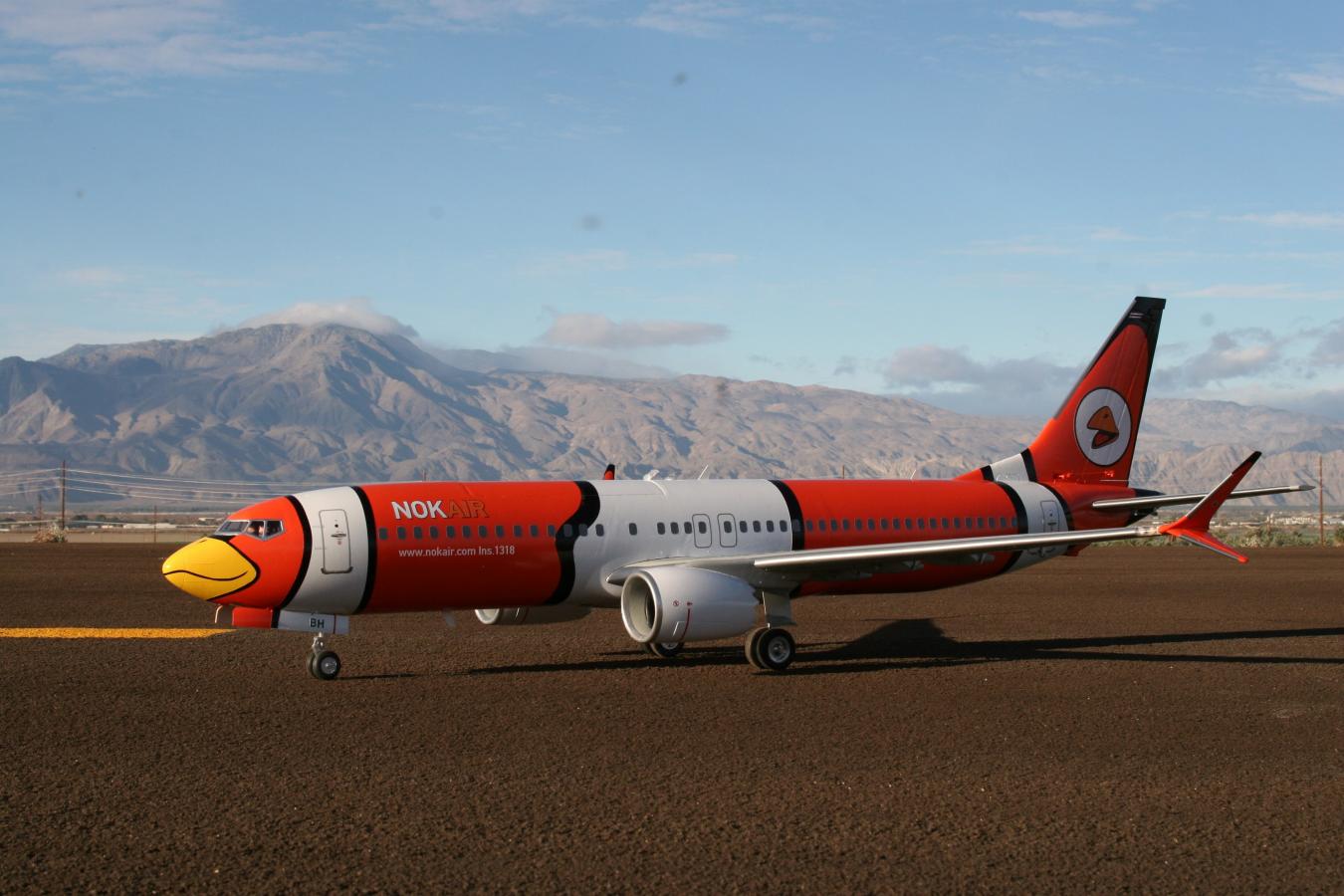

                                    Nok Air maidened today. Uneventful. Consistent performer of all the variant livery (TWA, Frozen Jet, Thai Airways, Nok Air).
