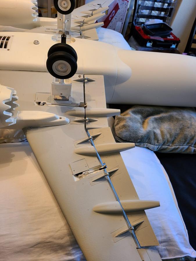

    Hey, you know, I really like the really great "fake fowler" hinges that the AS37 flaps use. I could use those on another project - so I went checking under the "spare parts" page and found the Motion doesn't sell the hinges in any of the plastic part sets.
    I has a sad. :disappointed_reliev :pleading_face:
    And its kind of aggravating as well. I would prefer to buy them from Motion. Would any of you know of anything similar that I can find, or perhaps 3D print? Any of you care to create a 3D-print STL file for these? Looks like no one on Thingiverse has bothered making anything similar yet, but perhaps there's something similar hiding in a different place.
    You can get those on Ali Express, Banggood, Amazon, Hobby King,... they are all from China, including the Motion RC one ;)

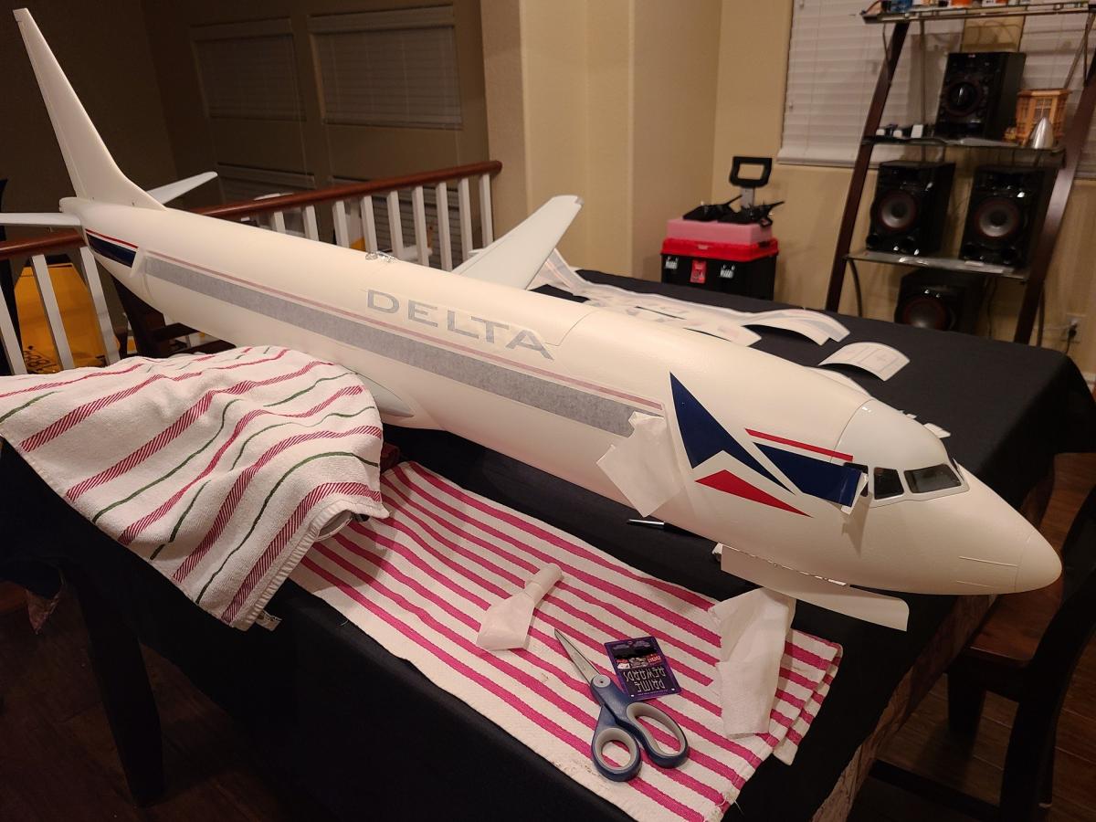

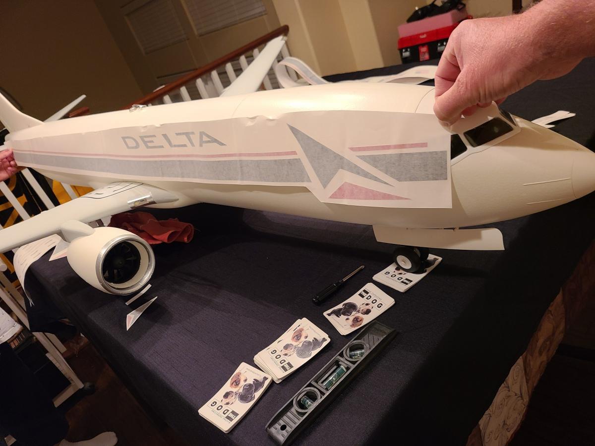

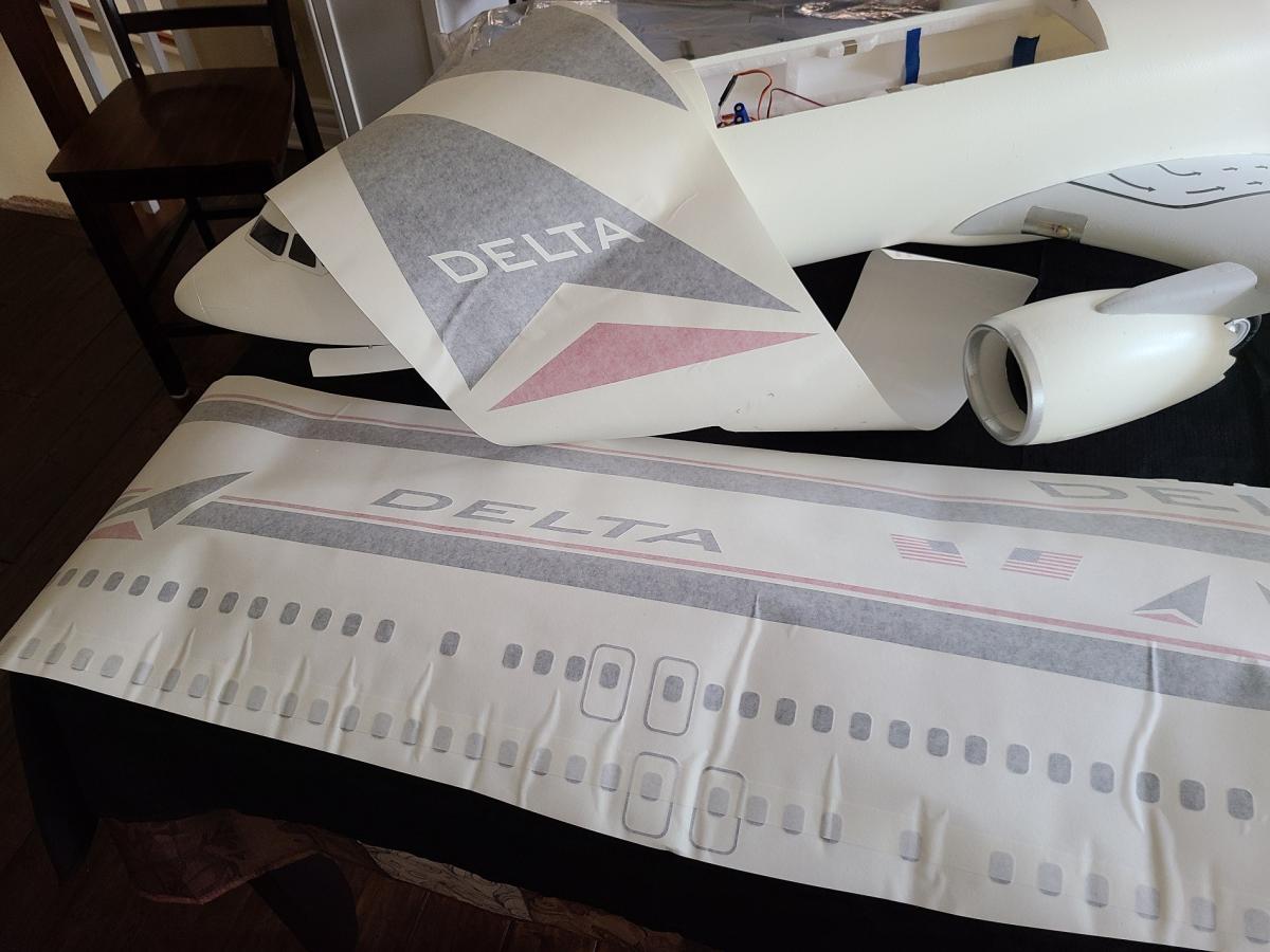

                            Here are some pics of the process.
                            It was as this point after applying the right side decals, and knowing I still had to do the left side and vertical stab, that I wanted to jump off my balcony...
                            I use a small squirt bottle with water and few drops of dawn dish washing soap mixed in to spray the sticky side of the decal so you can float the decals into position and the use a plastic card to squeegee out the water from under the decal.
                            Don't rush removing the decal application paper as it take s a while to dry so you can remove the backing easily and don't lift the decal from the surface.
                            Also is a photo of the paint I had matched at Home Depot- scanned the blue on the decal.
                            I gave Callie the RGB values for Delta Blue and she matched the color perfectly. The paint match was close but we had to add a bit more black to match the decal.
                            I think this is as close as we can get to a match.
