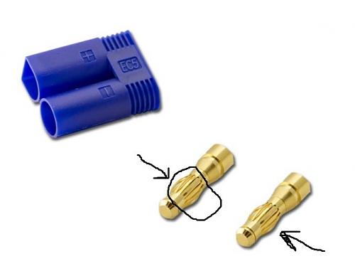

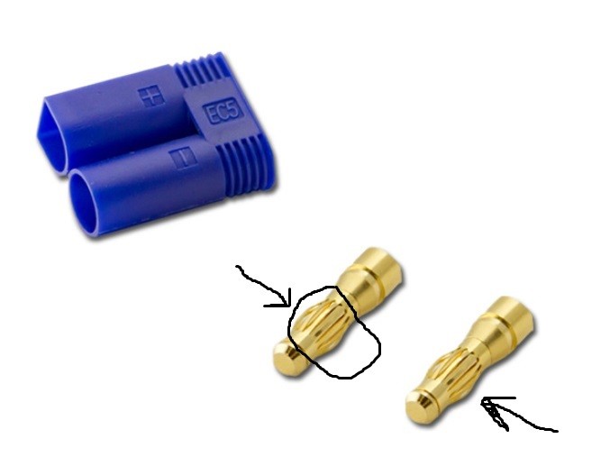

    I noticed the EC5 on the AL37 was hot after a recent flight. Investigation showed severe degradation of the fluting on the male barrel connector (tons of flights on this bird).
    I have installed a new EC5 of the split barrel flower pedal type. She runs cool, now.
    My question is related to the different designs of the male EC5 barrel connectors...
    It appears the split barrel / flower pedal type is a more robust design...that is to say, more resistant to the spark damage that results at the instant the power plugs are mated.
    Is this a correct observation? Comments? I am aware that there are sparkless connectors...and I may move to that type of a connector. But for now, I have installed a new split barrel/flower petal type connector.
    See photos below. Thanks....
    Note: This is not a system problem...this connector has been mated/un-mated about 1000 times. Plenty of action, so to speak, and limited life is expected.
    -G.G.

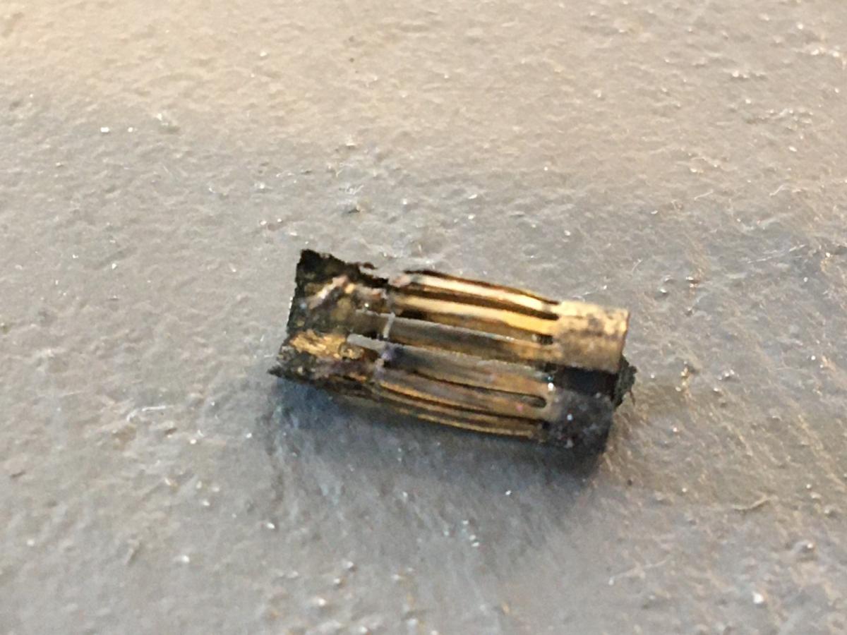

    Photo #1 Area where connection sparks degraded the metal.
    Click image for larger version  Name:	IMG_3556.jpg Views:	0 Size:	29.0 KB ID:	272720
    Photo #2 Close-up of the degraded metal fluting pointed out in Photo #1
    You can see the end on the left is where the spark occurs during connection.
    The metal is totally eaten away by the spark.
    Click image for larger version  Name:	IMG_3555.JPG Views:	0 Size:	107.0 KB ID:	272721

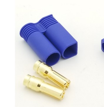

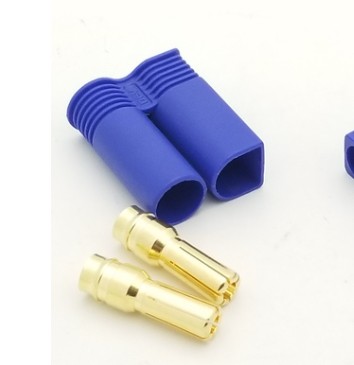

    Photo #3 Newly purchased split barrel / flower petal type. More robust than the above? Seems to be....
    Click image for larger version  Name:	IMG_3557.jpg Views:	0 Size:	16.0 KB ID:	272722
    Comments are appreciated.

      I use those connectors on almost all my planes/packs. That damage is on the battery end is it not? Maybe the battery manufacturer used a cheap version of those plugs?

        Thanks - This is the airplane end....Male plug. The battery end is the female. No issues with the battery side.

          That connector probably had a cold solder joint to the wire, it wasn't making a completely perfect electrical connection and perhaps it was arcing a little bit each time you plugged it in. My opinion. Good thing you caught it and replaced it!

                GliderGuy, wow! I have never seen that type of pin damage in normal operation of any plug. That is indicative of sever arcing, most likely sustained during use as well. looks like the area at the solder joint was also damaged, this only could be either a cold joint, or if the wires were breaking at the solder joint. Either way, that is not normal wear at all.

                  Thanks S.F. Yep, This sure made the connector body get hot due to the high resistance. I’m gonna do more frequent connector inspections, for sure. Since installing the new, and new type=split barrel male, connector, she’s cool to the touch after a flight.
                  A good idea for everyone.
