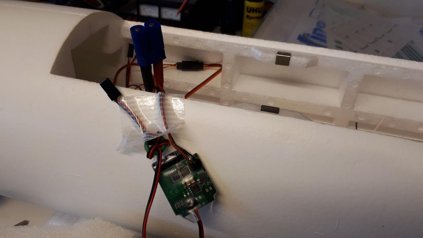

            #1605
            I am just close to final assembling of my Freewing B737
            Inside there is a pcb having a cable with a 3 lines futava connector.
            I could not find any instruction for the use in the manual.
            Could this for addition small LIPO for the power support if the main battery will be on low power ??
            Would appreciate your help.
            regards Roger
              • 8749
              #1606
              regards Roger
              No, it's not. This plane doesn't need such a thing nor was it designed to have one. I can't understand what you mean by "3 lines futava connector". Got a picture?

                #1607
                Thanks for fast replay.
                This pcb have 2 wire +/- with JR connect on one side.
                There is an other wires which to the blue 6mm connectors to the controller.

                  • 8749
                  #1608
                  I have attached picture here.Click image for larger version  Name:	Freewing-PCB.jpg Views:	0 Size:	69.2 KB ID:	265204
                  That 2-wire lead (wound around that green ferrite ring) is coming from the external BEC (not what I call "pcb"). It gets plugged into any empty port on your receiver or you can "Y" it to any port. It supplies power to your RX. The other lead that is connected to that big blue plug (EC5 connector) is how the BEC gets the power to give to the RX. The EC5 is the connection to your flight battery.

                    #1609
                    Thanks a lot.
                    Now I have understand it.
                    For my servo connection tests and adjustments I used a5 cell Envelope battery. I didn't want to connect the 6s 5000 just for testing. Therefore i did forget that I need power to receiver if not using a seperate battery as we did sometimes on the beginning
                    of electro impeller models.
                    Now its clear the JR connector must be plugged into the receiver to get power from the 6s LIPO.
                    Thanks again Roger

                        #1611
                        The BEC, use to be called a"Voltage Regulator" connect any battery, 5 cell nicad or greater, and it would regulate the voltage to either 5, or 6 volts. Hence battery eliminator circuit. I still use them in my electric planes, and power them with a 5 cell Nickel metal hydride battery. I never use the main motor power battery. Always seem to have bad luck with them off the 6 cell lipos....They also were used extensively for ignition motors, with the appropriate regulated voltage.....

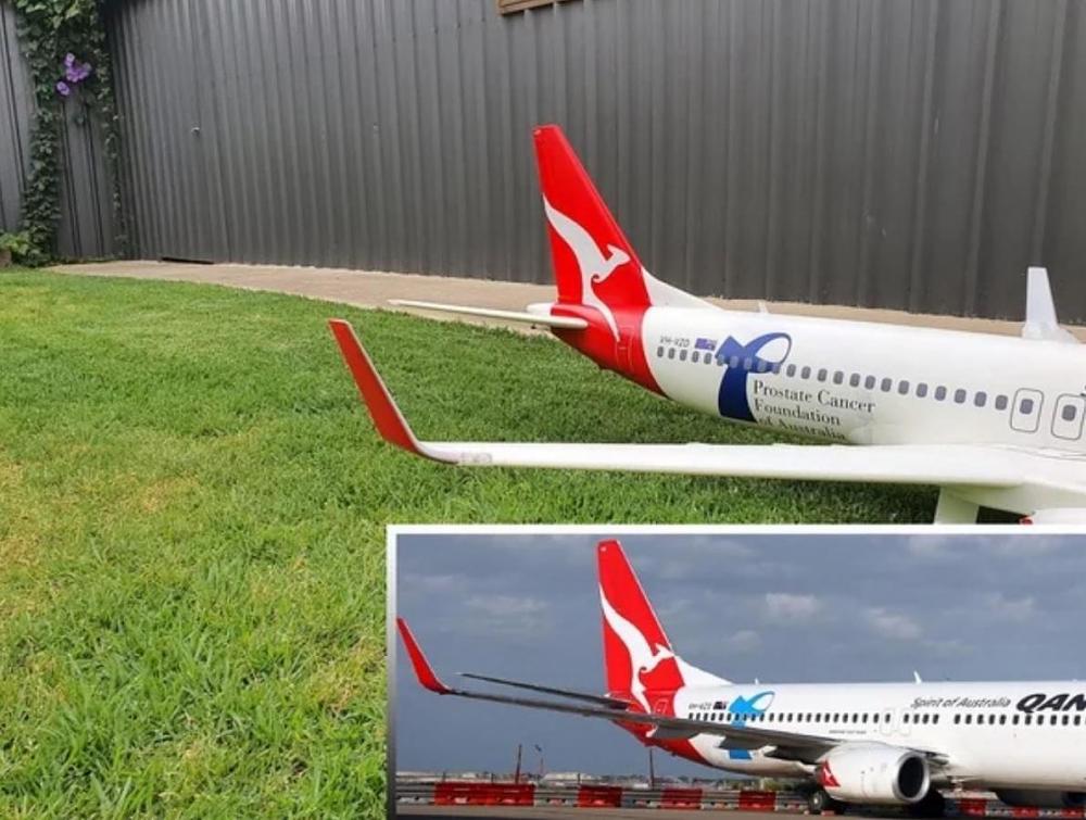

                            • autotecart
                              • 12
                              #1614
                              Can anyone point me in the direction of where I can get updated winglets for this model. The ones that curve upwards instead of having a step in them like they have now

                                  • 8749
                                  #1616
                                  Originally posted by Slowflight
                                  Take those and cut the down part, I did sanded it primed it and painted it. I dont think there is one available, or some one can print one for you.
                                  There isn't one "available". It all started when someone like yourself just cut the bottom winglet off and did the finishing work himself.
                                    • 8205
                                    #1617
                                    autotecart someone in this thread a ways back pointed me to this link since I want the same winglets when I do finally get mine...
                                    https://www.thingiverse.com/thing:4059280

                                      #1618
                                      [URL="https://www.thingiverse.com/thing:4059280"]https://www.thingiverse.com/thing:4059280
                                      Dear Aros, that is very cool! Let me ask, since I am sure you might know, do these winglets have any affect on the aerodynamics, do they affect the way this model performs?
                                      There's certainly nothing wrong with them if they just look fantastic, but I was just wondering.

                                        #1619
                                        I designed those NG winglets on thingiverse (the lawn is much healthier now lol) - they're reasonably true to scale based on some diagrams I found online and have the same aerofoil shape as the AL37 wing (literally took the existing aerofoil profile, extended, shaped and bent it). Flying without any winglet at all makes the AL37 marginally less wobby if there's a breeze about IMO. Havent noticed any difference in flight characteristics between the stock Max-8 winglets or the 3D printed NG style winglet, although the stock winglets that came with mine never really sat flush on the wing which had a minor impact on trim.
                                        In full scale the winglets offer marginal efficiency improvements, which i guess is important if you're burning 800 gallons of avgas an hour. I'm not appropriately qualified to opine on their impact at our scale, alpha probably has some insights though.
                                        Not the easiest part to print; so unless you absolutely must have the 'blended' look of the NG winglet I'd recommend just modifying the ones it comes with.
                                          • 8205
                                          #1620
                                          I concur, Alpha would be more qualified to answer your question themudduck concerning those winglets in regards to performance on the AL37. I just like the way they look better than the clam shell ones they come with. I will probably take mshagg's advice and modify the stock ones.
