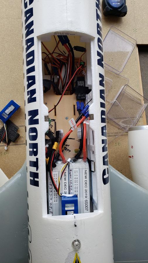

                                Ok, on testing, with two batteries, they have to be 250mm back from the hatch opening. This puts the CG about 2mm ahead of where it was with one.
                                For this, I think i need to move the mount strap back. But my concern is the batteries are way beyond the plywood tray now, is that secure enough?
                                all up weight with 2 batteries is 4.96 kg or about 11 lbs
                                Is that withing this things capability?

                                  1. Make yourself another plywood battery floor.
                                  2. Glue it down onto the foam floor behind the existing wood floor.
                                  3. Don't worry about installing another strap. Glue down some velcro and the matching velcro to the end of your batteries. The existing strap holds the front of the batteries and the velcro holds the rear of the batteries in place. Don't overdo it with the velcro or it'll be hard to separate the battery from the floor since it's so far back.
                                  I've done this on other planes and it works quite well.
                                  Insofar as flying for a much longer period of time, I feel that the time I get from just one 5000 battery is quite sufficient. This is not really an aerobatic airplane and flying around and around and around in circuits gets pretty boring. In that video, he got the time he got with two batteries by flying around at around 30% throttle. Do you really want to fly like that for that long? I did an experiment with my old Avanti S and one 5000 battery. By floating it around in circuits, I managed to get 10 minutes out of it. By the end of the flight, I was so bored, I wanted to hang myself. I have my timer set for 4 minutes on my AL. If I lugged the AL-37 around at minimal throttle, I bet I could get 7 or 8 minutes out of it but really, falling asleep from shear boredom is not very safe.

                                    xviper, you make some compelling arguments. I guess i'm thinking more about being easier on the batteries as they can share the load. This may not be as much of an issue as I think though. I'll have to see how things go with one for now anyway as I can't afford another two batteries at this time anyway.
