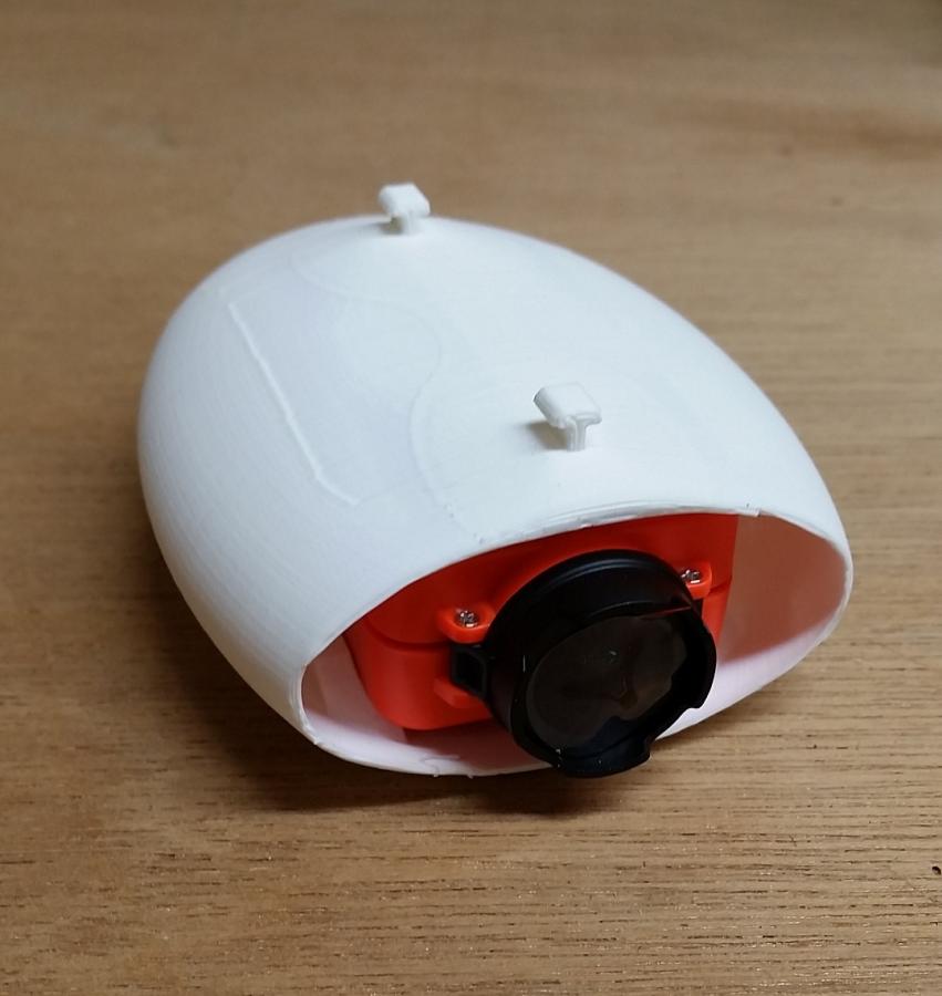

      • I shot a video earlier this evening with a camera mounted under the fuselage, its a pretty neat view because you can see the gear and flaps. At the end of the video when I landed the camera bailed out! First time that I landed on grass with this model, it worked fine.
        • Excellent video. What camera did you use?
          • Dig the cam placement!
            • Originally posted by Swarick View Post
              Thanks guys! This was with a run-cam 2 (available from Motion RC) - mounted to the bottom rear of the fuselage with a freewing weapons mount (the camera is sitting inside one of these)

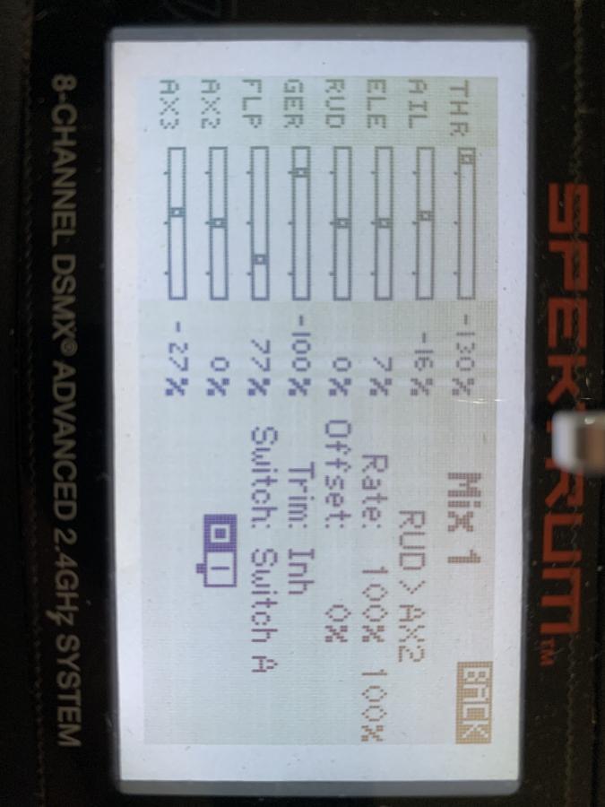

                    • Originally posted by I-fly-rc-aircraft View Post
                      Thanks, I'll need to get another rx.
                      Is yours binding up when retracted? Or are you like me and want to be able to adjust steering trim separate from the flying rudder? I'm using a Lemon DSMX 10-ch. with satellite. A 7-ch stabilizer PLUS would also work and give a little stabilization for those cross wind wing waggles.
                        I'm using an RX600SP rx. I'd like to be able to have the steering off when the gear retracts but I'm pulling my hair out trying to get it set up on my 8 ch tx.
                                  Love the angle and is that a 3d printed pod made for the runcam? Would love to try that out with the stabilization of a gopro7, but I wonder if the height/foward facing square shape would cause too much drag.
                                    I have the first 4 channels as usual T,A,E,R. 5 is my gear, then Aux1 is flaps. I have the steering servo on Aux 2.
                                    Almost to tears here trying to get it to work.
                                    Tom
                                    You can't use AUX2 (ch.8) for a servo* when you don't have a channel 8 on the receiver. Your RX only has 6 channels. You say you have the steering servo on AUX2 BUT what's it plugged into on the 600SP? *If it's anything like the Lemon equivalent, Ch. 8 can be used to control the "master gain" of the gyro even without a 8th port but that's a different scenario. To work a servo, it must be plugged into a port.
                                    • He only needs 7 channels. AUX2 (ch.7) on a RX600SP can be used if not using gyro.
                                      • Originally posted by Beeg View Post
                                        Got it. I didn't know that the 600SP had a 7th channel. I see now that the "bind" port is also the AUX2 port. He's good to go. He just needs to know how the do the mix. Here's one of my mixes to get the steering working via the gear switch:
                                        Note that the switch is whatever you use for the gear. Mine is "A". Yours may be different.
                                        • Ok, so after pulling out my last hair this is how my DX8G2 tx is set up. Keep in mind I'm using the Admiral rx600sp which is a 7 channel rx using the bind/aux2 port.
                                          Servos in ports.
                                          1.T
                                          2.A
                                          3.E
                                          4.R
                                          5.Gear
                                          6.Flaps
                                          7.Steering
                                          Rx port assignments:
                                          1..T
                                          2..A
                                          3..E
                                          4..R
                                          5..Gear
                                          6..Aux1..flap
                                          7..Aux2..Aux2
                                          Channel input config:
                                          1..T
                                          2..A
                                          3..E
                                          4..R
                                          5..Gear.A
                                          6..Aux1
                                          7...Aux2..Rknob
                                          Mixing:
                                          P-mix 1: -G-> Ger
                                          Rate....0.....5%
                                          Offset.....0
                                          Switch.....On
                                          P-mix 2 : Rud> Ax2
                                          Rate....100%.....100%
                                          Offset.......0
                                          Trim.....Inh
                                          Switch...Switch A
                                          Mix 1 is to allow me to turn the stabilizer on/off via a switch. Switch G.
                                          This is the only way my steering servo will not steer when the gear is up. Note: even though my Rud to Aux2 is assigned to Switch A (Gear) The Rknob turns off the steering.
                                          One benefit to this is now my Rknob will trim the nose steering without affecting the Rudder trim.
                                          Tom
