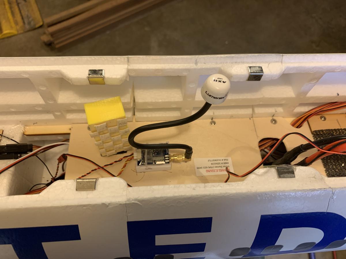

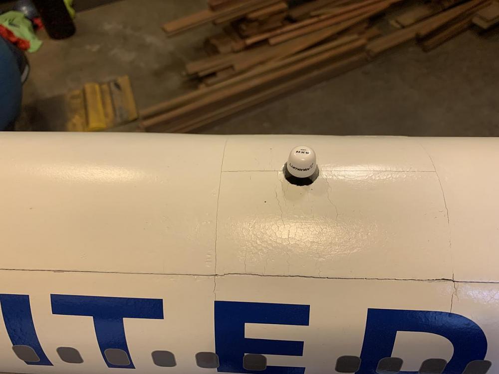

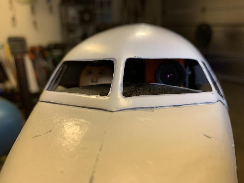

            Originally posted by vduniec
ID:	260408Click image for larger version

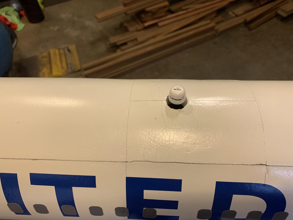

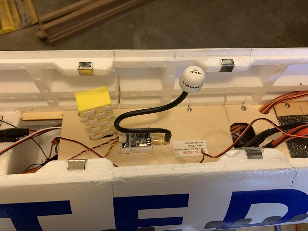

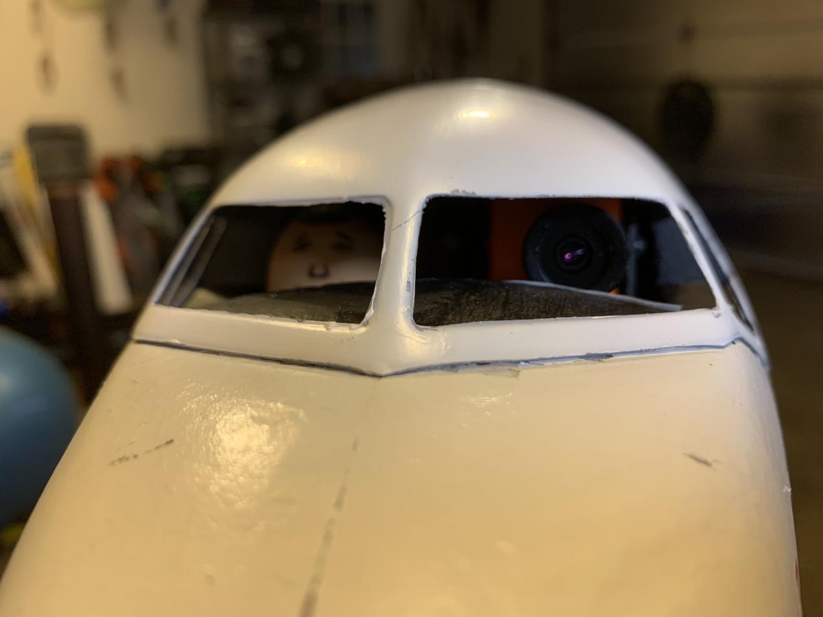

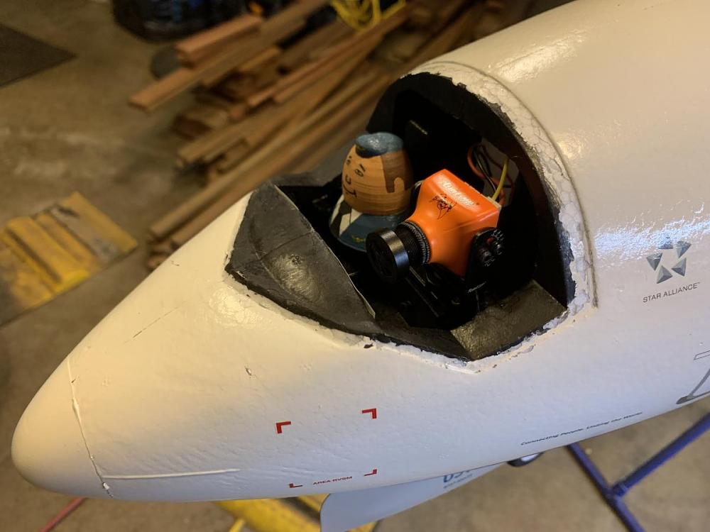

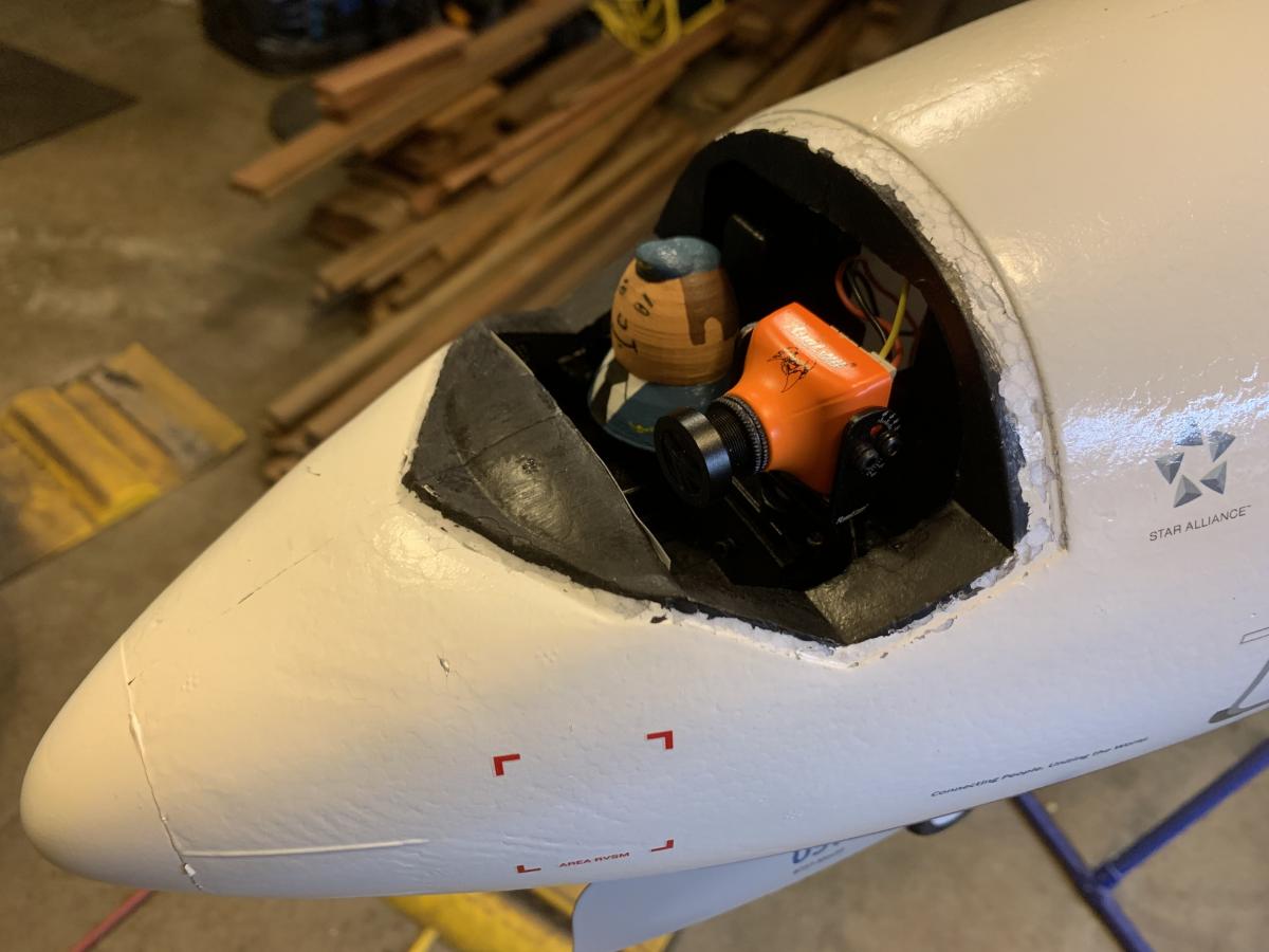

ID:	260409 Got my Max 10 configured with an FPV setup. The camera has a pan function but not tilt due to the limited lines of sight. I tried to make the FPV gear as unobtrusive as possible. Can’t wait to give it a try from the cockpit! Click image for larger version
ID:	260406Click image for larger version
            That looks fantastic V! Please share some screen recording if you can of a flight once you do it. Would love to see how you land it FPV in the high alpha position

                  LOL, now that's awesome and funny! Great job.

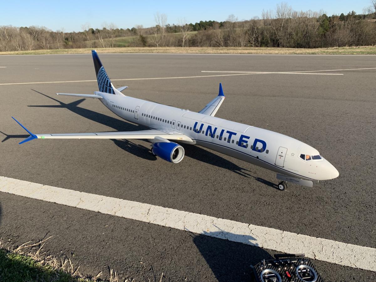

                        Here ya go James.
                        Sorry about the video quality. It's from the built in recorder in my goggles. I have some RunCam Splits now and will start using them so I can get HD quality videos.
                        The cause was due to my use of underrated battery connectors. The good news is, is that the failure occurred over the airfield and I was able to retrieve all components. A few seconds earlier, it was over an active garbage dump and I might not have been able to get access to it.
                        Replacement parts are have already arrived. Click image for larger version
ID:	262578 I stretched the fuselage on this one out to a Max 10 and did it in United Airlines livery. It looked nice but I was indifferent about the scheme wh it was completed. I’ll do the next one either as a Max 8(stock) or as a -800 version. Leaning towards the old American Airlines silver bird scheme.

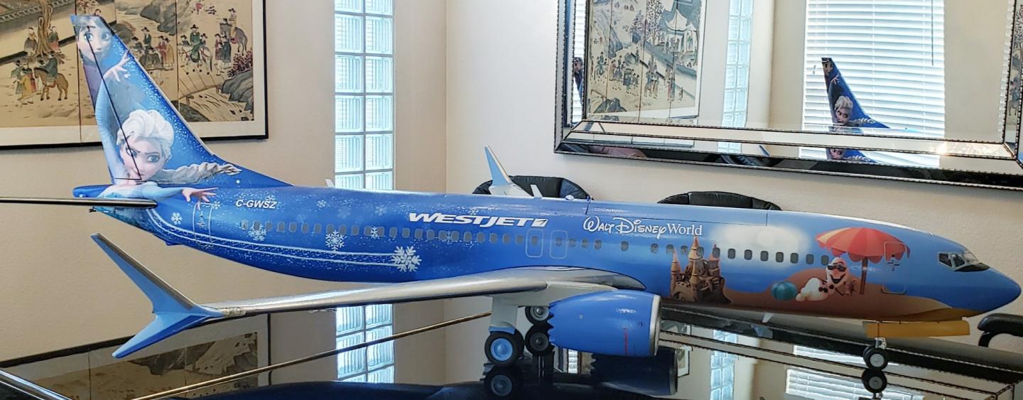

                            Maiden next week. Second plane. You be straight forward.

                                Oh my! That is sooooo nice! How much of that is stick on graphics?

                                  the tail characters, the snow man beach side and lettering. Everything is airbrush work.

                                    A true artiste.

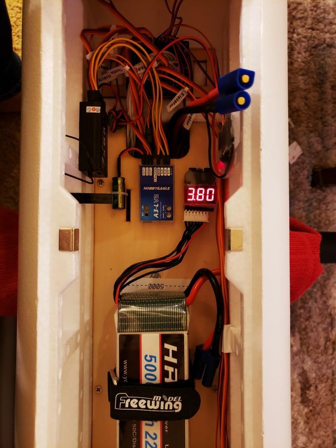

                                          BEC wiring issue:
                                          After about 5 fights I noticed that connection from the main battery would disconnect intermittently... on the ground, thankfully. Turns out that the solder connect at the main battery to the BEC is damaged from pulling and twisting my tight EC3 connectors.
                                          Be careful and check your wiring.
                                          My solution is simply using a small (700-1100mah) flight pack. Doesn't seem to affect flight characteristics, but it is another battery to charge.
