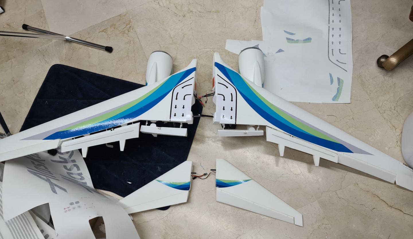

    She got banged up on that one. I think its all fixed and will fly tomorrow.

      Short flight to no-power crash….what was the cause? Glad it was repaired and wasn’t worse.
      -GG
        • 8835
        #2143
        -GG
        I've done that before myself and it wasn't anything mechanical or electrical. It was me NOT being able to gauge the distance from the end of the runway and miscalculating the final approach path - too low, too slow, too far from the end of the runway.
        In his video, it's hard to tell, with all the wind noise, if he even powered down at that point. Can't really hear any change in the sound right up to the point it hit the bush.
          I think you are right on this. I had and have no signs of any issues with the radio and receiver. I do thin I have an issue with gauging my distance and I definitelycannot tell my airspeed when its comming right at me. It could be 10 or 100 mph. I was able to get the aircraft together and fly today. I tested a bunch of things last night and found no problems within the aircraft or radio systems. I also struggle with the wind out there. It goes from calm to windy in a second and without warning. Its amost always a cross wind. So maybe a combo and most pilot error. To slow for the position of the aircraft. I was not over the end of the runway like I thought. Wind contributed to an already slow aircraft and bam. Two flights today and no issues. The main damage was the vertical stab and 1 engine nacel. So not bad for that.

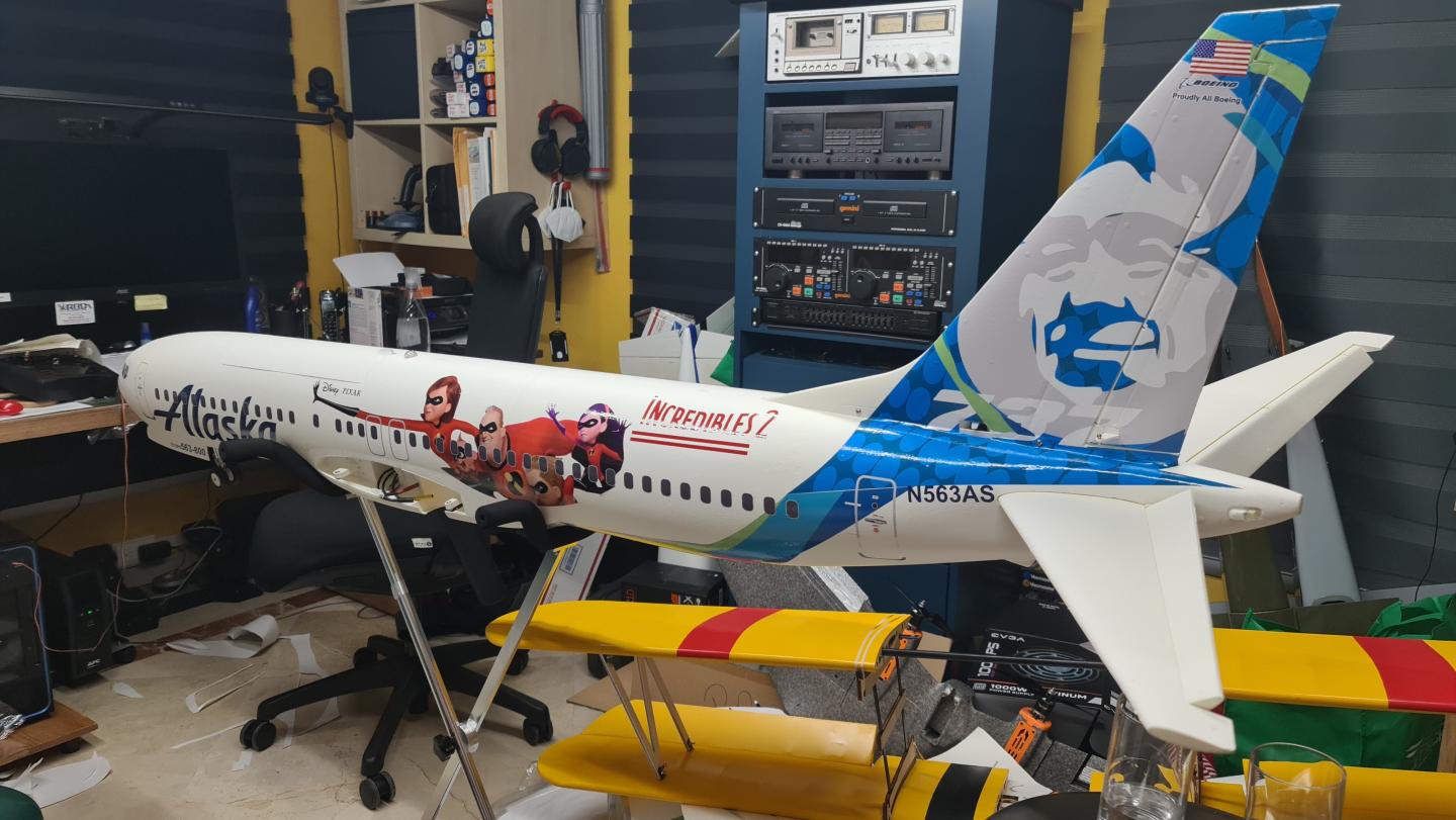

                          here is where I put some.

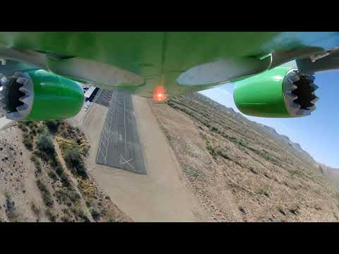

                            What type of camera are you all using to take these videos?
                            • MeyerVW
                              crash test pilot
                              • 288
                              • Dude who likes flying.
                              #2154
                              I have a runcam2 4k and runcam 5 The 5 is awesome.

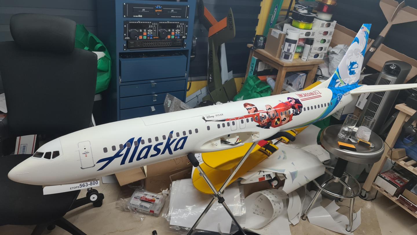

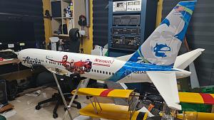

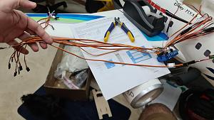

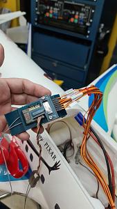

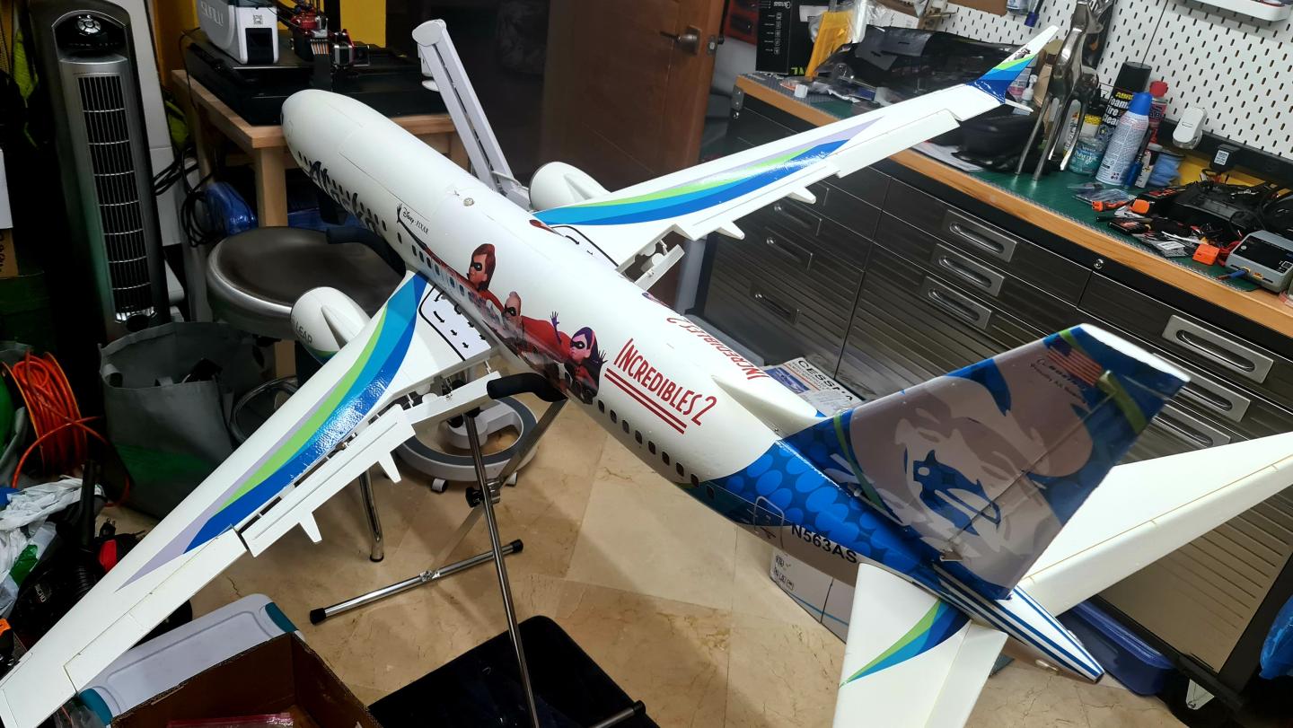

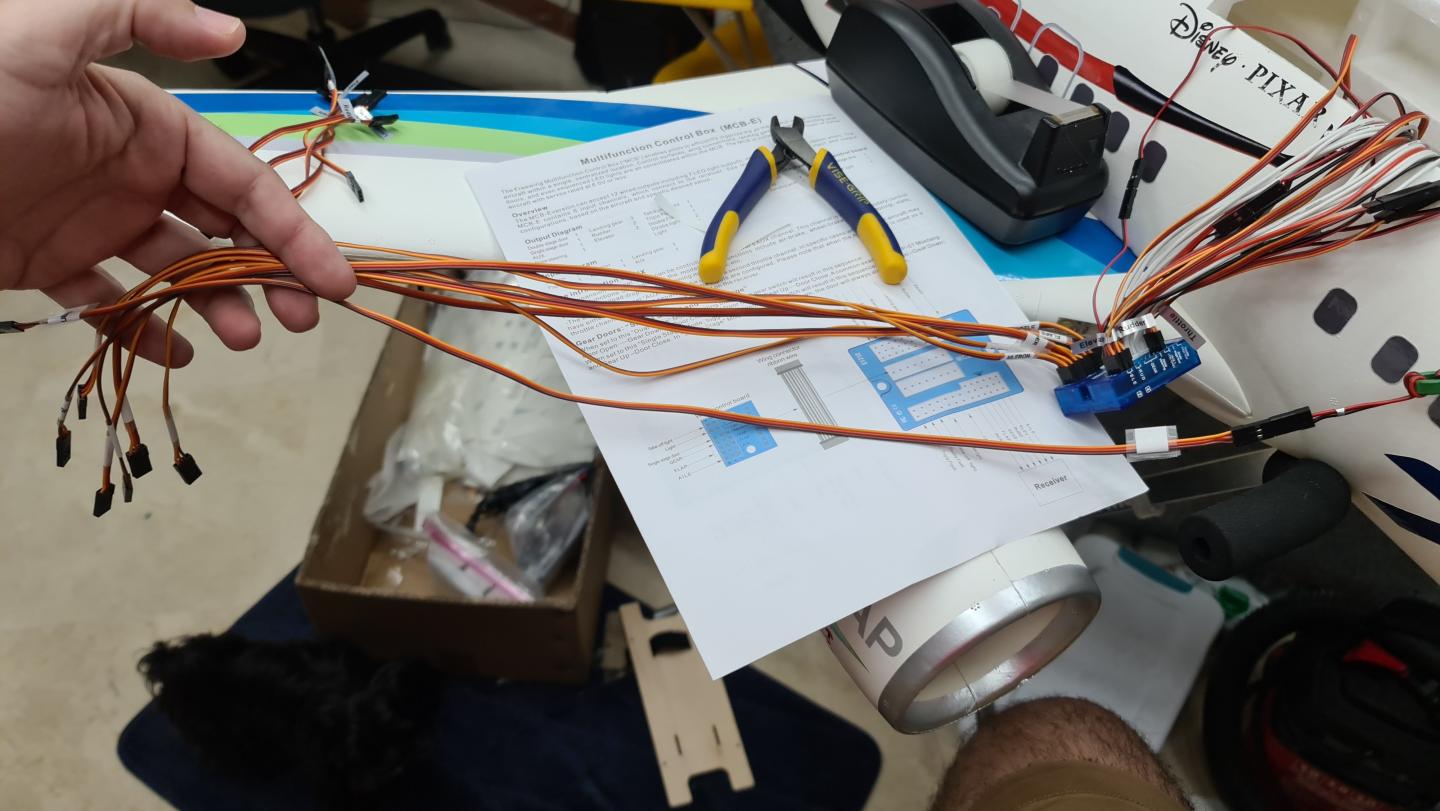

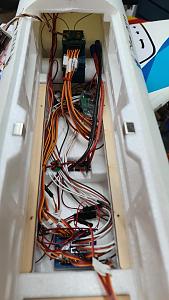

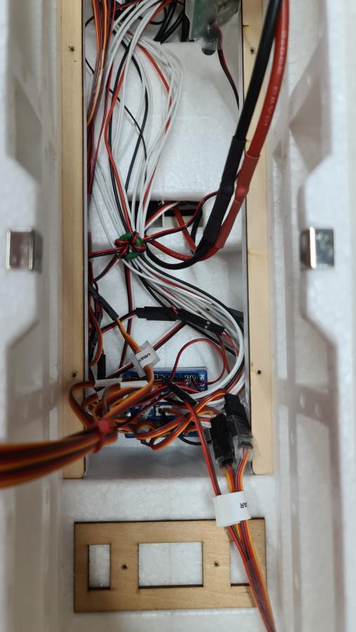

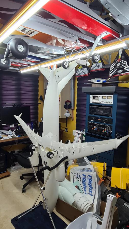

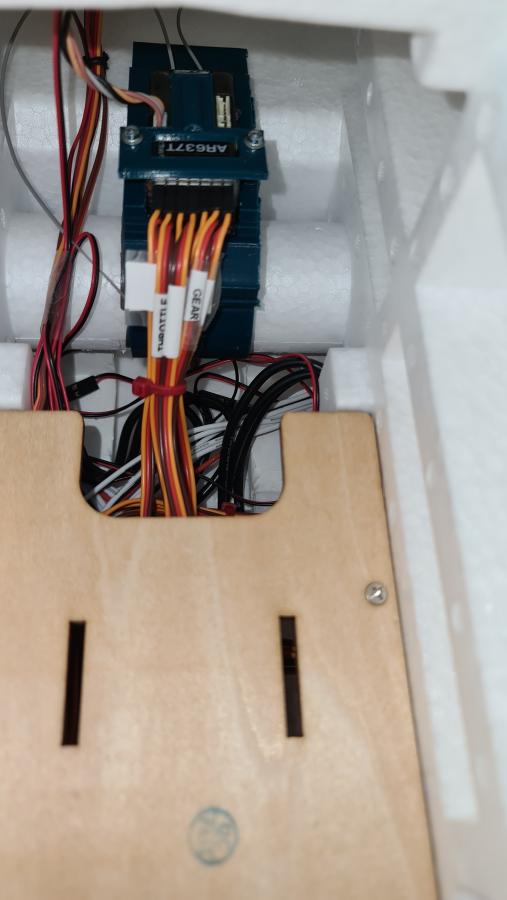

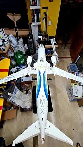

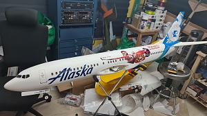

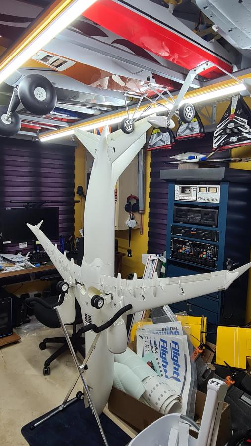

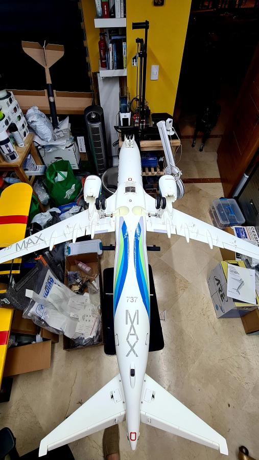

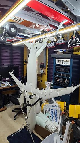

ID:	335460 Hi to all from the Dominican Republic. I decided to build my storage AL-37 a few weeks back and decided to decorate it with the Alaska Airlines Cartoon scheme. Due to a lack of information i didn't prepare the base color of the tail for the decals, so i used one that i ordered also of the B 737-800 original launch livery as a base and over it i put the face that goes on all Alaska Airlines planes. Also i modified a little bit the original design but it came completely amazing !!!!. Also i will use the Spektrum Ar 637T receiver and decided to put it over the CG point, to reach the position i design and printed myself a base that compensates the 12 mm difference (nose down) from where is going to go vs the real leveled attitude. And also i'm taking my time with your comments so i can made the improvements before the maiden.
                                • GliderGuy
                                  • 1416
                                  #2156
                                  Nice Job Wrangler1 / Just a couple of items for you to consider...
                                  Feb 25, 2021, 09:53 PM This will help keep the wing from developing cracks, if you plan to fly a lot and/or do aerobatics.
                                  AND....enter the words ferrite or RF choke or choke in the search window and read/learn about this easy to install and cheap preventative measure for helping prevent potential radio issues. I installed them on both the frontside and backside of the AL37 ESCs (lots of room under the battery tray). I also installed an RF choke in the tail on the wires running to the elevators and added a small one by the green ferrite ring up by the receiver.
                                  I've made several thousand flights on the AL37 (and F-4 and MiG-29) without issue. Others have shown better radio performance (fewer holds and fewer frame losses) after installing the RF Chokes. Prior to using them, I lost an F-4 and an A-10. No issues since I began using them.
                                  -GG
                                  • wrangler1
                                    • Feb 2019
                                    • 116
                                    • Dominican Republic
                                    #2157
                                    -GG

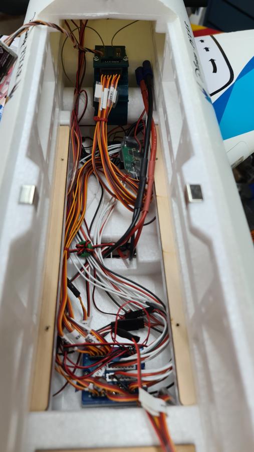

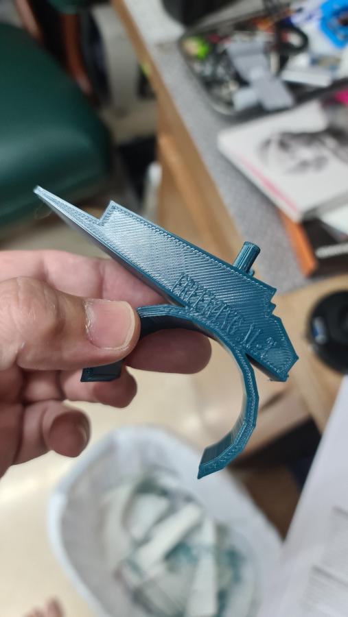

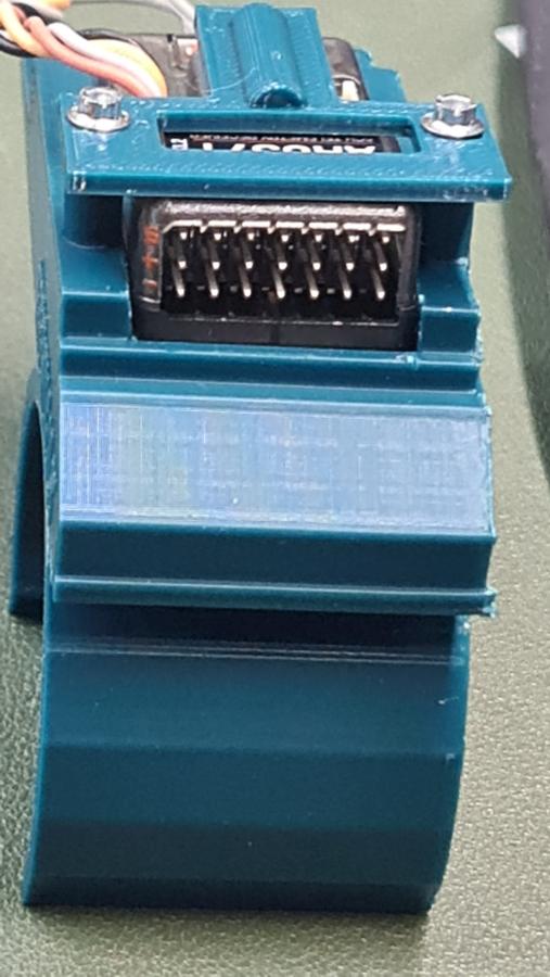

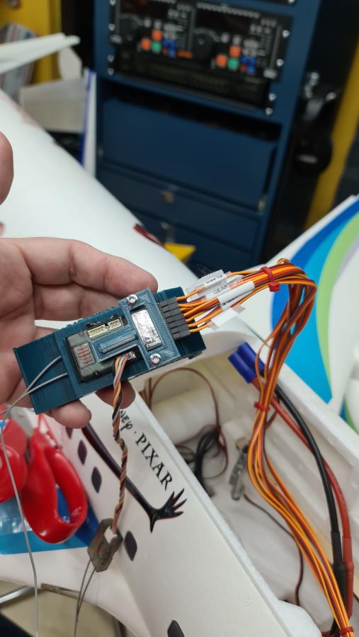

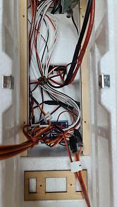

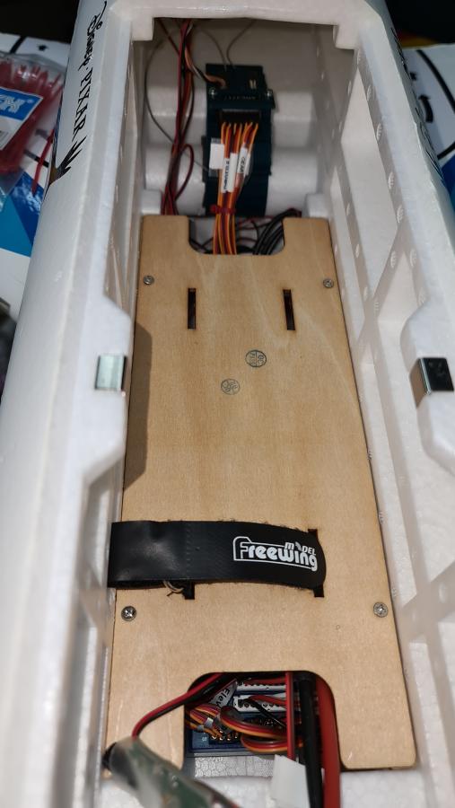

                                    HI glider Guy, normally i put some ferrite rings on the power line to the rx and also to the ailerons, elevators and rudder. But when you say choke, what type of choke are you reffering to ( can you show me an example pls ?).
                                    By the way, today i made the cables that goes from the rx to the blue box and also a PLA base for the blue box and put it below the battery tray. ( photos attached). Click image for larger version

                                      Lots of options available …. One example
                                      https://www.amazon.com/dp/B07CWCSNW9...Y208NXE4DZKQ8G
                                      Place as close to the ESCs as possible. Several wires can run through one choke. I then put a zip tie around each choke to ensure they don’t pop open.
                                      If you have room, add to both sides of the ESC.
