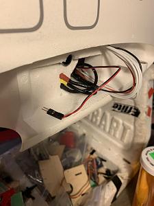

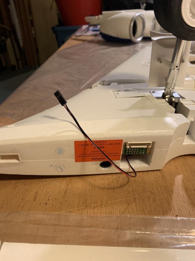

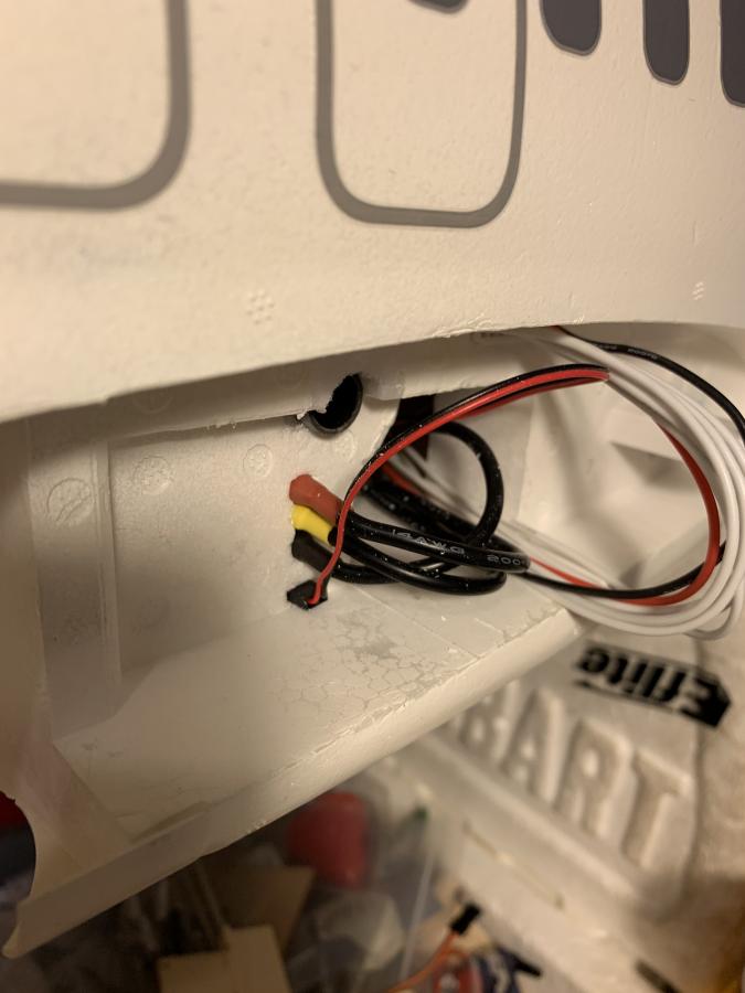

          Can someone tell what the 2 extra lighting wires connected to the blue box with long leads and pushed into the wing root are for?
            I haven't put my wings on yet but I believe those are to connect the corresponding wires in the wing that goes to the lights. Take a look at the fat ends of the wings and you'll see one set of 2 conductor wires in each.

              #1146
              I haven't run a multimeter over them, but guessed they were for the sequenced lights near the root of the wing, hence why the connect to the blue box and not the main wing connector.

                #1147
                I don't use them and all lights seem to be working. I think I may have tested them and they seemed to be blinking so I left them alone. Might come in handy if I want to change out the solid tail lights.

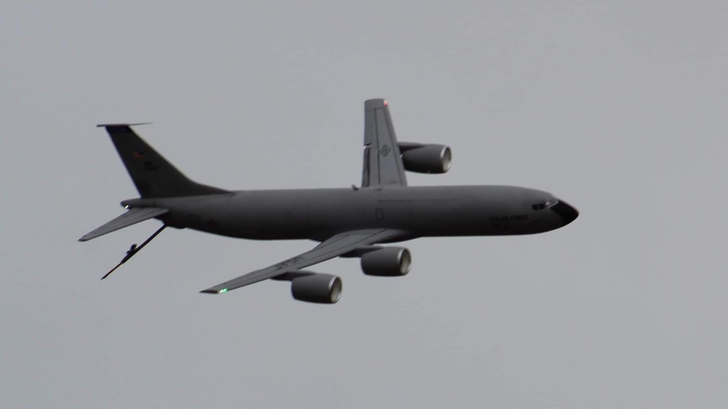

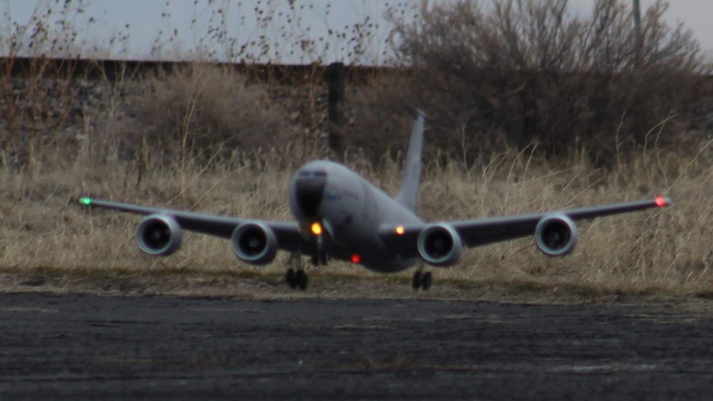

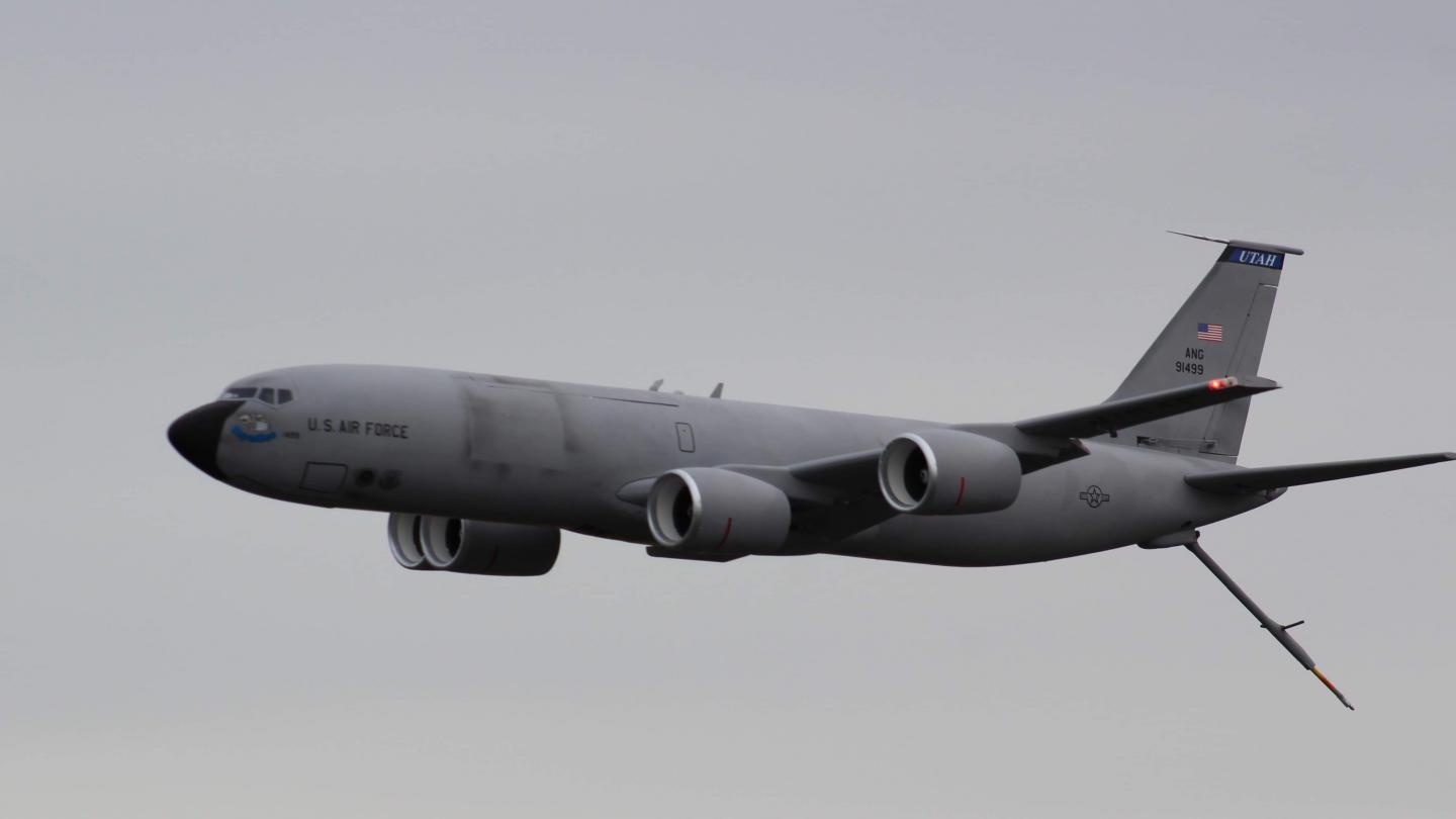

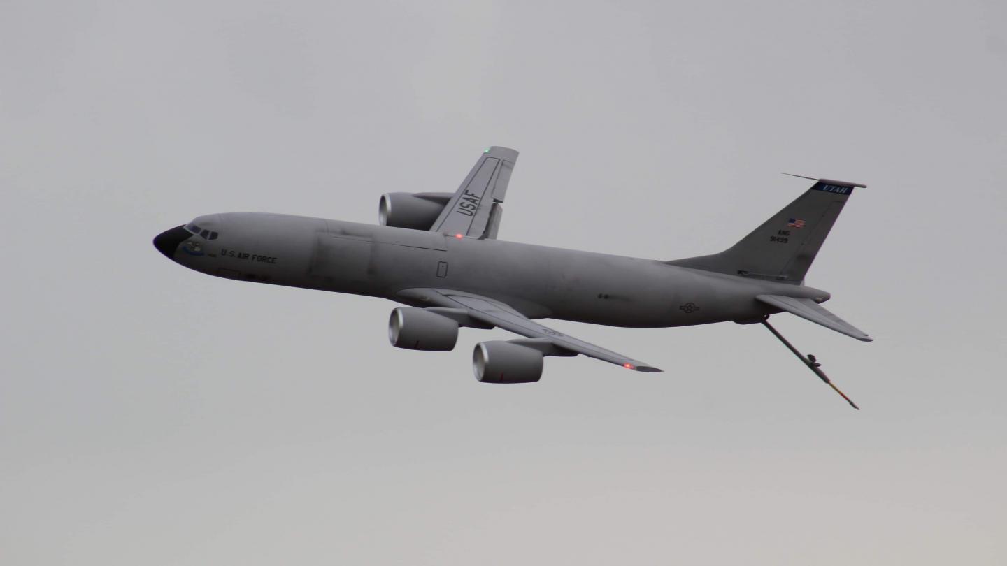

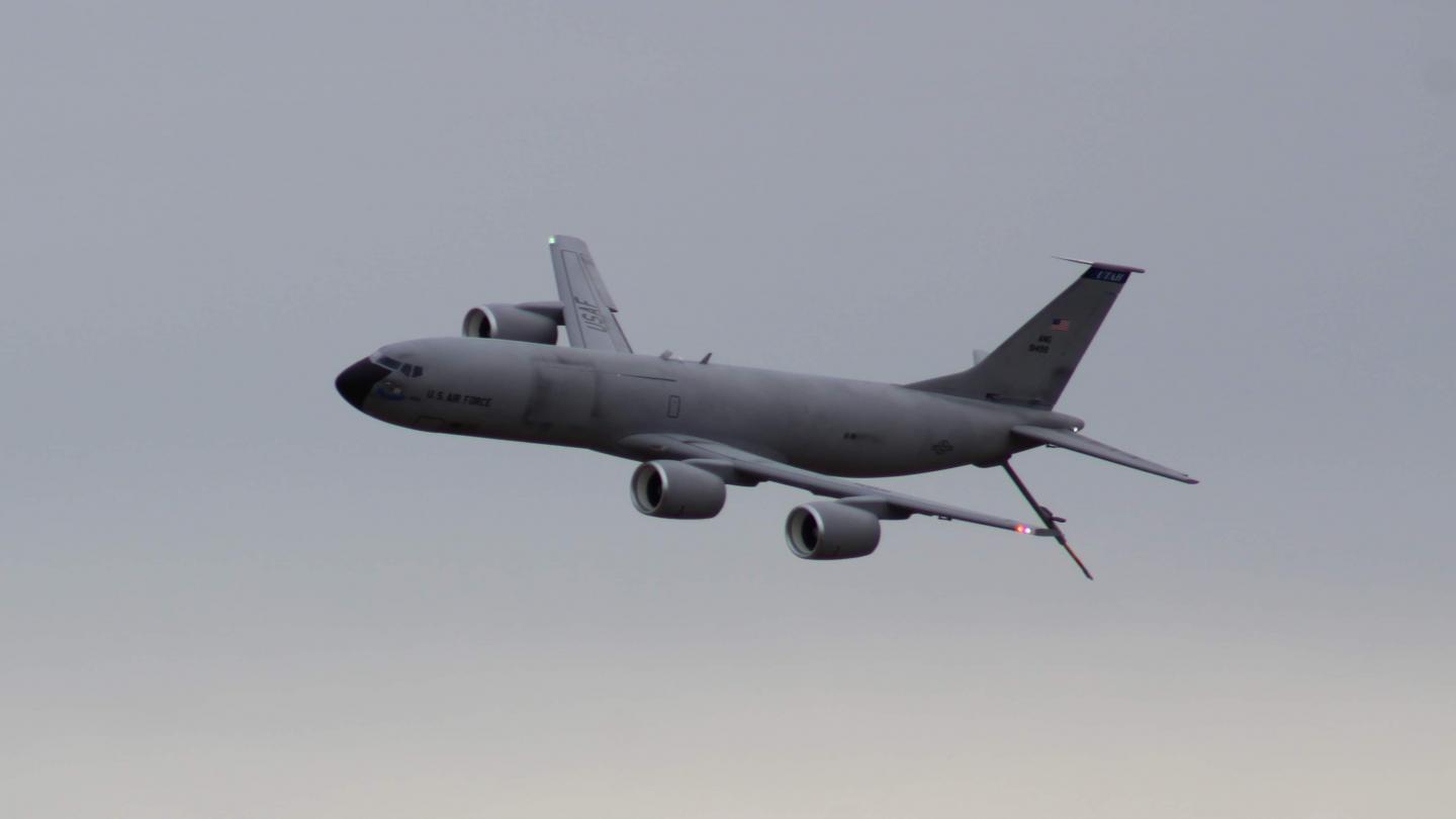

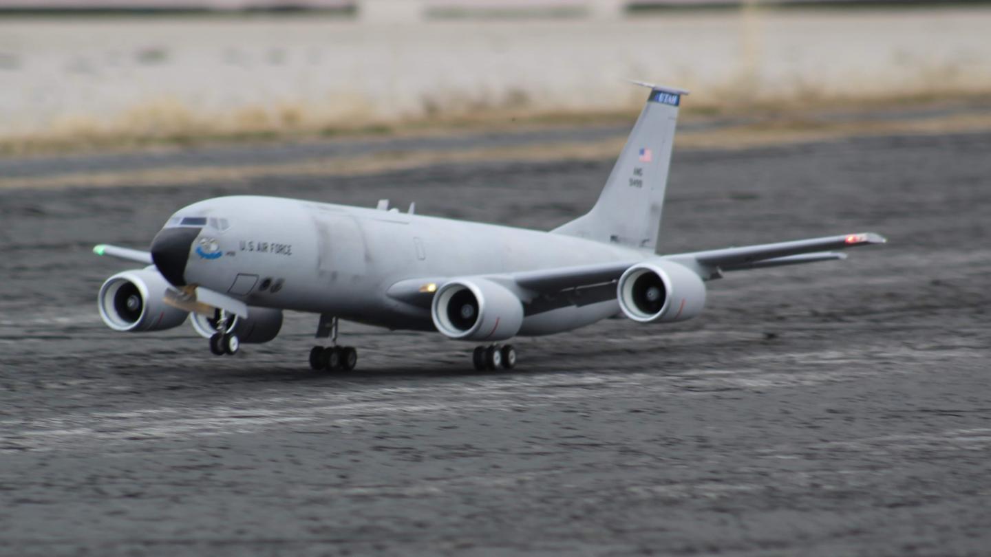

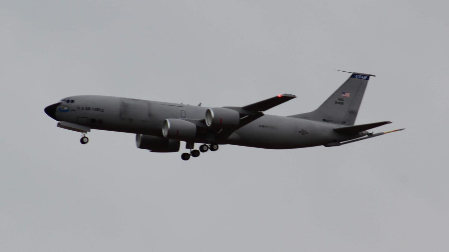

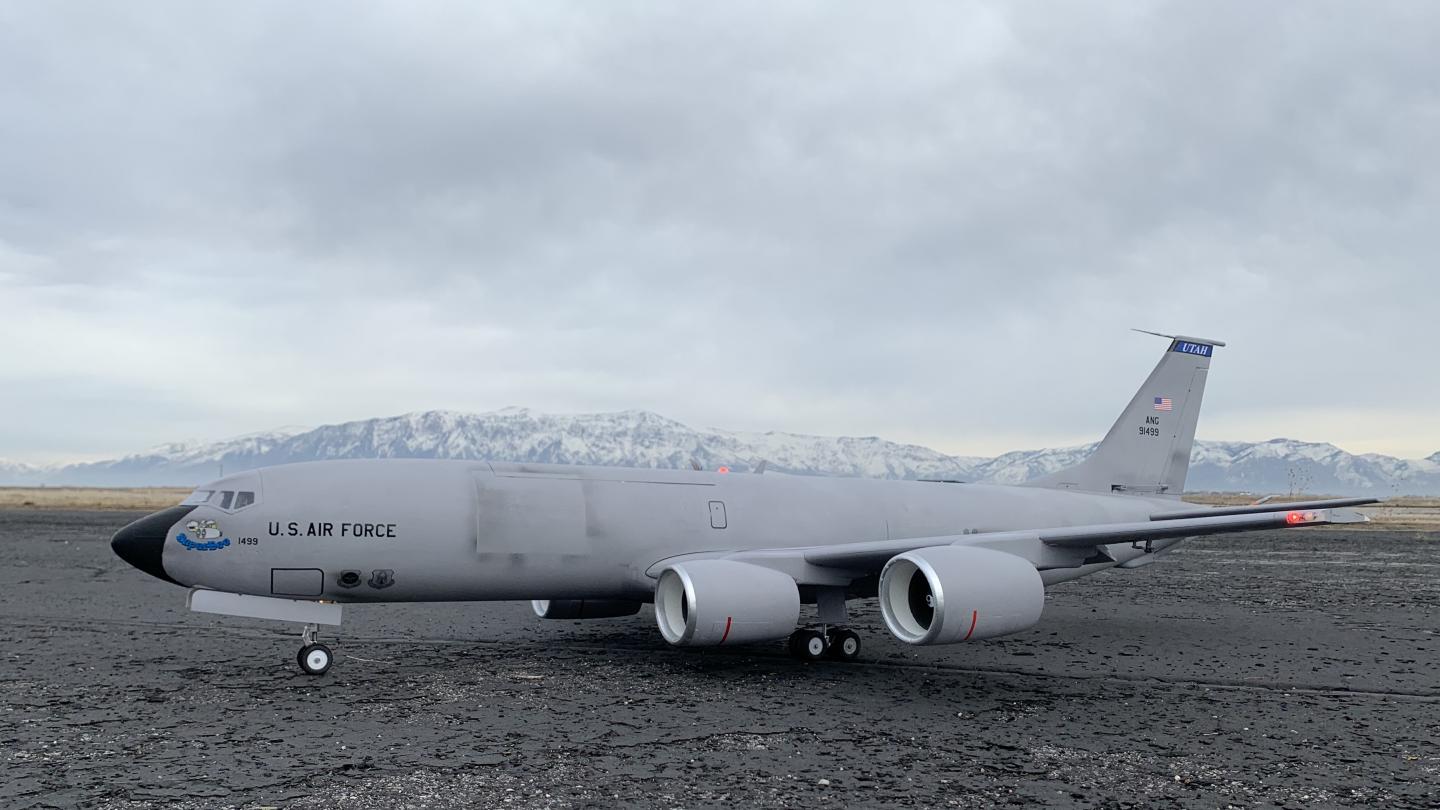

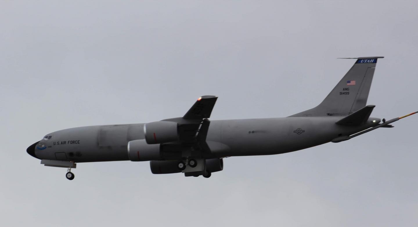

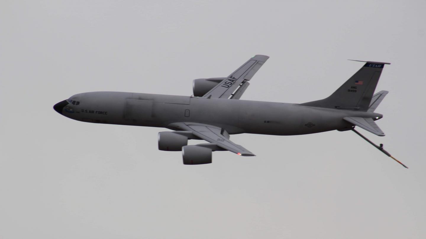

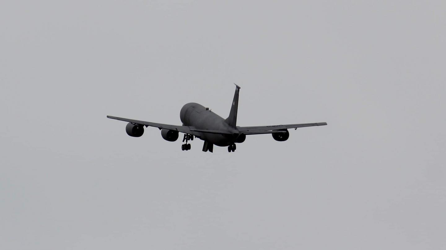

                    #1149

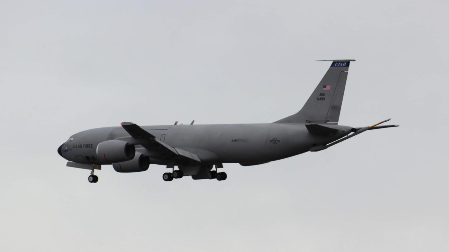

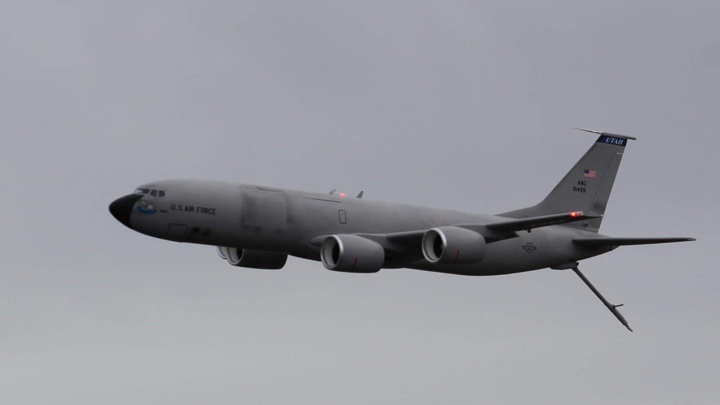

                    Pictures of the First Flight of my AL37 made into a Kc-135.
                    Video below:
                    Flight went perfect, the new Double Bogie Struts did exceedingly well for custom made.
                    Thanks for all who helped this project
                    J.M. Burulcich- Motion Rc and Freewing (Airframe)
                    Tom Mansell - Landing gear mod- 3d design work
                    Shawn Sagen- pictures taken
                    Callie Soden- Decals
                    Andrew O'L

                      4923crew That is just sooooo fantastic Bro!!! Bravo!!! Great, great job... Can it hover??? Love it!! Jerry
                        #1151
                        Incredibly impressive! Really fine work there 4923crew !
                        • Wild Man
                          • 527
                          • Rapid City, S.D.
                          #1152
                          I agree you are making all of us Incredibly impressed I have had 5 guys call me and ask me if I had seen your C-135. I use to work out by Ellsworth AFB here in SD. Also watched them refuel the B-52 years ago north of Alzada Montana, years ago while i was still working for Cat. still working on mine

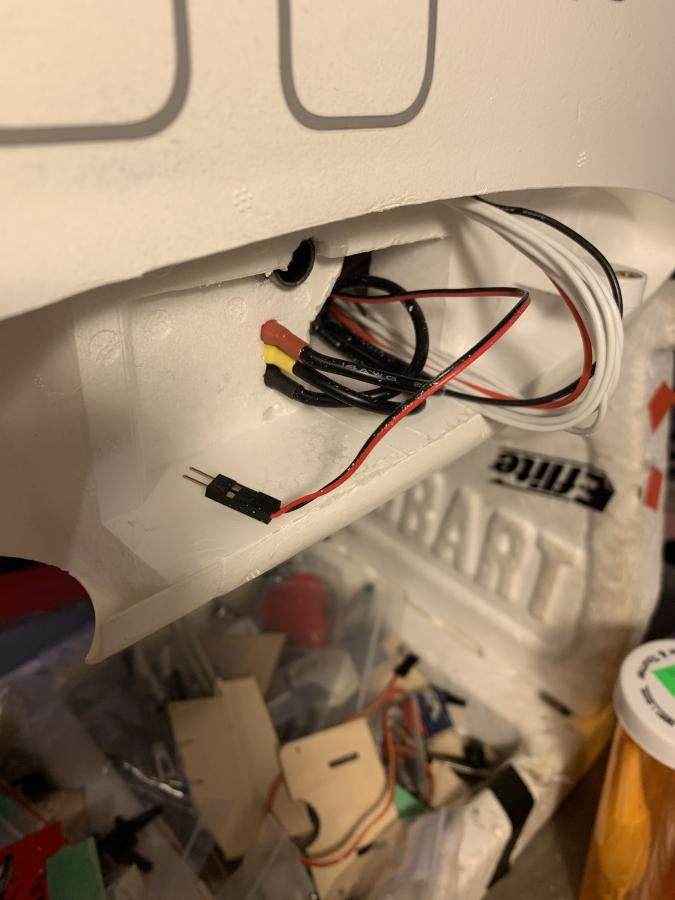

                            OK, the wing tips have 2 lights in each housing. The inner ones are solid (one side is green, the other is red). The outer ones are white and they blink. It is this light on each side that the dangling connector is for. If you don't plug them in, you will think that ALL the lights work. Plug it in on each side and you will see. That ones on the wing root are white and they only come on when the gear goes down.
                              The wing has Landing lights, Anti-k lights and Marking lights (Red-Green). The one you speak of is the one in between the engine and the fuselage.

                                #1155
                                4C, Picture #234807, the shot from slightly below and aft with extended boom is my fave. Great execution of a true USAF workhorse. Outstanding. Best, LB

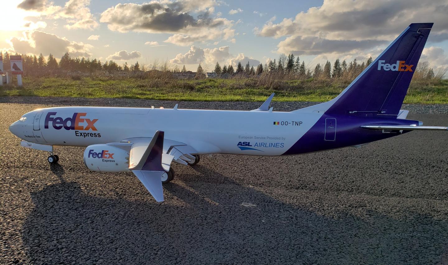

                                  Finally got her out for some pictures and taxi. I'm pulling the gyro out then checking CG and getting it in the air!
                                    Not on mine (meaning the landing lights are not controlled by those loose connectors). The one between the engine and the fuse is white and comes on when the gear goes down. Yes, those are the landing lights BUT, the loose, solitary 2-conductor, mated plugs, work the outboard blinking tip lights (I believe those are the wires that MANFRED asked about). It's like on the real 737 when it comes in for a landing. You see them particularly at night, head-on. They are like the headlights on a car. The ones I (and MANFRED) speak of are the loose connectors - the one on the wing root is the one that's shipped with the end pushed into the spar hole; the one on the fuse is the one that's pushed into the a foam slot near where all the other loose ends are pushed in. The two ends are mated - one is male, the other female. When the plane is powered up, with the multi-plug plugged in and then you plug those loose, 2-conductor, mated plugs together, you will see the outer wing tip lights come one and they blink. All the lights on the wing are controlled through the multi-plug EXCEPT the very end lights on the wing tips.
                                    Just so we're all talking about the same thing:
                                    Click image for larger version  Name:	IMG_3526.JPG Views:	0 Size:	61.0 KB ID:	234883Click image for larger version  Name:	IMG_3528.JPG Views:	0 Size:	50.1 KB ID:	234884Click image for larger version  Name:	IMG_3527.JPG Views:	0 Size:	55.5 KB ID:	234885
