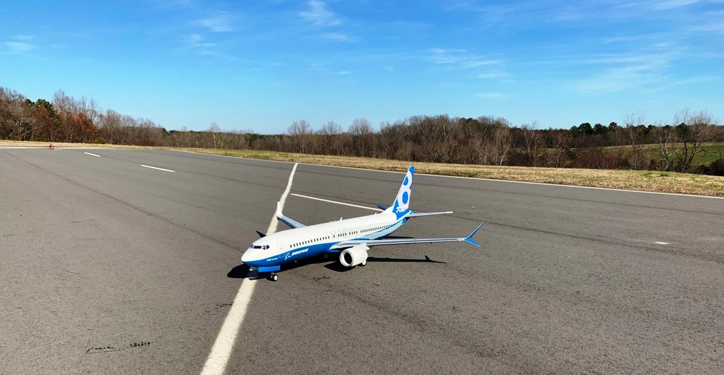

            Finally got some pics from the field.

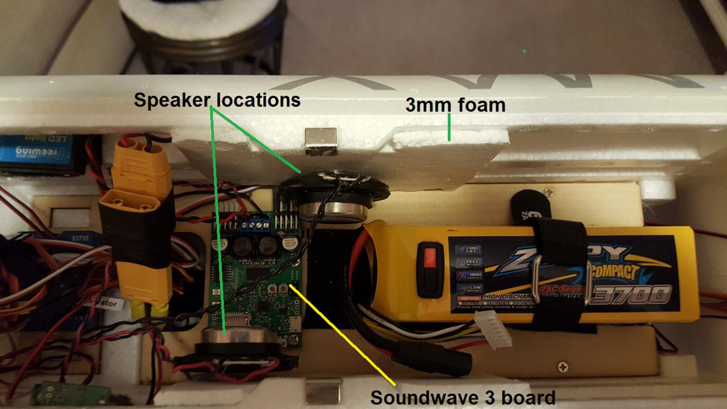

                Here is the install photo of the SoundWave 3 installation. For the review: The sound quality is excellent. Under cruise it sounds awesome. However under full power the is a mix sound between the real fans and the sound wave generated jet motors. The FW fan are louder than I had expected they would be. Maybe I can build a box around the sound generators that may help increase the volume which I had turned up fully. It does sound awesome though and the startup/shutdown is really good. Maybe if generators were mounted in the wing they would provide a higher lever under power. All in all I would give it 4.5 stars. Quality is really good. If anyone has any suggestions I would be all ears.
                  #1188
                  If you could mount them directly to a thinner wall of the fuse it may help considerably. On my A-10 I mounted two 4 Ohm exciters in series to the foam in the belly of the fuse under the wing. Foam is about 3/8" thick and they were very loud.
                    The fuse is too round to mount them directly to the fuse sides that's why I mounted them to the sides and kept the foam to the minimum thickness.

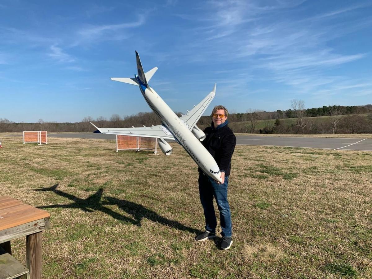

                      avanti127 are you sure that first pic isn't the full scale on final?
                      • avanti127
                        • Apr 2018
                        • 96
                        #1191
                        LOL, no it's our home field.
                          The exciters work by vibrating the surface to which they are attached which in turn vibrates the air. So if the material is too thick it won't flex enough to make the sound extremely loud. A foam thickness of between 3-5mm is ideal. Is it possible to mount one in each wing?
                            Here is the install photo of the ShockWave 3 installation. For the review: The sound quality is excellent. Under cruise it sounds awesome. However under full power the is a mix sound between the real fans and the sound wave generated jet motors. The FW fan are louder than I had expected they would be. Maybe I can build a box around the sound generators that may help increase the volume which I had turned up fully. It does sound awesome though and the startup/shutdown is really good. Maybe if generators were mounted in the wing they would provide a higher lever under power. All in all I would give it 4.5 stars. Quality is really good. If anyone has any suggestions I would be all ears.
                            Actually, the board is called ShockWave 3, not SoundWave 3. Thanks.
                              David, my foam is 3mm or less in places but there is an air gap to between it and the fuselage foam so I think this is the issue. I am going to remove that section of foam and contour it as thin as I can to radius the fuse then glue that in to the inside of the fuse. Hoping that will do the trick and I am sure it will improve everything.
