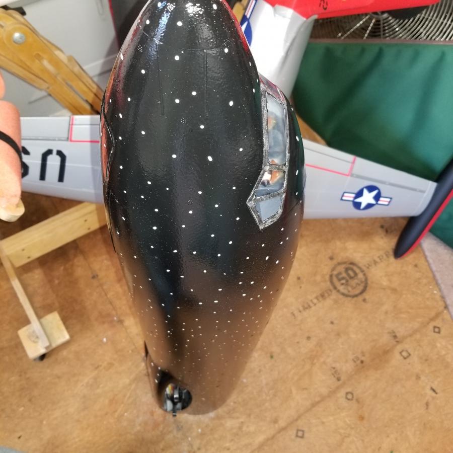

    Dont worry about Corona virus......we have.rustoleum measles.
            TP, Is that intentional or something on the model before you painted? Best, LB

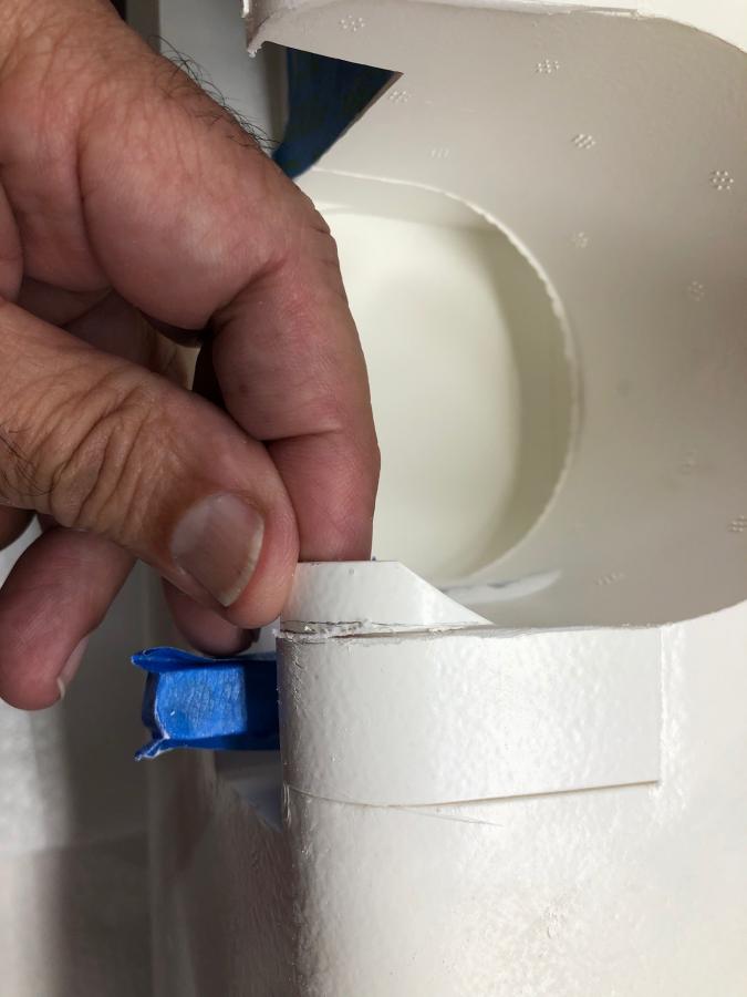

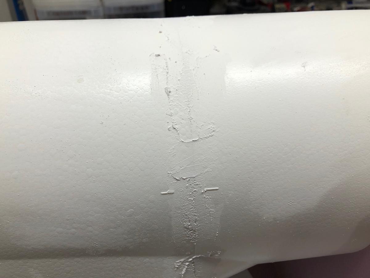

                I guess last night I learned a lesson with foam airplanes, they are delicate, I’m a large scale scratch builder and this is my first foam assembly and Im just in awe as how flexible they are and at the same time how delicate. last night I walked into the shop te retrieve my cell phone and accidentally bumped into the port side stab, not a big hit but enough to rip the tip of the stab, after a few choice words I went to the Motion page to order a replacement, and then I said, hold your horses if you can scratch build from scratch you can fix this. So here is my repair, sorry I didn’t take pictures of the damage but here is the fix.
                I used some RC56 canopy glue very reliable great adhesion and wont harm foam, I then took a piece of piano wire warmed it a bit and created a canal, I then slipped a bamboo skew covered in white glue, I drove 2 of them in and filled the crack area with sparkling compound, followed by some 400 grip sanding, problem solved.
                So I then decided to sand the entire plane to remove those ugly injection marks, and smooth out the surface, I also filled the fuse joint to be sanded smooth tomorrow, here is the result of the sanding I think is a big improvement and when painted and clear coated. Sorry I cant get the photos in sequence for the before and after but you can see it on the vertical pictures.

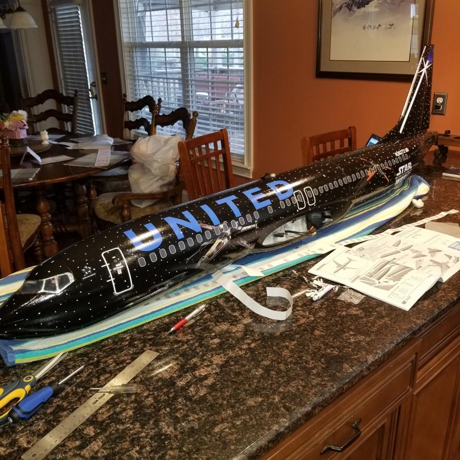

                  Looks like he’s doing the UAL Star Wars plane.

                              Slowflight Sorry for the bump, but great job fixing it. Filling and sanding is no fun, but worth it in the end! Jerry

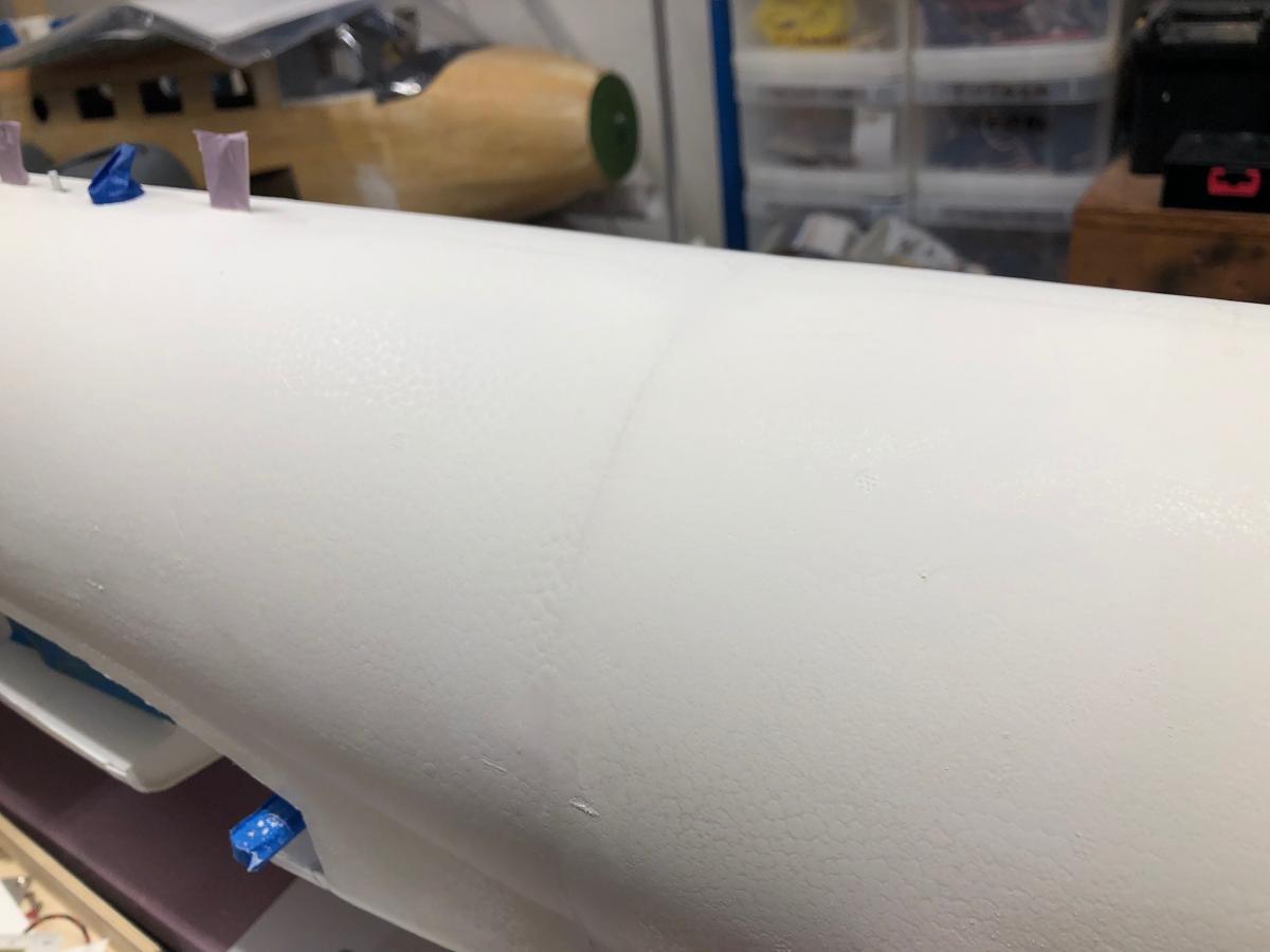

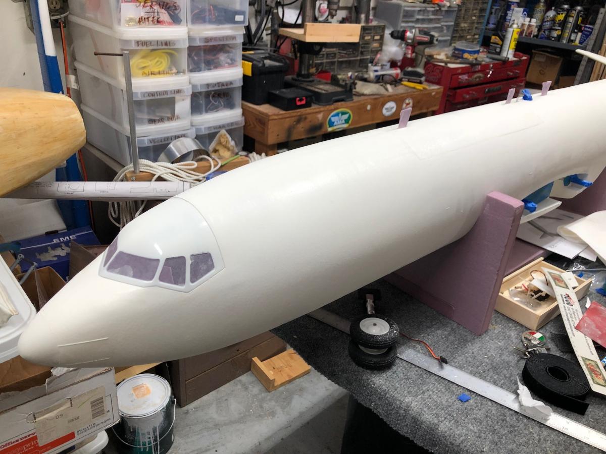

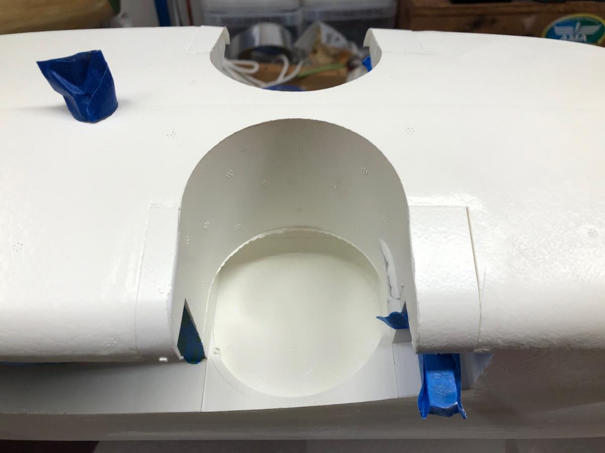

                                The fuse joint was filled and sanded, you can see a shadow under but the surface is smooth, I also finished sanding the entire plane with 400 grit and it removed 80% of the snake skin look, I’m confident that with the latex the surface will be very improved, I don’t expect all to disappear but I think is a huge improvement, I know I know this is not a scale plane but why not pretend, and as all that know me can tell you I just cant leave things as they come. Which brings me to another point, I find it very inconvenient having to cycle the gear to install the wing, I store the wings with the gear retracted and I want to assemble the plane and then when I’m ready and all is connected I’ll lower the gear, yes call me anal, anyway I remove a small amount of the wheel well that will allow me to just slide the wing in and out without having to connect the battery and turn on the radio, and is barely noticeable. I also removed all the protruding decal alignment marks, I took some measurements for reference to apply the door decals later, since is a Poseidon there are no side window to worry about except for 1, and the rescues doors.
