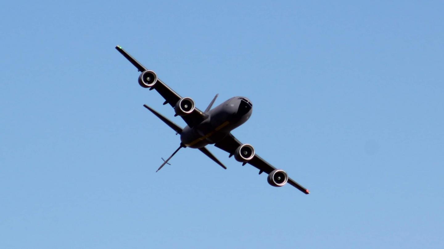

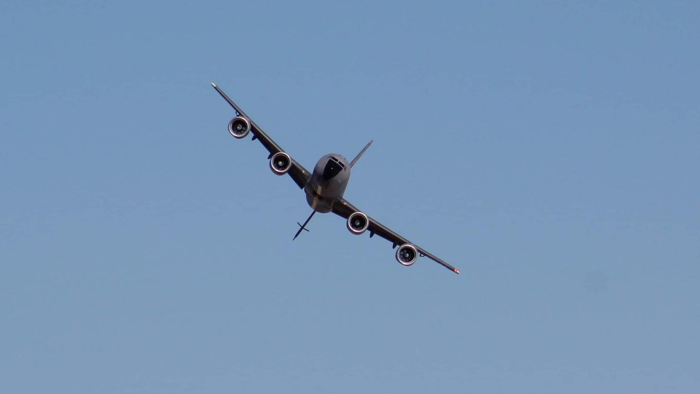

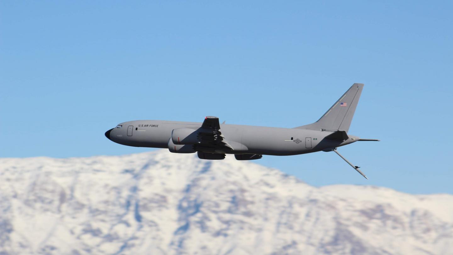

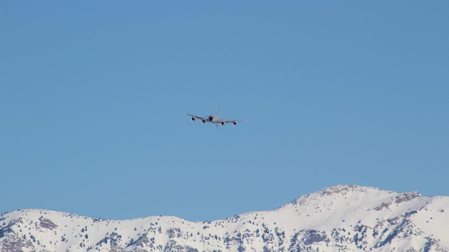

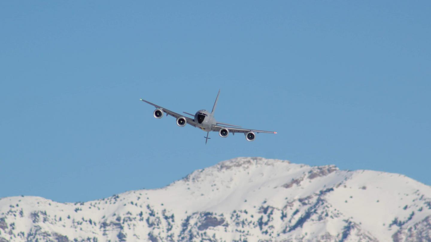

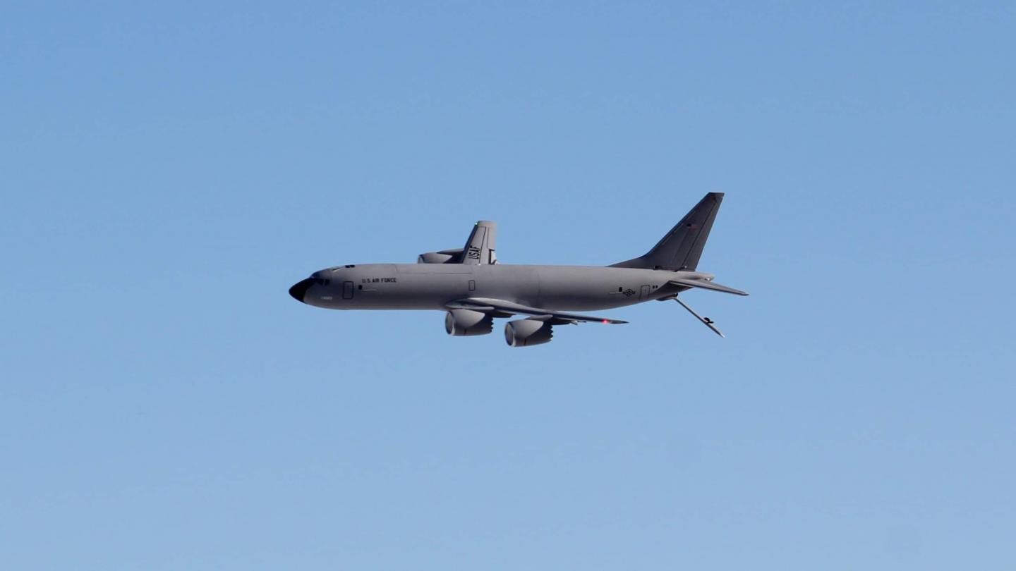

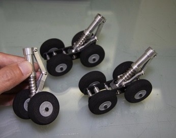

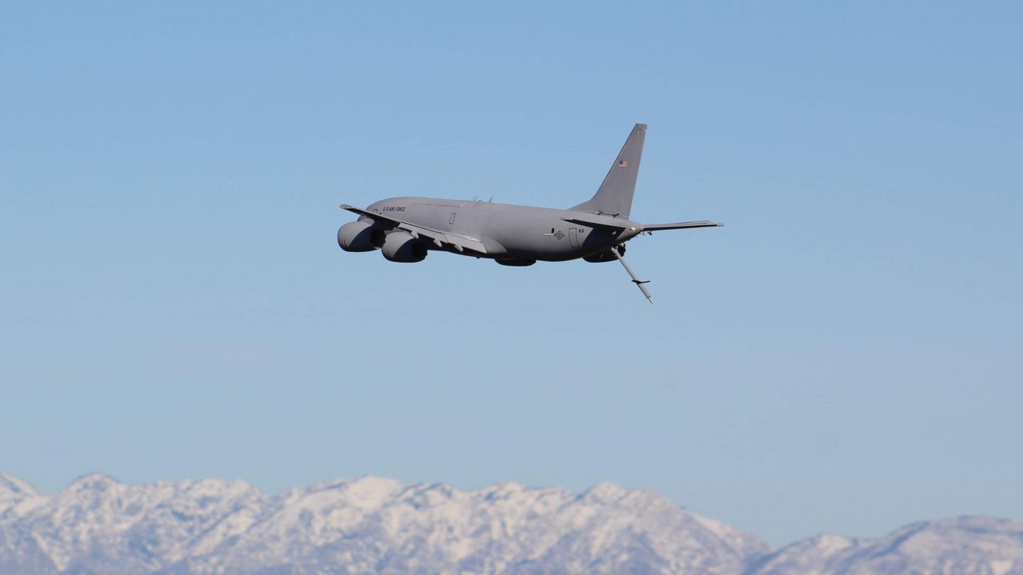

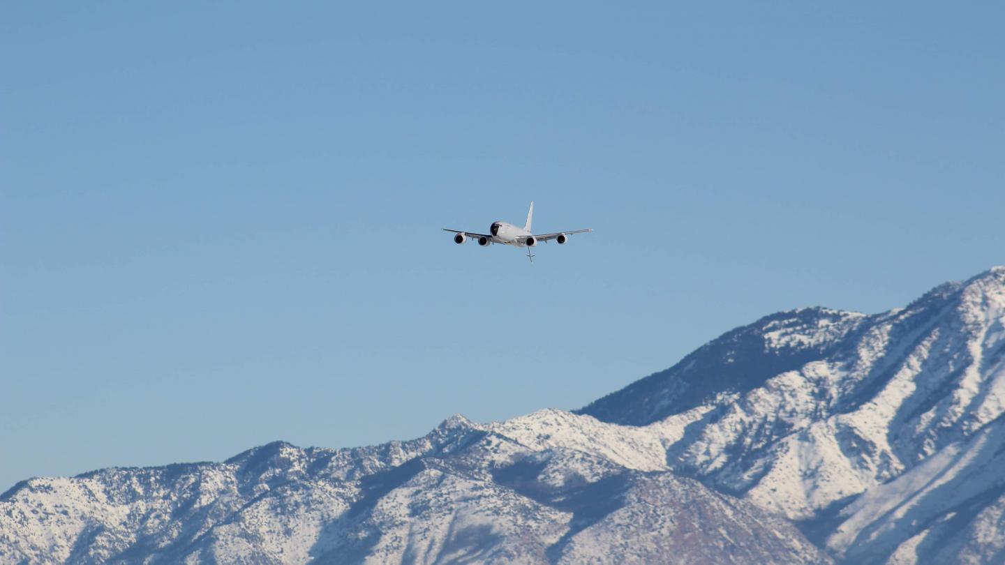

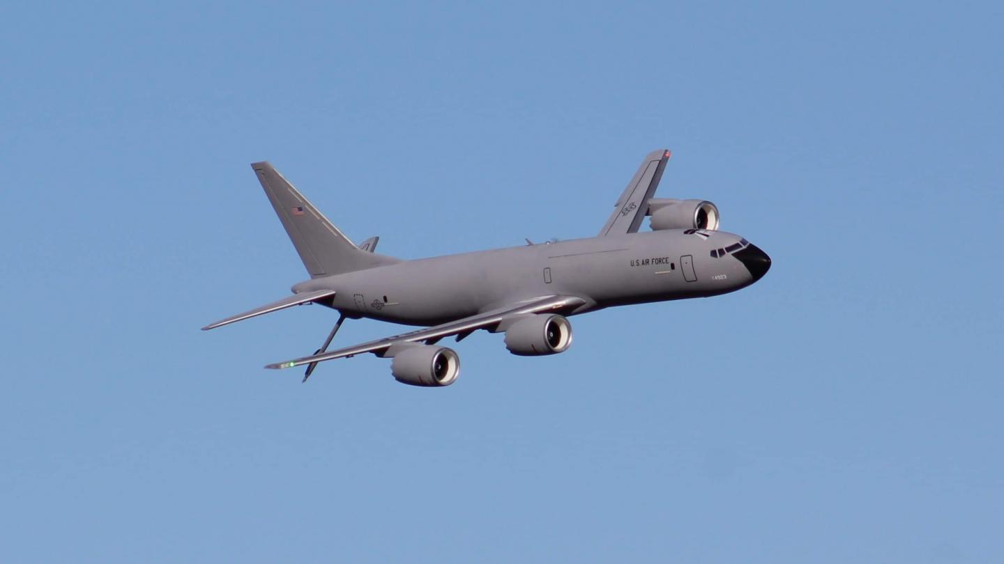

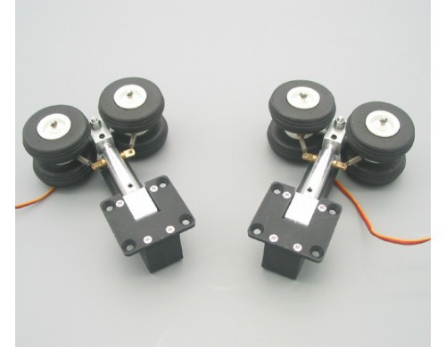

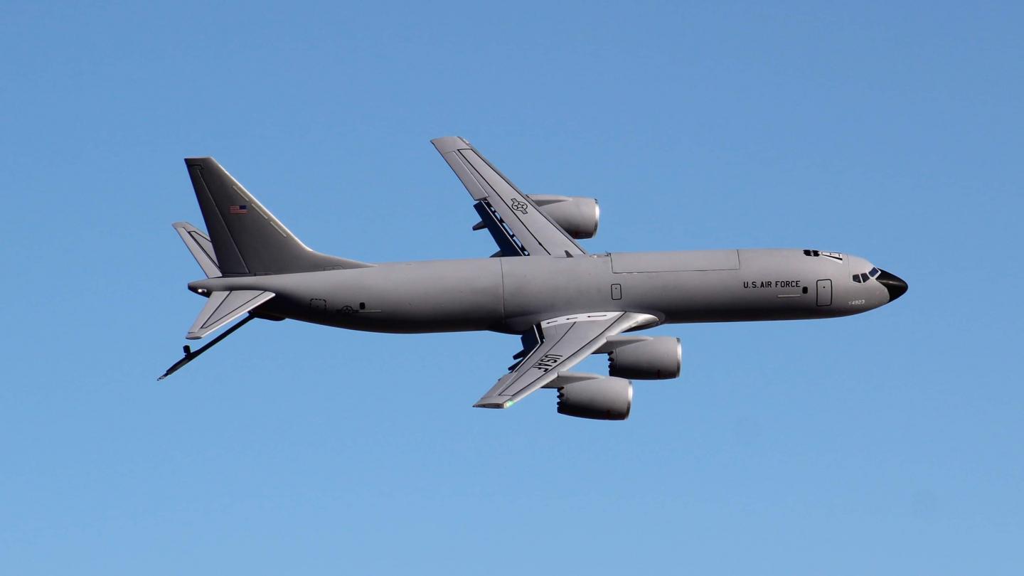

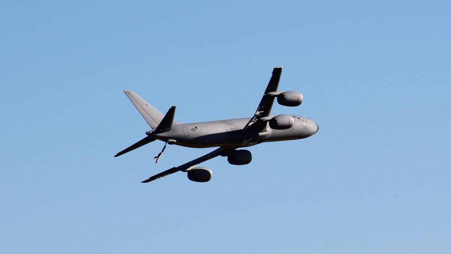

          More Mods on my AL37! I’ll be adding my double bogie struts to my KC-135 mod as soon as I get them from china. Also ill be modifying the Vertical to look like it should with pitot and all

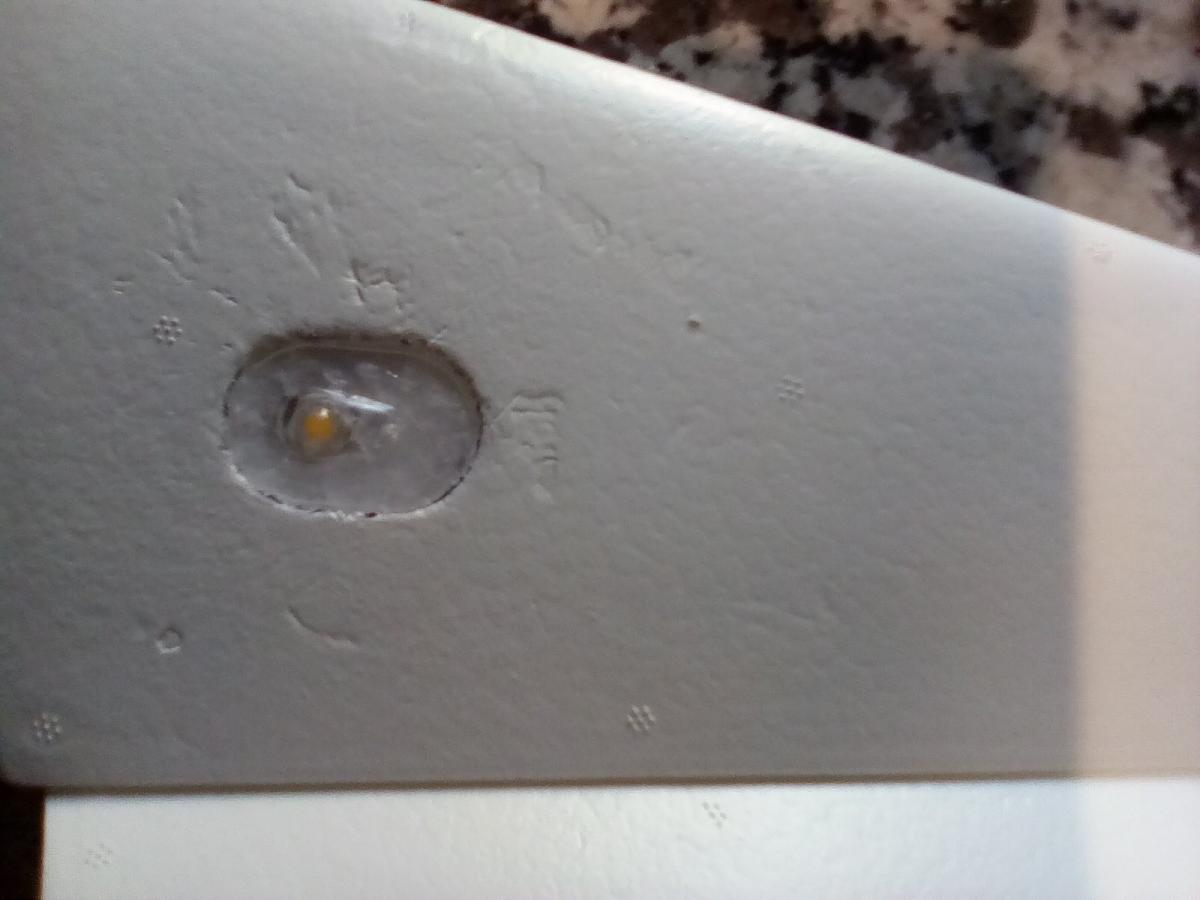

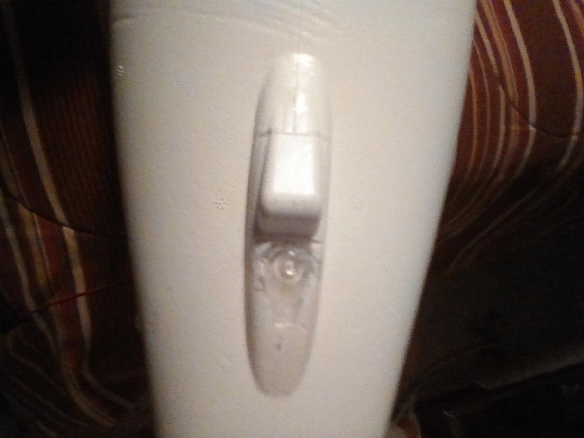

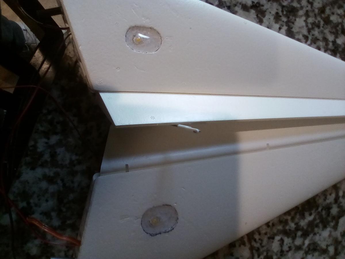

                AL 37 light mods

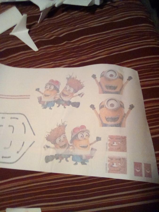

                  AL 37 Callie Graphics

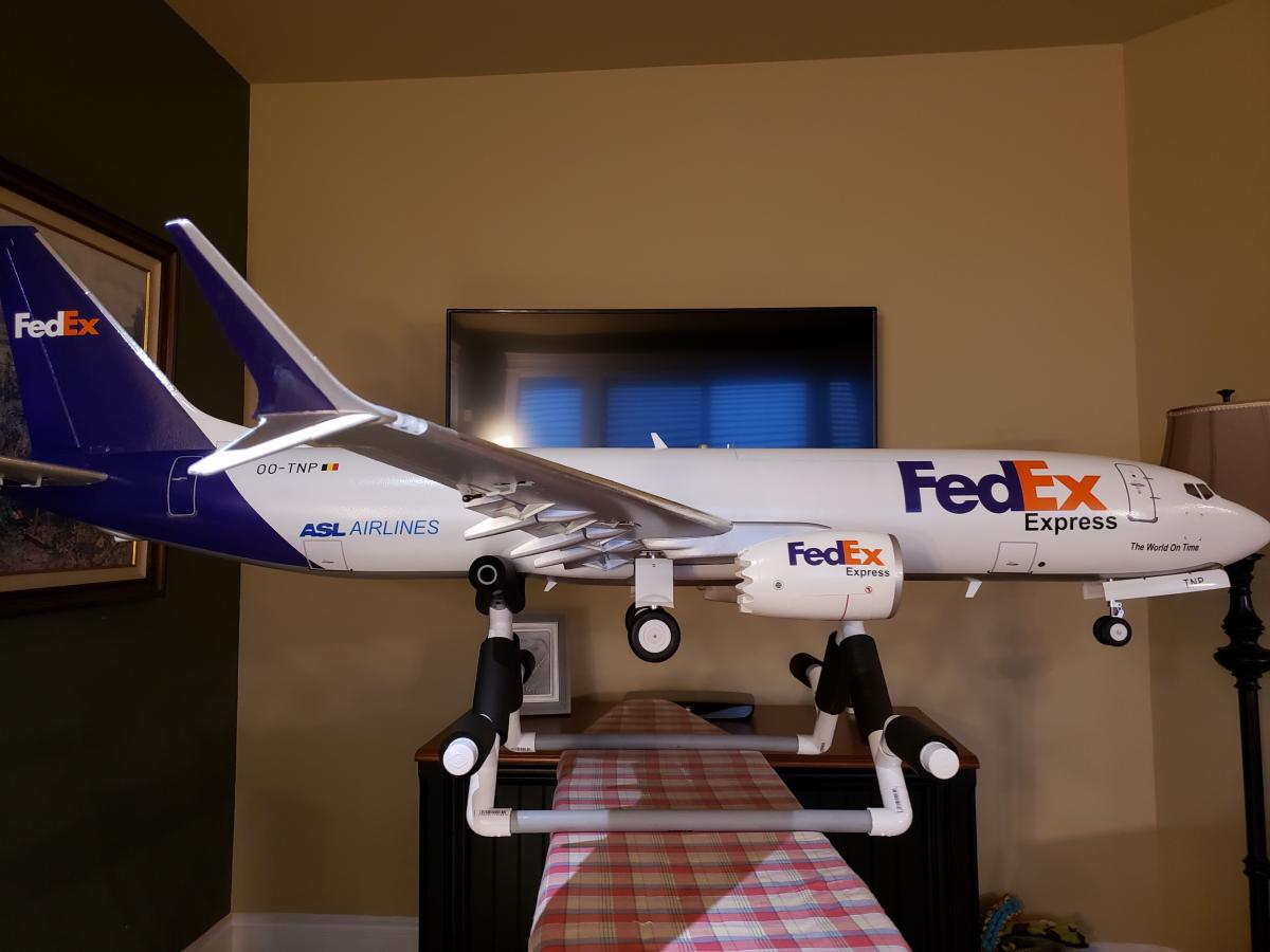

                                    I used Behr interior/exterior high gloss latex and it worked great. I was able to wet sand with 400 grit after 12 hours or so. Brushed it on being careful not to rebrush and create a lot of brush strokes. I used the latex paint as a primer to get rid of the paint texture of the factory paint. It worked well. Most of it is 3 coats wet sanded between each coat. It has two thin coats of water based Varathane gloss over the top. I still need to wet sand the Varathan and recoat. I tried spraying on a coat of Varathane and it was too thick and went on dry. The final coat of Varathane will be brushed on to fix the dulling by the sprayed on coat. The spraying just did not work well for me.
                                    Callie Graphics of course.

                                      That's outstanding great job, do you happen to know the name of the gray you used?

                                          4923crew, I sent you a private message about your excellent build of the Kc-135R. If interested in comparing info, as I am starting my KC-135R build, let me know...... walkerm45
