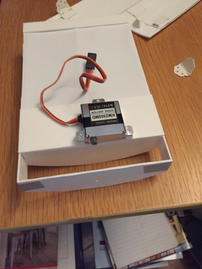

        If you can get the proper travel on the flaps and ailerons, it shouldn't matter what they look like. They may not even look like what mine looks like.
        Ok thank you i mounted right...

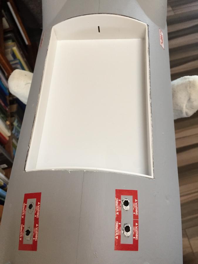

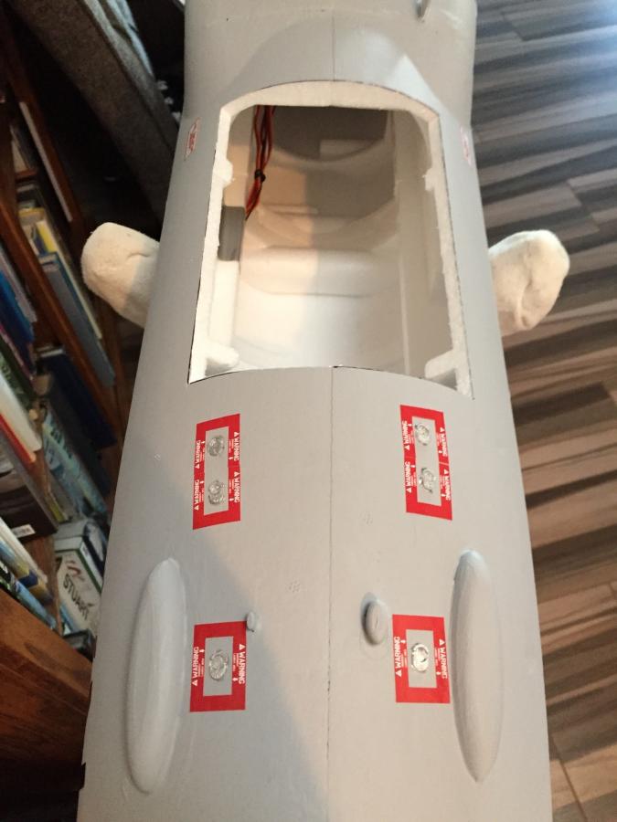

          OK I'm ready for the maiden tomorrow i have two options for lipos a FULLPOWER 6S 35 C 4200 and a TURNIGY GRAPHENE 5000 45C with weigh more and is bigger tan thee FUULPOWER...Any suggestions with picture where i can locate the lipo in a safe position for the correct CG in the direction of a little nose heavy.Also do i use exponential like 30 % on all channels except of course trootle and flaps...100% dual rates ? Thank you i'm really scare for tomorrow...Wheather sun with 5 km wind...

              With a plane this large, I wouldn't be worried about the added weight of the Graphene. I actually would welcome the added weight (it may aid in some stability in the wind) the Graphene would provide, as well as the added capacity compared to your other battery and likely better power output (likely improved voltage under load). There is plenty of room in the battery bay for the 5000mah 6S or larger capacity.
              I would not base your LiPo placement based on visualization within the battery compartment to achieve the proper CG. Instead, it is always best to check and confirm the actual CG with your fingers on the provided CG marks once the battery is in place. If the aircraft doesn't balance on the recommended CG, move the battery either forward or aft until you achieve balance on the CG. After a few flights at the recommended CG, then you can fine tune further if needed to personal preference of flight character.
              I don't own this aircraft, so others can chime in on their rates and expo . However, this aircraft will likely not be overly sensitive on the flight controls, so I wouldn't worry much about higher throws, and it will likely not need a lot of expo. Others can verify.

                  Go with the Graphene. I have the 5000 Turnigy Heavy Duty, 60-120C that I'll interchange with my Revolectrix 5000, 70C which weight slightly more. This plane will take a huge battery load (6000mah+). As for where to put your battery, everyone will have a slightly different position so seeing a picture isn't going to help you and you really shouldn't go by those pictures anyway. Use the CG marks already on the plane and put the battery wherever it needs to be to achieve that balance point (a little bit more forward if you want it to be slightly nose heavy). 30% expo is not excessive for a plane like this, but it depends on your experience level and personal preference. Most TXs allow for dual rates and some can give you triple rates. 100% is generally the max rate you should try but if you have 3-position switches for rates, 100% can be your middle rate and something lower for the low rate. Since it's been said that this plane has a very slow roll rate, you can also dial in a high rate of more than 100% if you want to do more spirited, passenger puking type of flying. Start with medium or low rates on everything and change each one as you get a feel for it in flight. I have each axis on a separate switch so I can change the rate/expo for each one as it suits me.

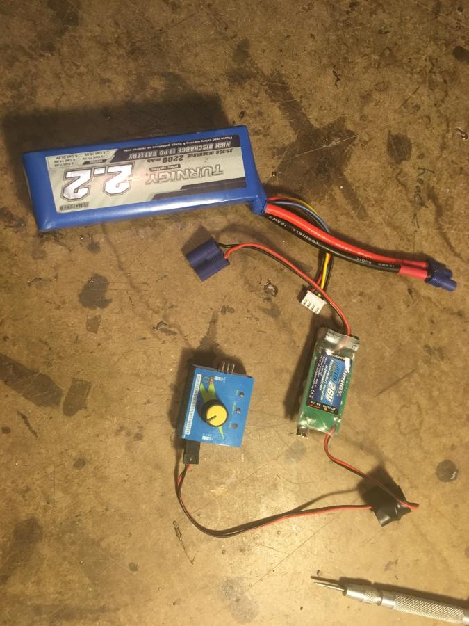

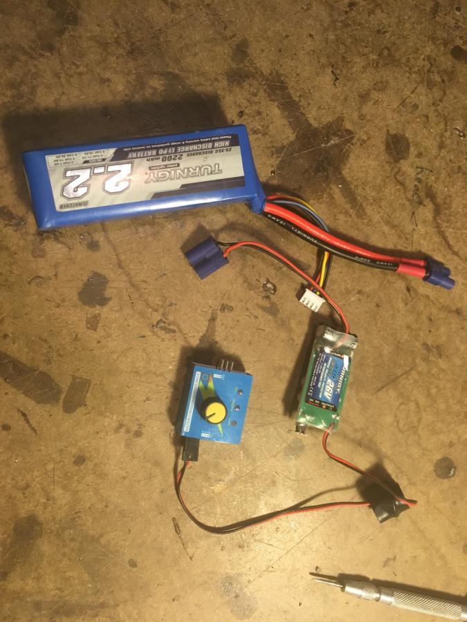

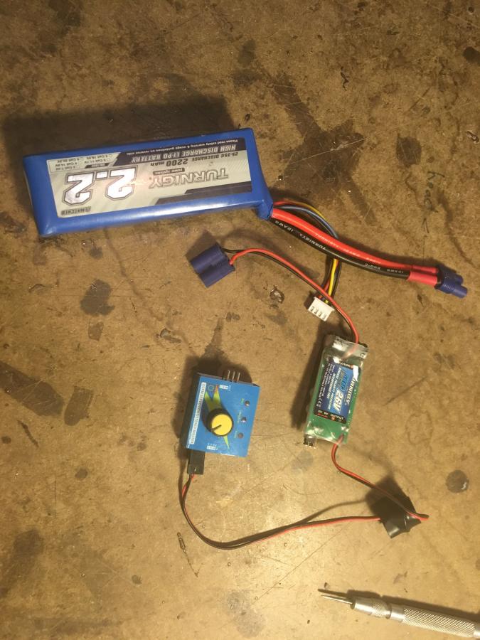

                                  I have what may be an odd question. I have been asked to static display my AL37 at a show. I thought it would be neat to have the lights on. So my question is, will it hurt the ESCs or the servos to have the plane sit for an hour or two with a battery plugged in so the lights are on?
                                  JB
                                    • 8835
                                    #1257
                                    JB
                                    Probably not but just to be safe, I would get an external BEC that puts out 5-6v, plug that into the RX and power the BEC with a 2 or 3 cell LiPo. That way, there's no chance of any juice going into the ESCs and no chance of accidental engine power up. This is my set up for powering up RXs for binding before installing into a plane and also to power a servo tester.

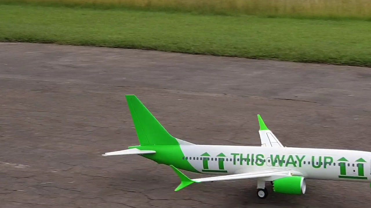

                                      Freewing AL37 flying in South Africa at IRF (Irene Radio Flyers)
                                      • BraPapaD
                                        • Feb 2020
                                        • 14
                                        #1259
                                        Pierre Du Plessis (Flysafair Livery) Daniel Ralefeta (Kulula Livery)

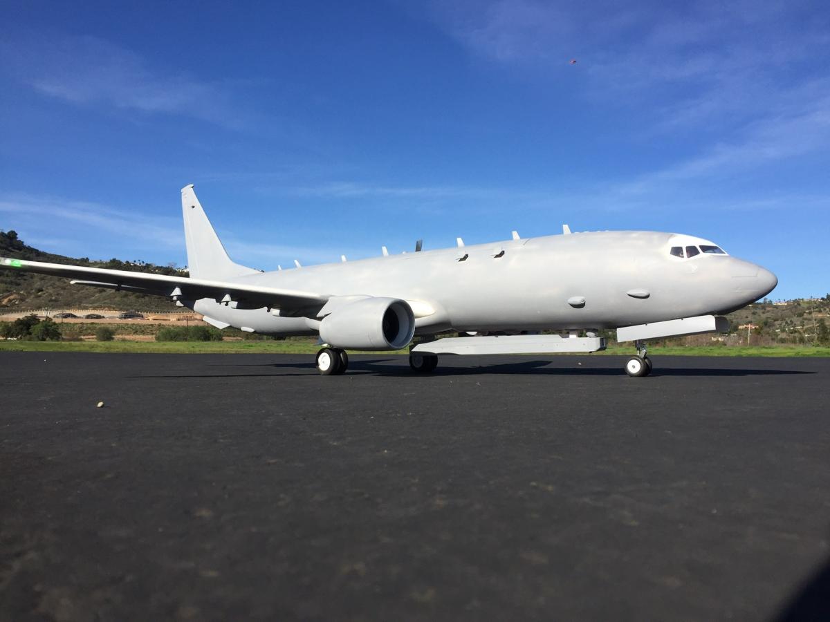

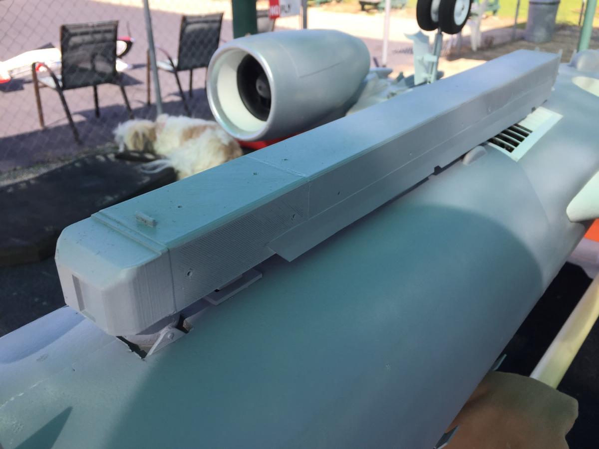

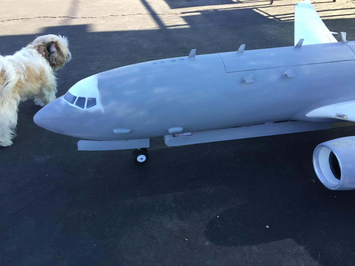

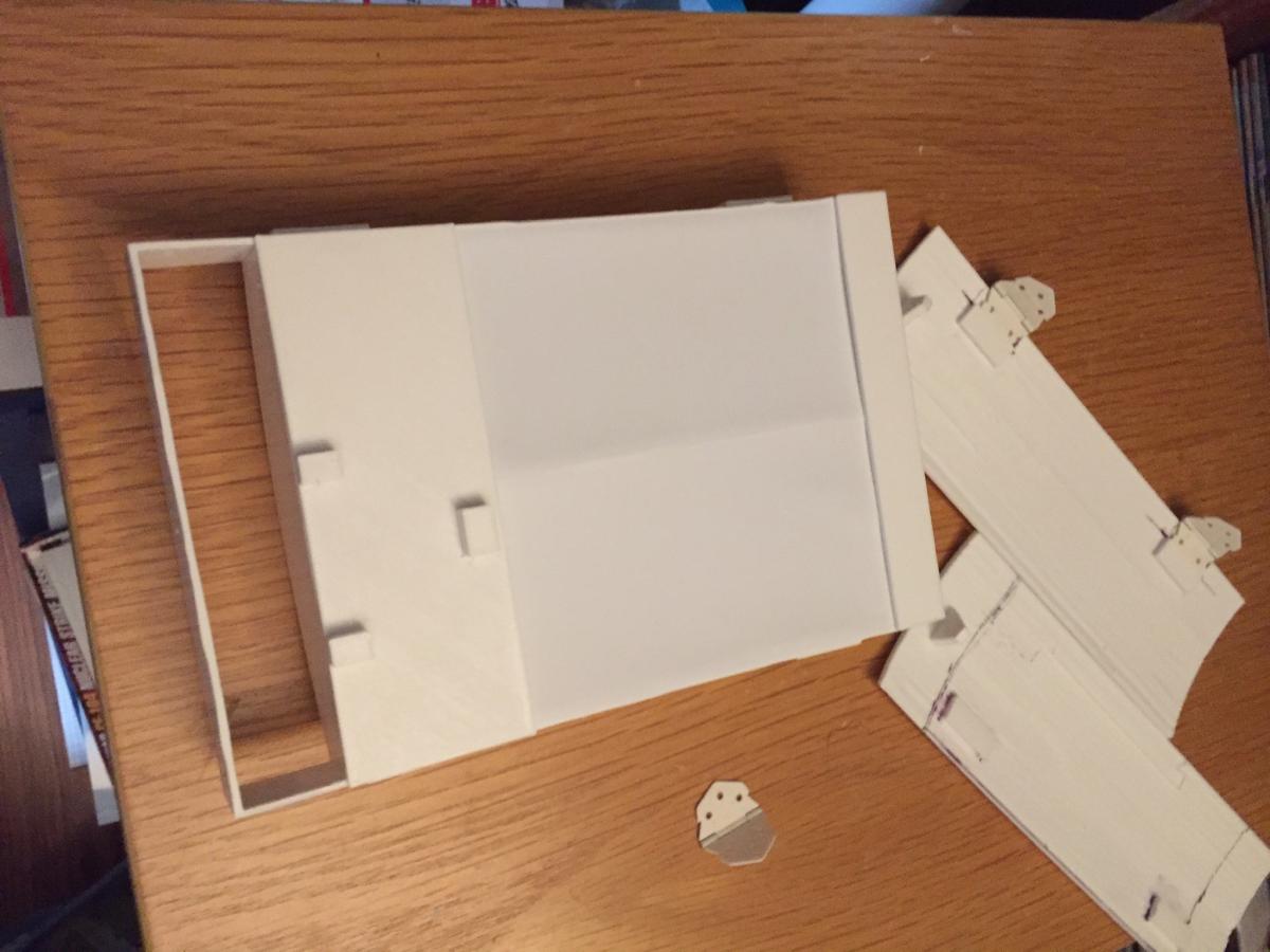

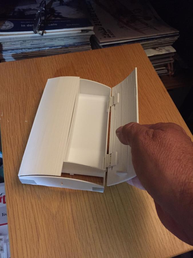

                                          P-8 Poseidon conversion. Continued.
