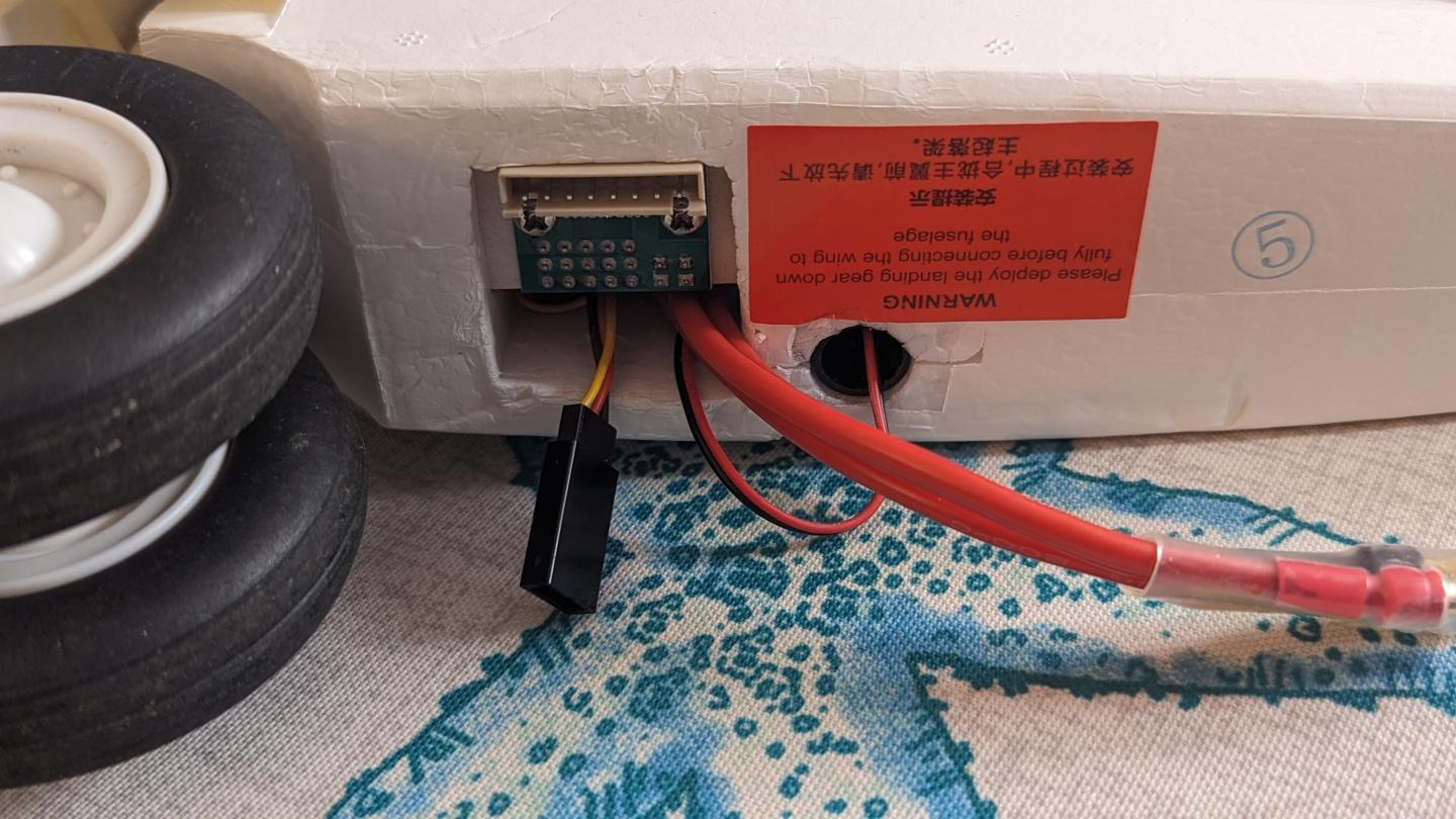

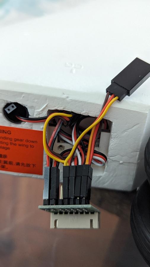

                          Simple fix for lowering main gears to put wings on,
                          I unplugged the gear plug off port 4 on board in wing and put a rc Y connector on port 4(male side) then plugged up the gear and let the other end dangle out of hole.

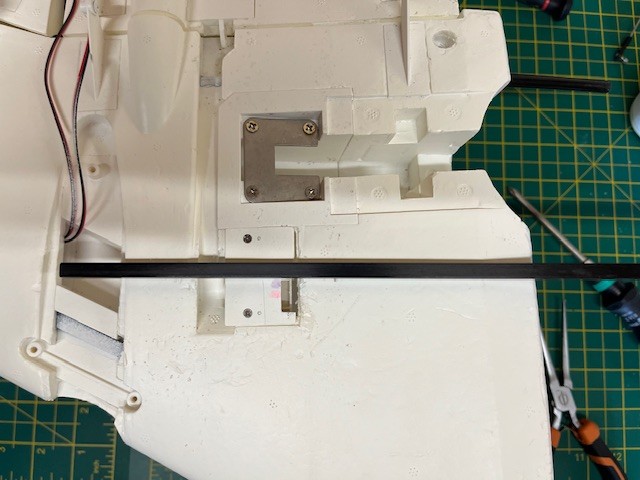

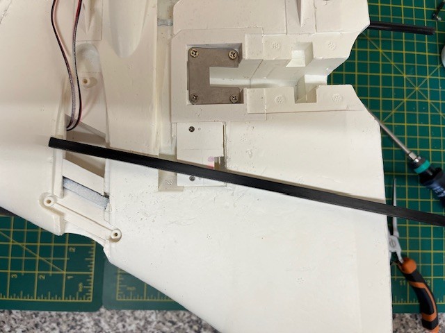

                              If you want to avoid top wing skin cracks that will happen after a lot of flying, remove the motor nacelles from the wing so you can get to the wiring channels in the wing. Flip the wing over so the top wing skin is on the work surface. Cut as long a piece of about 1/4 inch square carbon rod that you can fit into the length of the wiring channel and epoxy the rod against the inside of the top wing skin. Use 5 min epoxy because you will need to press the rod against the top wing skin while it cures.
                              If you elect not doing this, after a lot of flights, she will look like this…..

                              Hi GliderGuy
                              the carbon rod you recommend to put in the cable channel, did you put it parallel to the wing spar tube, or at an angle in the channel? See attached photos of how i see the tube fitting in the channel.
                              Cheer,
                              SR

                                      Originally posted by Scots_rubz
                                      Hi GliderGuy
                                      Cheer,
                                      SR
                                      I did no cutting or drilling…,simply followed the wiring channel. It is thusly angled.
                                      You’ve got the right idea. Make sure to put top skin against the work surface and press down on both ends of the rod while the epoxy sets.
                                      This makes a HUGE difference in reducing top skin stress cracking over time.

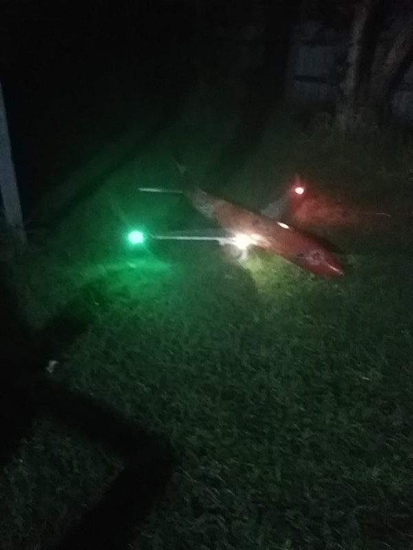

                                          #2380
                                          Just felt the need Click image for larger version
