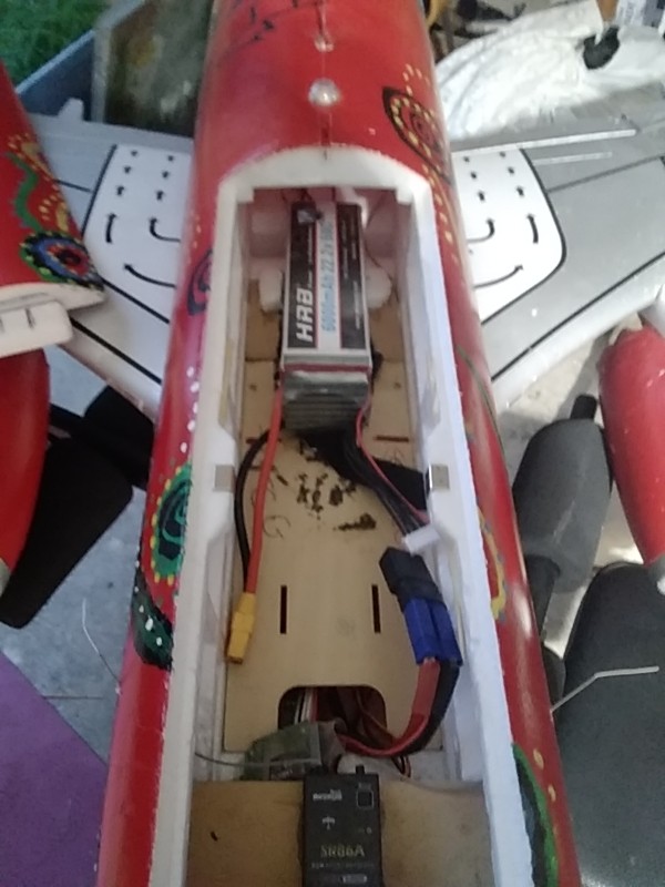

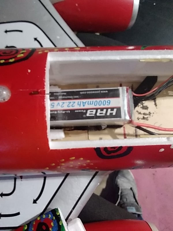

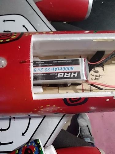

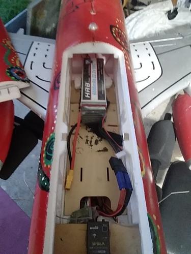

    More like 3 inches i added wood at back,, flys well and is on fact cg.. i asked questions also b4 first flight u can c extra wood at back Click image for larger version

    Thank you very much. It's more or less the same as I expected, I'm asking because it swings from side to side when takeoff, I thought it was too heavy for the tail...

      U need as much rudder gyro as u can watch the vids they nearly all do that

                            Many ways im sure... mine was painted first ,, not enuf research first.. but i used a soldering iron to put (Melt) small groove, around 6 inches long on the to join and epoy in place... noo filler req jjust bit more red paint u can c it in batt placemen t pic 2381
