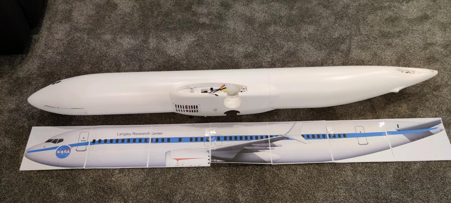

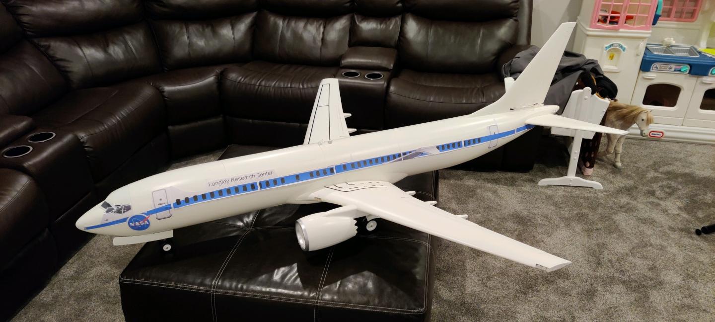

                              #814
                              I printed out my graphics today on plain paper and taped them to the plane to prove to myself that they will fit as I had planned. Much cheaper than vinyl and ink and easier to redo. fortunately it all lined up very nicely. I was working of of drawings of the real plane and I can conform what you probably already know, the model is extremely true to scale!Click image for larger version
