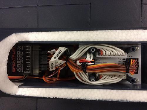

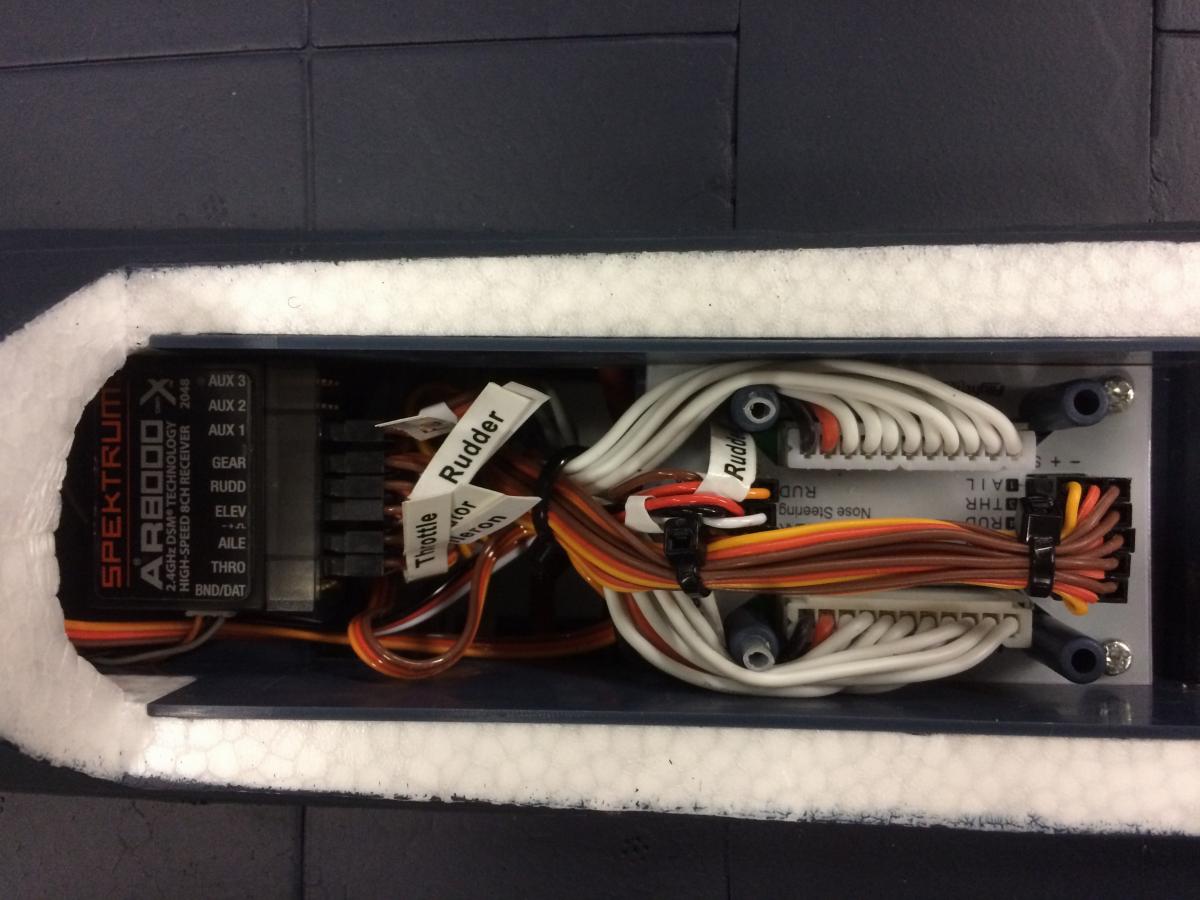

          • Mine cleared the hatch mounted toward the rear of the plastic ledge.

            • Looks good Charlie. There are several good options for mounting the RX in this plane. Underneath the Fuselage PCB is also a good choice, but less accessible there.
              You mounted yours flat at the flat edge piece where as I mounted mine a bit further back on the angled down piece where you have yours is why mine needed a bit of foam removal to allow the hatch cover to seat better. I wanted to leave as much of that open area there accessible to be able to get to the sound speaker connections mounted below it all mounted in the belly as well as the wing and battery connection wires that are fed through the left and right openings there on the sides of the fuselage.
