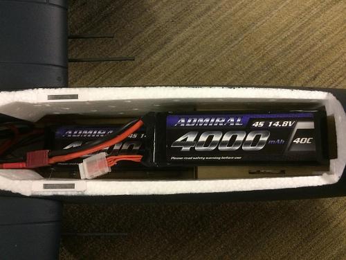

I've been in Gatlingburg the last two days with my grand-babies so I had to fly my UMX P-47 to keep my year of daily flying going so when I got home I flew a B-17 and Corsair to get myself dialed in...then I put two new Admiral 4000s in the TigerCat and taxied out to the runway. It's a nice 62 with light cloud cover 5mph winds straight down the runway, after preflight checks I throttled up with no flaps and took off with a nice run-out and scale climb.
After a couple circuits to trim I played around with a flew rolls and loops, then brought it down with about 10% throttle and half flaps to a perfect landing. It was like I had flown this plane for years, very predictable, very responsive with no surprises.
I had the timer set for 5:00 and had exactly 75% left on both batteries, I think 7:00 would be safe for scale flying. I got in a total of six flights today and found that I like the no-flap takeoff and half-flap landing the best, I think this is my new favorite flier and will be picking up another for sure.

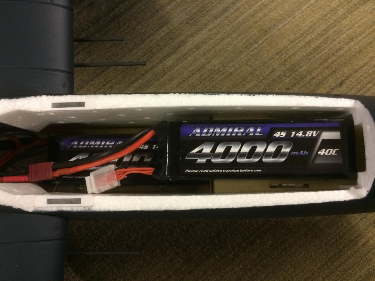

My CG is set to 71mm with the rear battery all the way forward and the front even with the front of the cockpit cavity.
