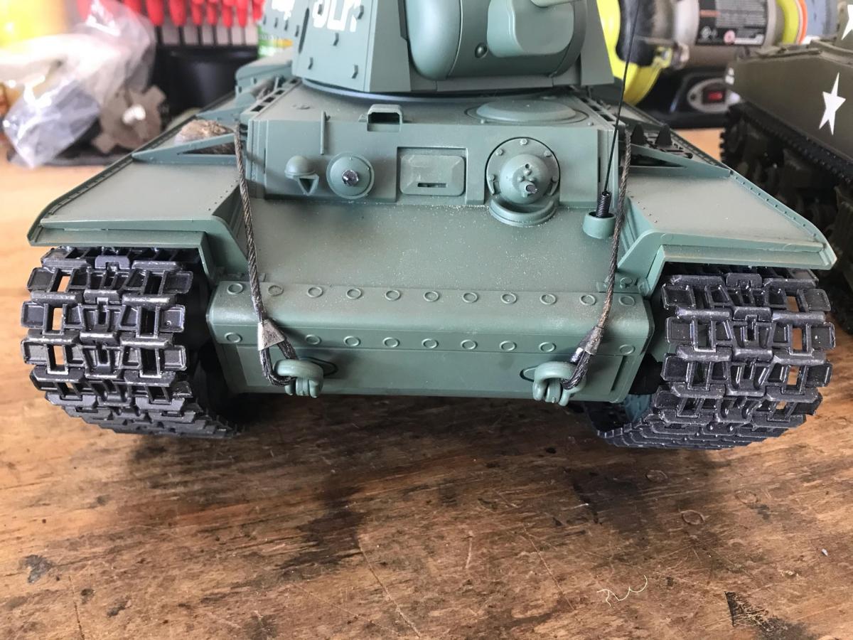

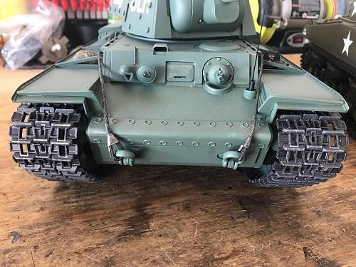

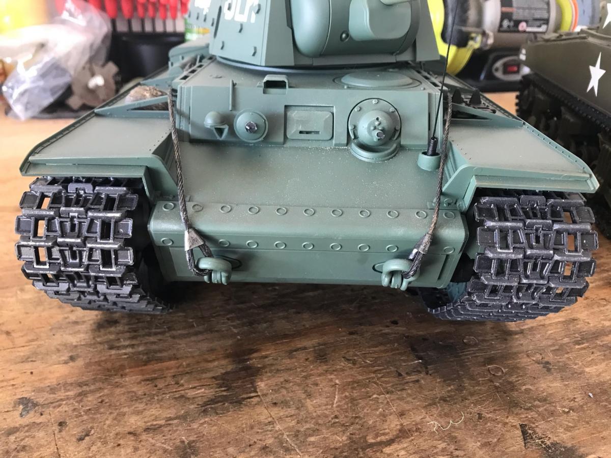

                                    Originally posted by mshagg
                                    What's the go for getting a durable painted finish on the metal tracks? Or is it just one of those things you have to accept will need touching up over time?
                                    I'm thinking some acrylic shot out of an airbrush followed with a few coats of clear to protect the finish?
                                    I Haven't weathered my tracks at all, I just cleaned them with brake parts cleaner, then painted with satin black Rustoleum 2X (paint + primer). The paint is wearing a little bit in the dirt, but that's what I wanted, a natural wear effect.

                                      Those tracks look nice that way. I was considering using some gun blue on mine.

                                        I just washed them with dawn dishsoap and super hot water, dried with a hairdrier and used Perma-blue on mine. you even get a nice soft rust patina on them and then rinsed them really well with super hot water and the hairdrier again.. I was actually surprised there was iron content in the tracks to blue haha.

                                          I'm going to try the perma blue on a set as well.
