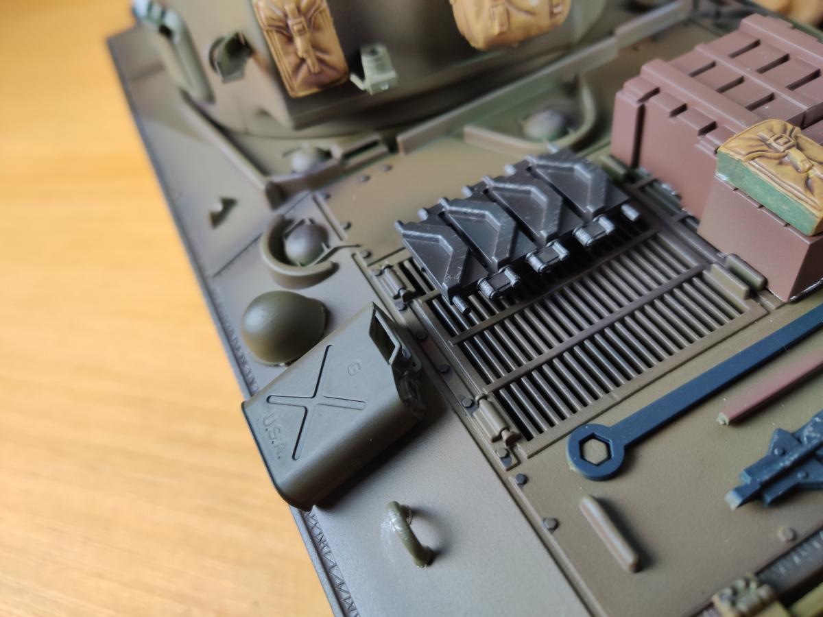

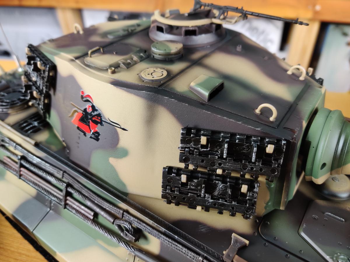

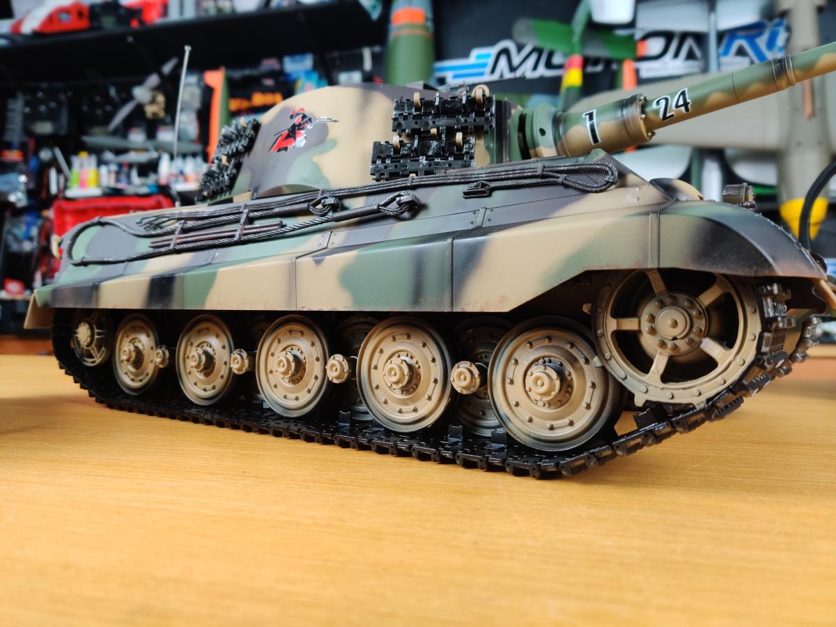

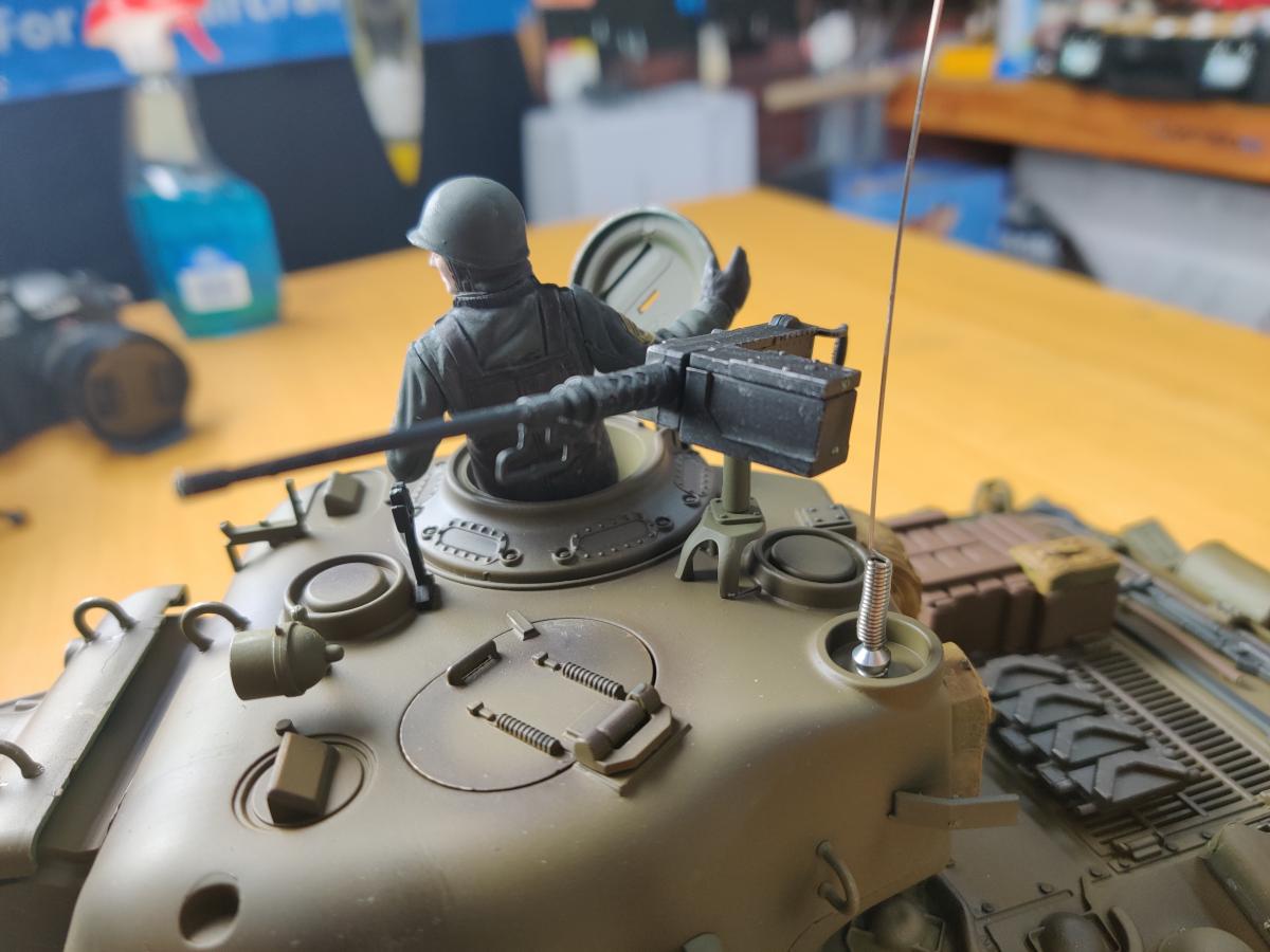

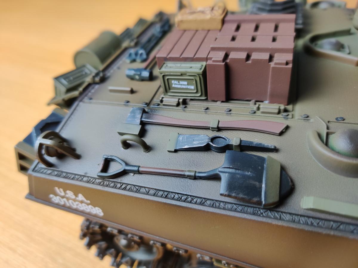

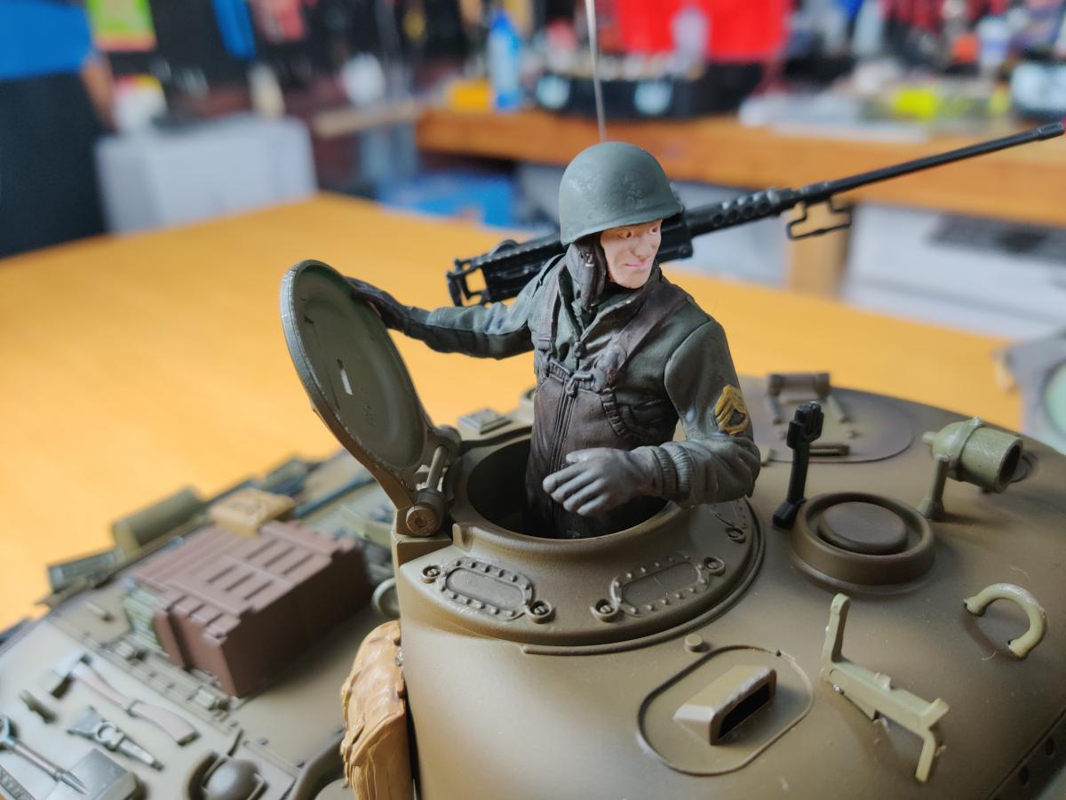

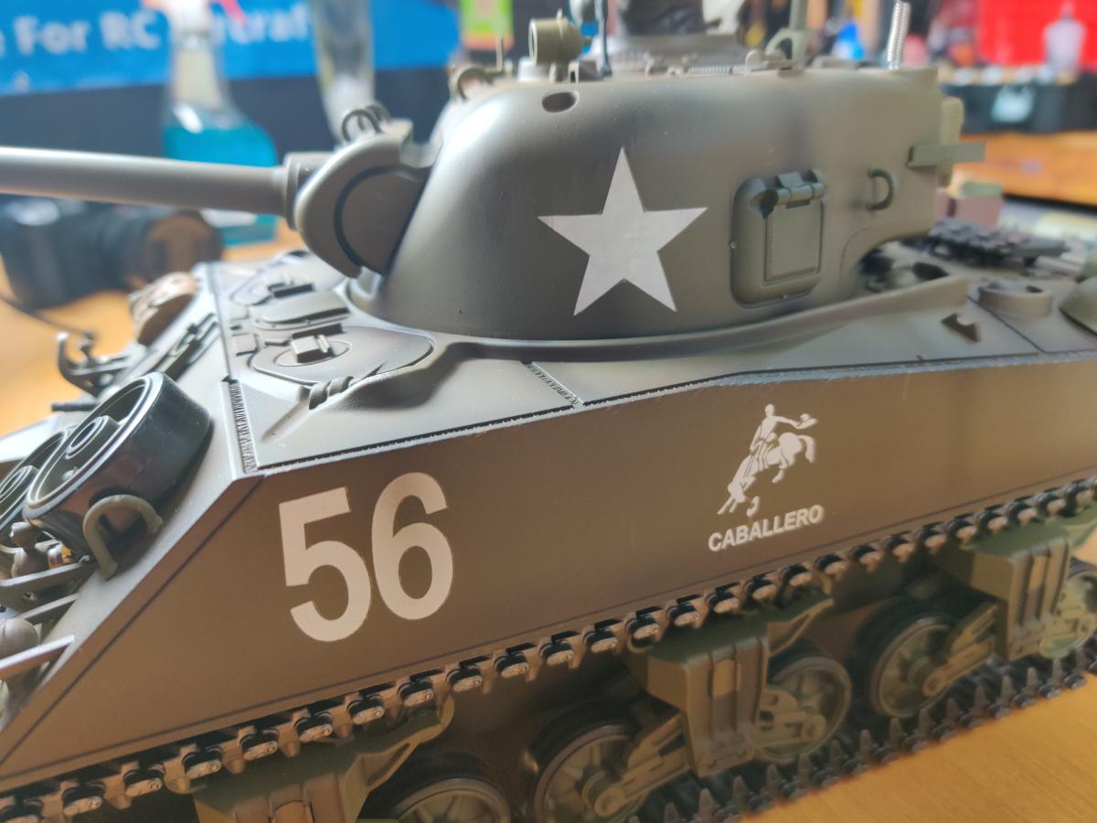

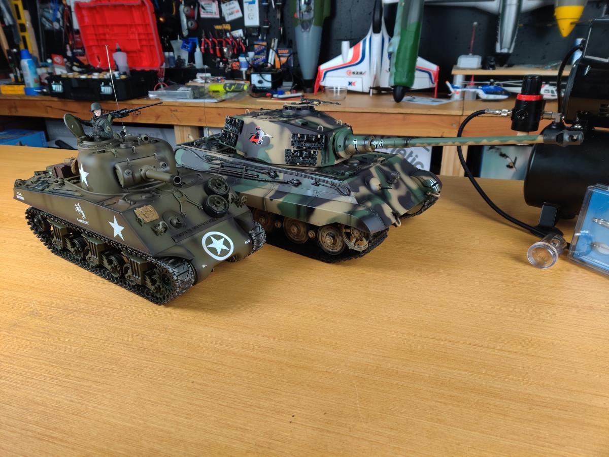

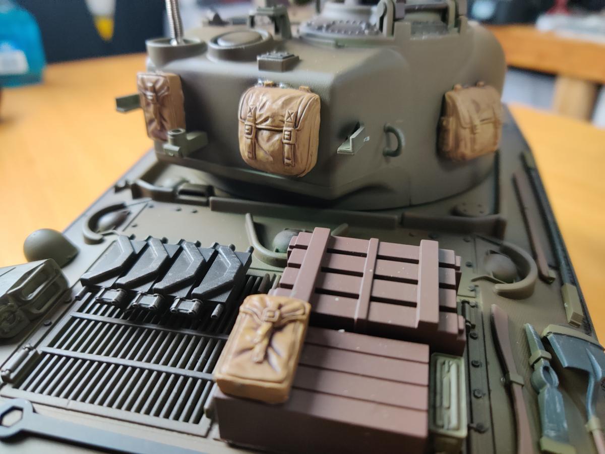

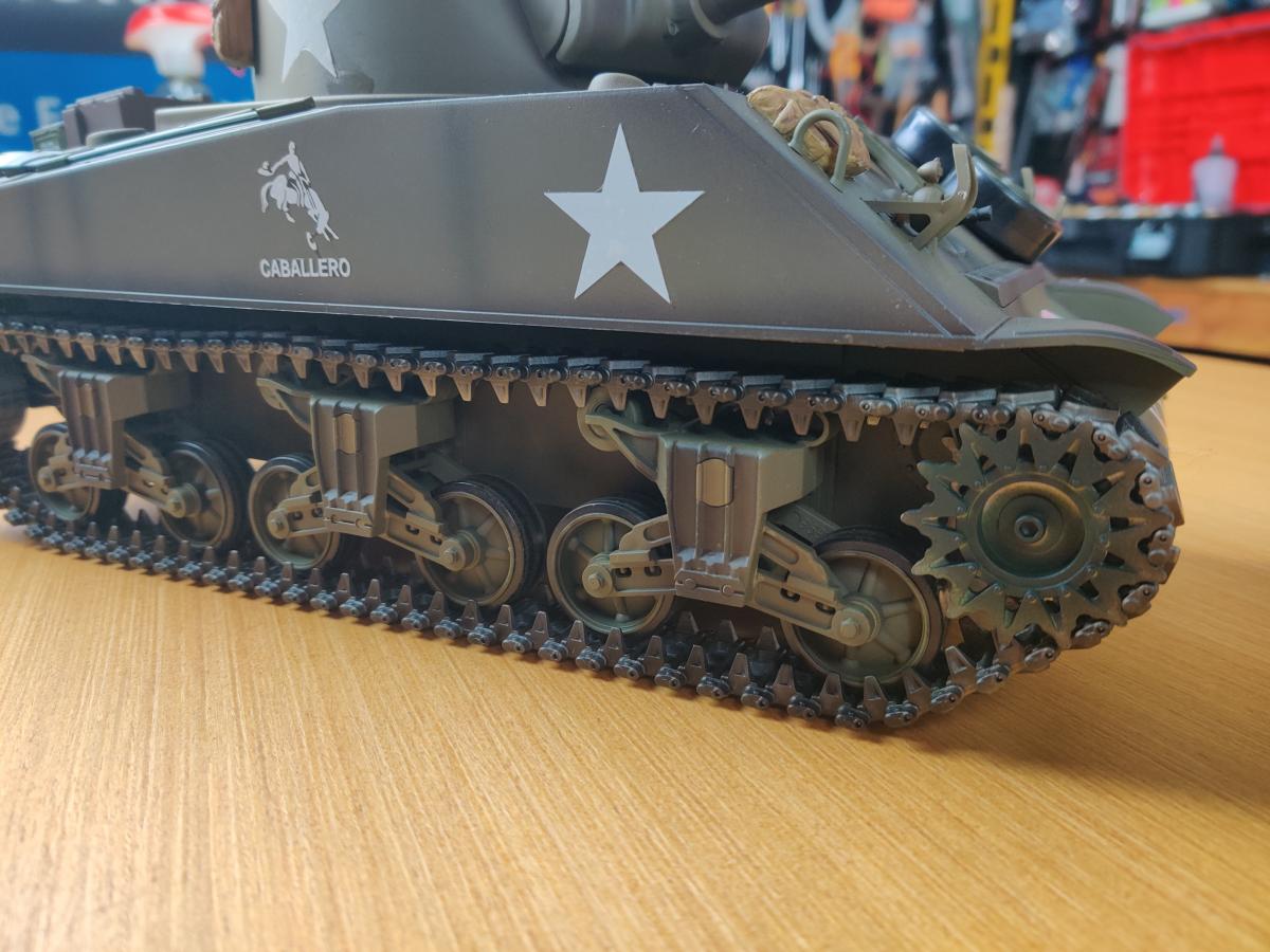

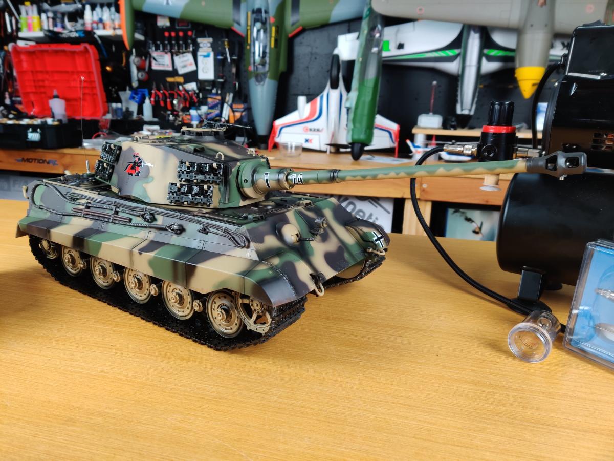

          Had a ton of fun this weekend weathering and detail the Pro versions of the Sherman and King Tiger! Paint those metal wheels and tracks makes them pop so much.
          We airbrushed, dry brushed, washed, sponged and just had a blast bring out some more detail on these babies
          Click image for larger version  Name:	IMG_20200301_103133.jpg Views:	0 Size:	163.8 KB ID:	239078

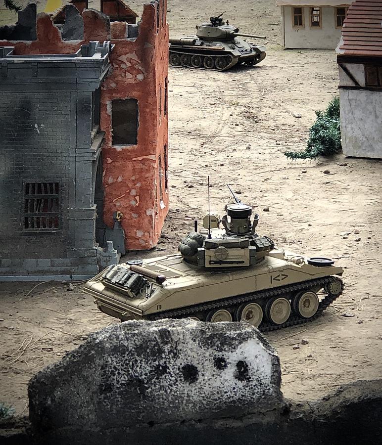

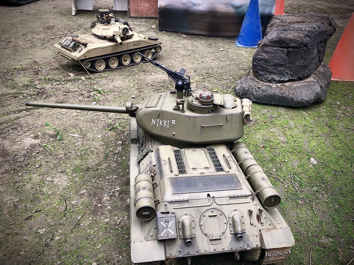

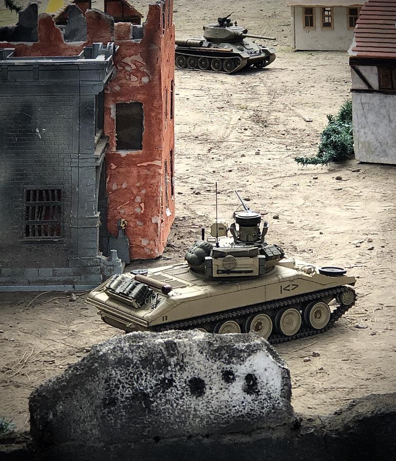

              From a recent IR battle day. T34 vs M551 Sheridan.

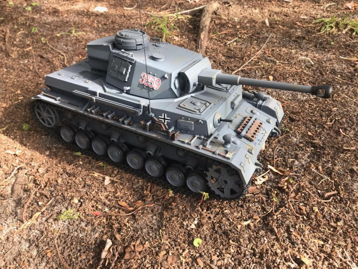

                        Heng Long Panzer IV , modified antenna mount to out it where it is supposed to go, some detail work and subtle weathering followed by Tamiya matte clear.

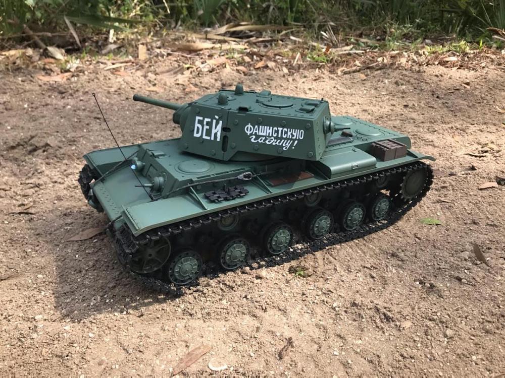

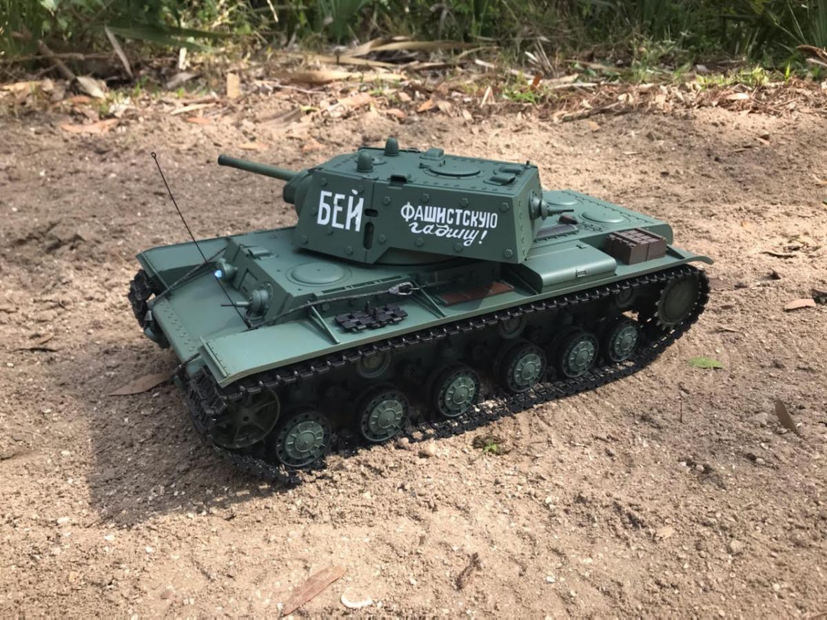

                          Heng Long KV-1 "PRO" version. Tracks painted with satin black rustoleum 2 in with primer (works pretty good on these), drive sprockets and idlers painted Tamiya JA Green (pretty close match). Light weathering with Tamiya Weathering Master products, followed by matte clear. Click image for larger version

                            What's the go for getting a durable painted finish on the metal tracks? Or is it just one of those things you have to accept will need touching up over time?
                            I'm thinking some acrylic shot out of an airbrush followed with a few coats of clear to protect the finish?
                              Paint on tracks will ALWAYS wear off rather fast if you drive the tank moderately outdoors in dirt sand or light mud. For metal tracks what last longer is to use a blackening agent like “gun blue”. This actually puts a fine layer of dark gray/black rust on them which is much more resistant to wearing off as fast as paint.
                              I have been using “gun blue” to darken metal tracks for a rather long time with no ill effects. It does wear eventually but unlike paint it leaves nice black highlights to the nooks and crannies of the track which when combined with a coat of dust and some light dry mud just heightens the realism and overall weathering effect.

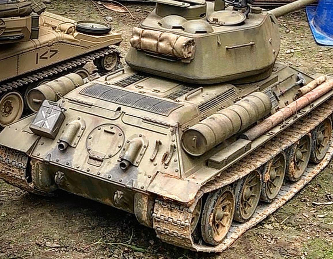

ID:	239652 Heng Long T34-85 with “painted” on and natural weathering mixing to give it that field used look.

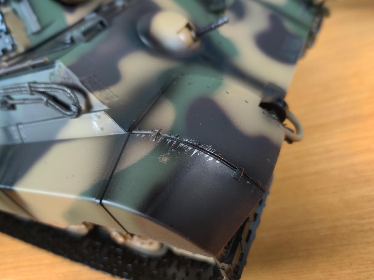

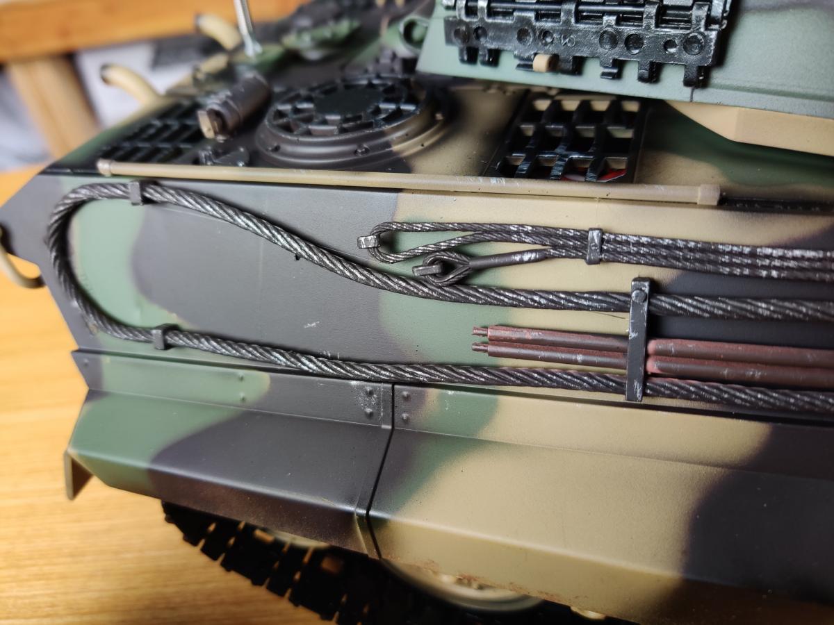

                                          Started some light weathering on the 'Tiger Royale'..!
