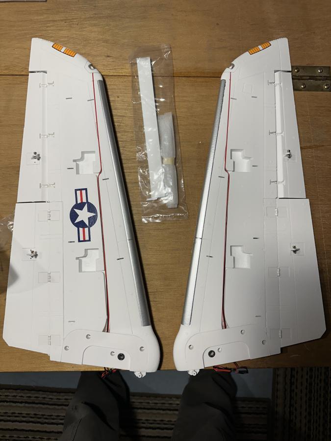

                            #233
                            Photo of undersides of the V2 wings, something that has not been clearly shown. This also explains why one servo has to be reversed. The little package in the middle contains the Longer pushrods and wire channel tape.
