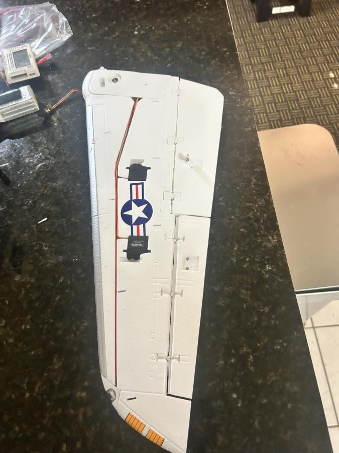

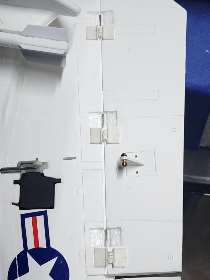

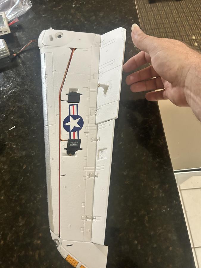

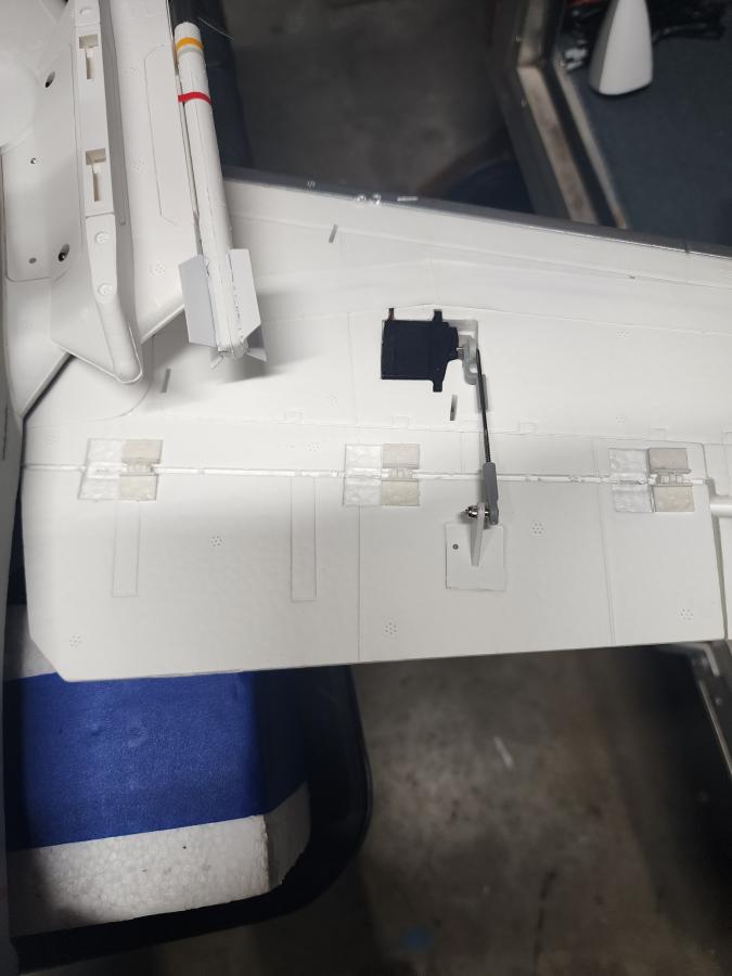

      • After reading a few posts about the flap hinges, I decided to check mine out of an abundance of caution. I discovered that the right wing had very little glue on the hinges, and the left wing had a tad bit more, but all the hinges were relatively easy to pop off. This is definitely something you need to check if you own this plane. I haven't flown it yet, but I am glad I decided to check those hinges. Waiting to upgrade the swing-wing push rods.
        • Originally posted by rlcamden View Post
          Pretty much as expected, the hinges on my example pulled off very easily. In fact they just 'popped off' with a little force with a blade underneath each of them. As I think I mentioned before, it's something I've learned to do with all my EPO models when they are new.

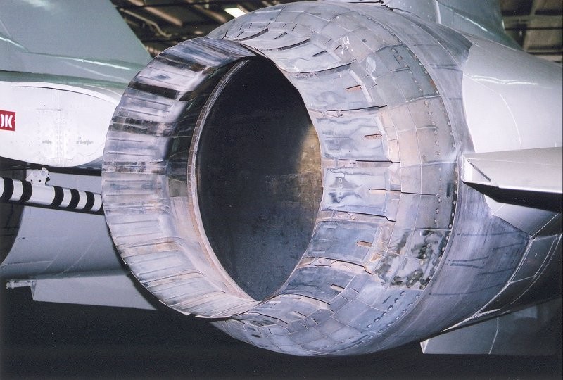

            • The stock nozzles on this F-14A are incorrect, they just look like scaled down parts from Freewing's twin 80mm F-16D. The nozzles on the A version were quite different - see image below .
              Here is a STL file to 3DP a (more or less) correct nozzle. Exit diameter is unchanged from stock.
              Here is a (more or less) correct nozzle for the twin 64mm Freewing F-14A. (Slight deviation from scale was needed to get the exit area correct for the fan size.)Print light.The file "Nozzle" is simply to replace the entire stock nozzle(foam and plastic skin). Cut off the existing nozzle and glue this in its place.IF you can peel off the plastic skin without damaging the foam underneath, use the guide to trim the foam stub to length, and mount the "noz c file" over the stub. This makes it slightly lighter and a bit easier to align. It is necessary to trim the stub to accommodate the different shape of the F-14A nozzle.The petals are very thin and some slicers may not slice them well. The "A" nozzle is a bit more robust than the noz_c

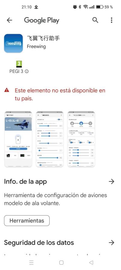

                      • How can I solve this problem? I can't download the app

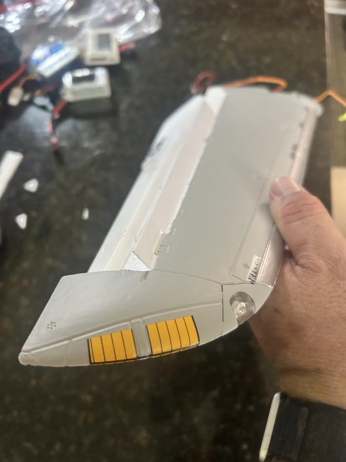

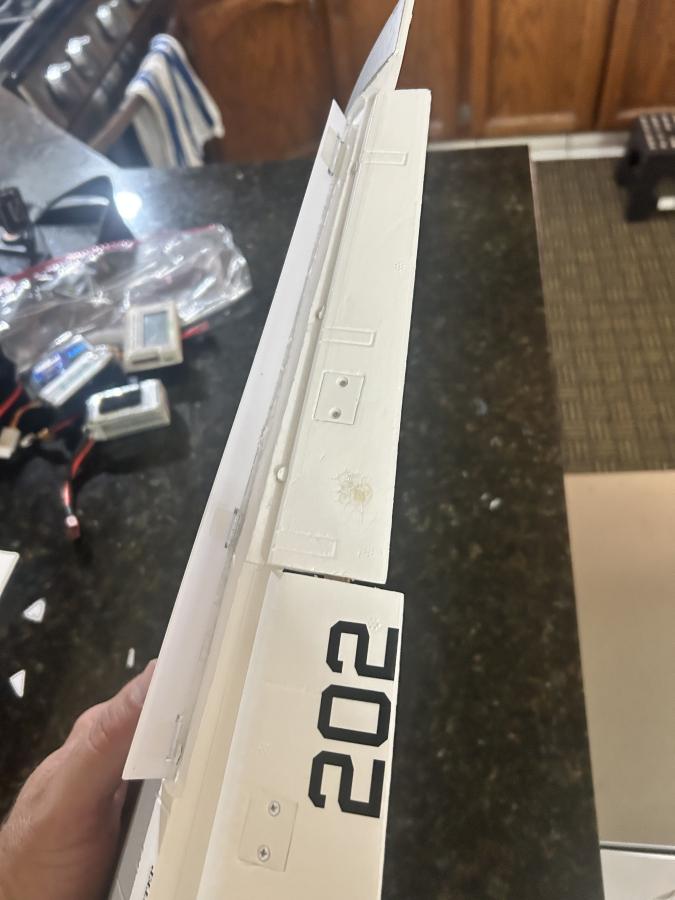

                            • Started working on my spoiler and full span flap setup.
                              I’m about half way done on first wing. Waiting on Amazon right now.
                              Gravy

                                • Getting close to finishing up first wing. Works as good as the 80 mm one I setup.
                                  Gravy
