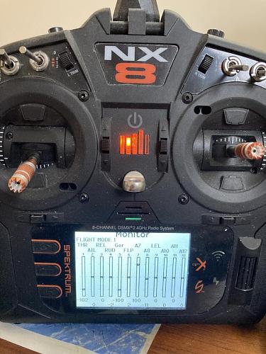

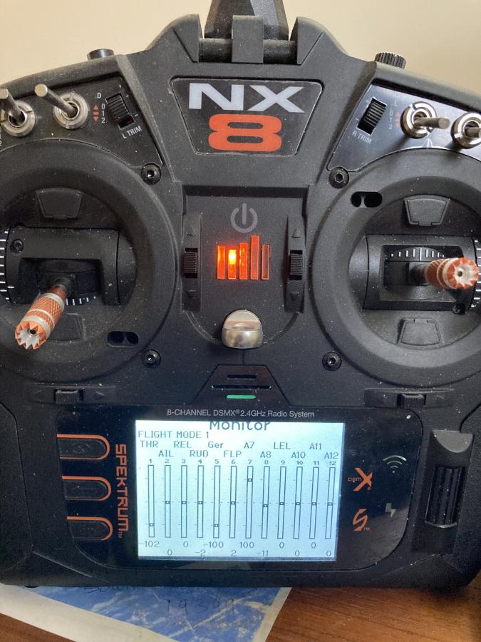

          20 if the NX8 has been updated or came as a plus.
          Using the stock gyro a 9ch receiver is needed for all the functions, basic 6, wing sweep, reverse and gyro.
          My NX8, showing 12 channels set up. If you set tail type to "tailerons" or "2 elevators" it defaults the left elevator to Ch9.

            Yes, kallend, I know all this stuff about 20 channels. My point to Tcwoodie was that if he didn't use a RX with enough physical ports, he can't do what he wants to do. That is, gyro mode and reverse (with these ESCs) require to be plugged into a physical port, thus, he needs a 9 to 10 channel RX. If he uses only an 8-ch RX, there is no ch-9 port to plug into no matter how many of those upper channels the TX and RX talks to or listens to. That's why I finally answered his question by suggesting the Lemon 10-ch or Spektrum 10-ch, in order to have the physical port to plug into.
