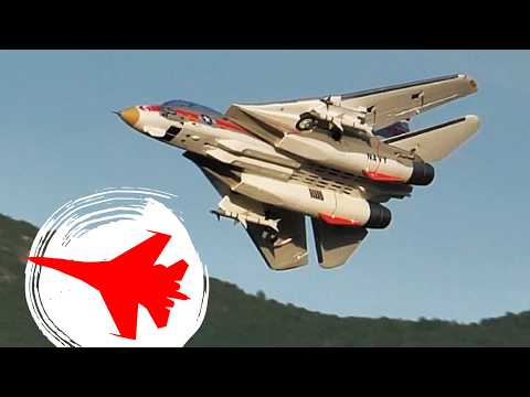

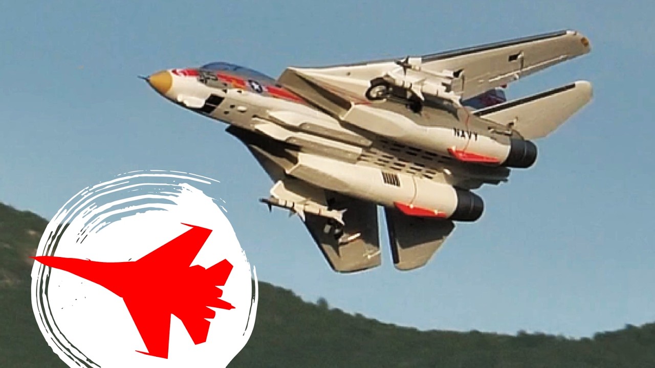

          Jandro , those landings are extremely good. I will try and copy your style. What sort of throttle percentage have you got on just prior to the flare?
          • Airguardian
            Post Stall Svengali
            • Aug 2020
            • 1686
            • Catalonia
            #285
            Thanks!
            At least the first ones I highlighted at the beginning of the video were... there were a few others that were 'less than stellar', but I'm still adjusting and getting used to the cat, so I'll take it!
            I don't think I'm coming with the same level of throttle on each approach. At the angles I'm coming, the jet can easily transition to reverse regime, and at that point, a small change in AoA requires totally different throttle settings...
            But, for the approach, let's say, before I get into muddy waters, it was probably something like 15-25%?
            I don't consciously think about it but will try to remember next time I bring it out for a spin! :)

              I'm also landing with full span flaps, which add more drag and require more throttle.
