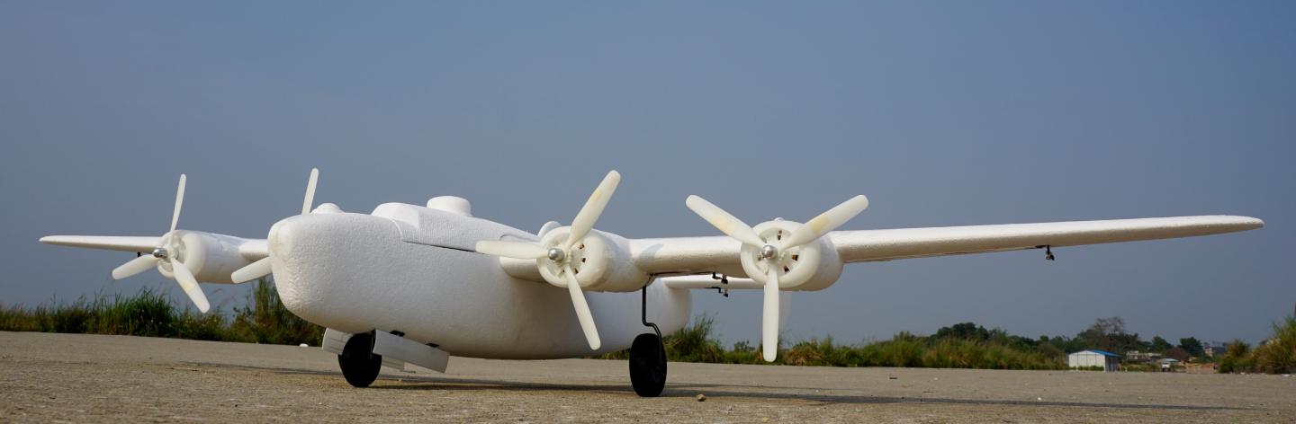

                                    Here's one from the CNC. 'Just to give you an idea of what the nose doors look like. Low Clearance!
                                        That looks great! Will there be door sets in the same container as the first batch, or are they coming later?
                                        Also, any idea when the STL files will be available for the upgrades?
                                          Thanks for posting that prototype photo, Alpha. Fortunately, on the real aircraft these nosegear doors didn't hang straight down, but were splayed out so that ground clearance wouldn't be an issue. I haven't seen the actual Flightline airplane yet, of course, but I think it is entirely possible to do the same thing as I did for the tailwheel doors on the FMS razorback P-47. This was using a spring stretched across the wheel well opening and attached to each door that kept the doors in the proper open position, and then when the gear retracted, the strut caught the spring and pulled the doors tightly shut. It worked great on my plane, and I am hoping I can do something similar with the B-24. I won't know for sure until I get the gear door upgrades and the model to start playing around with the idea.
