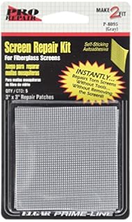

            What kind of mesh did you use for the cowl and radiators?

                          Thanks dkalwishky! Nothing fancy obviously... Pheonix, I used this stuff for the mesh:
                          My control arms on my inboard flaps are centered which has been the problem. Since it's all Y'd I can't adjust the end points individually, it affects all 4 flap servos.
