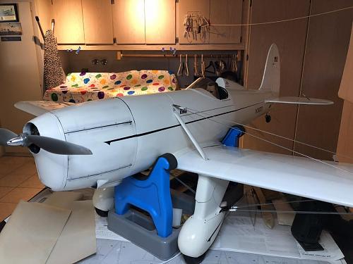

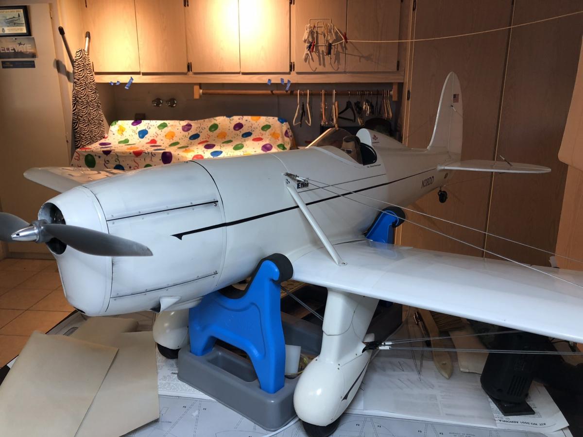

        • After working from home for 2 1/2 weeks and no Click image for larger version
ID:	252287 flying since field closed a month ago, tomorrow I will fly with a client for 3 hours in his M-600 and then in the simulator for another 3 hours. The field opens Saturday and I will try to get as many airplane in the CX-7 as will fit, including the Ryan.
          she is becoming much more enjoyable to fly and getting far less chin scrapes from nose overs. LoL! I got some serious gear improvements done and much needed touch ups.

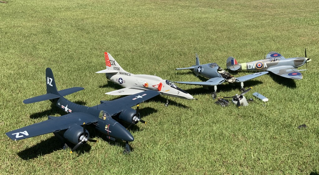

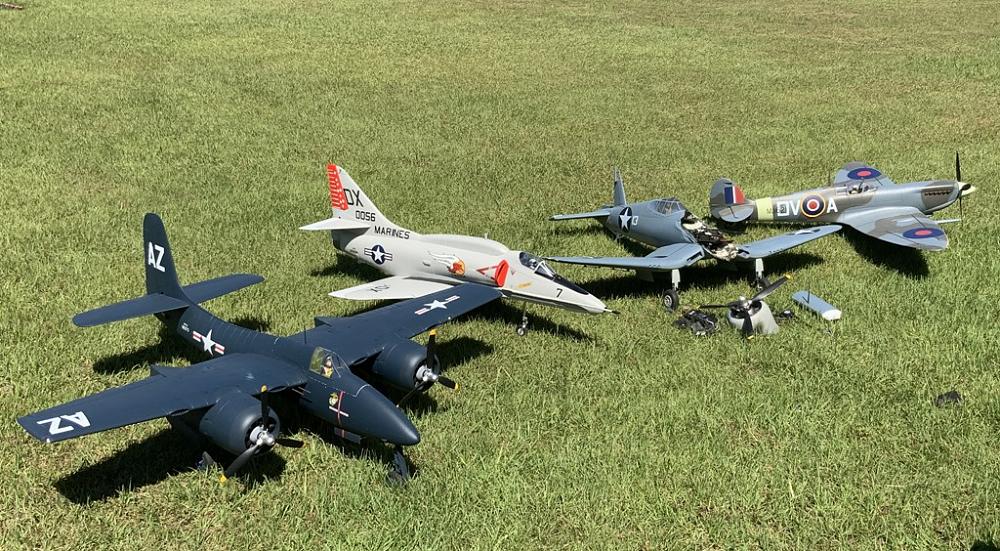

                • Well, we have absolutely gorgeous weather going here in SE Texas so a few of us decided to go fly. For the most part is was great. Got to fly 3 of the 4 airplanes I took to the field.

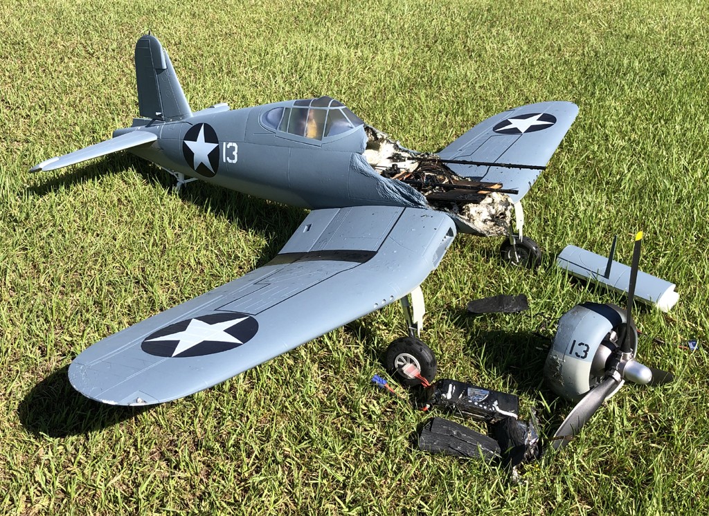

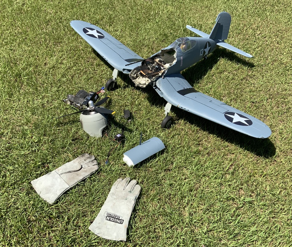

                  The not so good thing that happened was I got in a hurry strapping in the battery to my Corsair and didn't pay attention to where the metal loop was when I pulled, probably too hard, on the strap. The metal loop was at the corner of the battery and when I pulled on it it must have caved in the corner and shorted as the battery burst into flames. I sprinted to my truck to grab my welding gloves and was back and yanking the flaming mess out of the airplane within 15 seconds easy. Still, the damage was quickly done... Lesson to be taken away: Be mindful of where the loop is when tightening down your battery. Also, keep your gloves with you at the bench. One little mistake and there's $580 down the drain.

                  • Sorry Bro!!!! That really sucks for sure!!!
                    • Beeg Holey Moley, glad you're okay. Can that be fixed with a new fuselage and battery? Best, LB
                      • Ouch! Usually, we worry about "crash and burn." I guess you skipped the "crash" part!
                          I added up the parts I'd need and for an extra $100 I can get the whole thing and not have to salvage and re-install everything. If I could buy just one wing and the motor didn't get toasted It'd be worth it to rebuild. Basically everything in the fuselage from canopy/elev/rudd servo forward and the left wing root are fried plus loosing an Admiral 6s, 5000 battery and the receiver.. I could probably fill and sand the left wing root but I have too many other projects that need my time.
