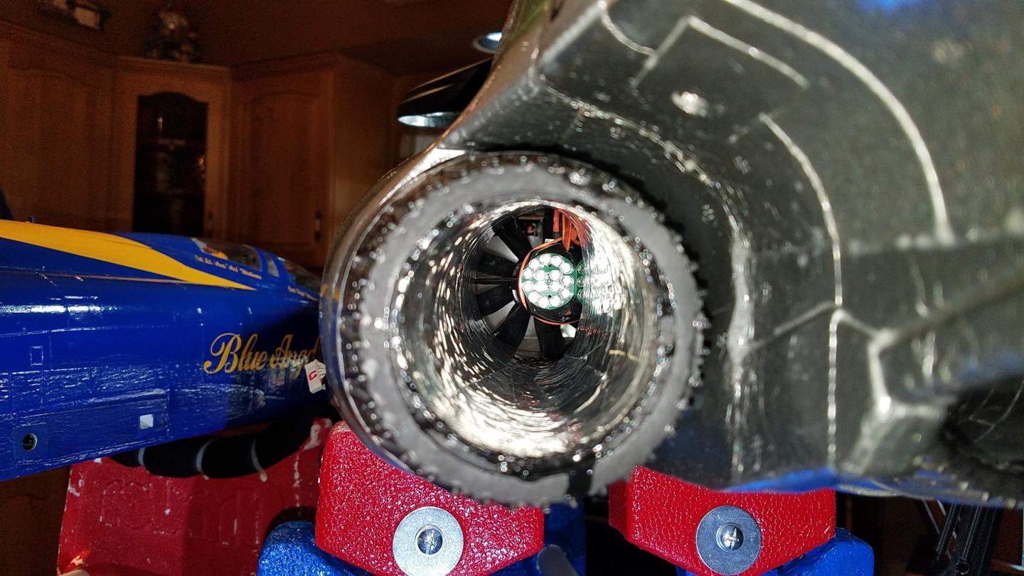

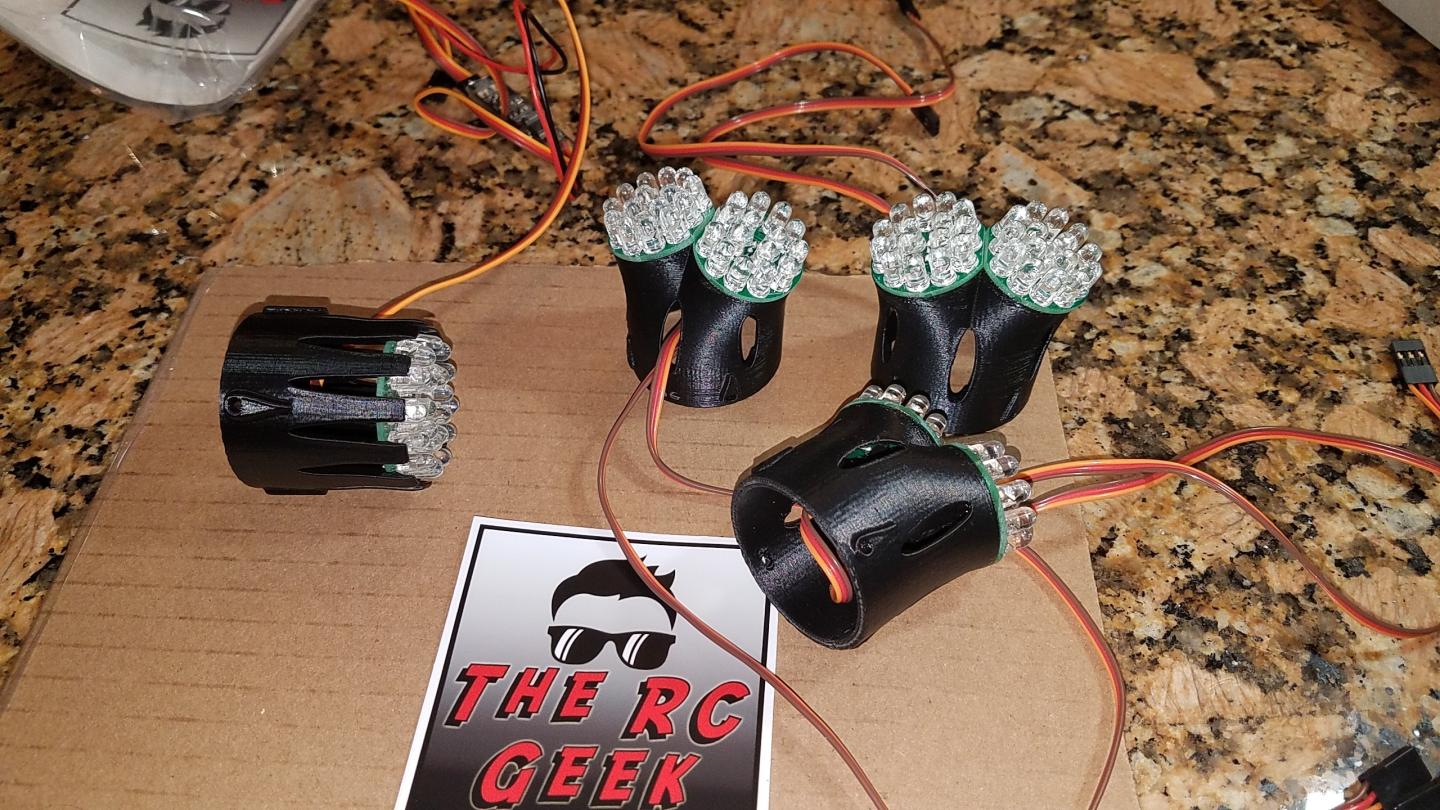

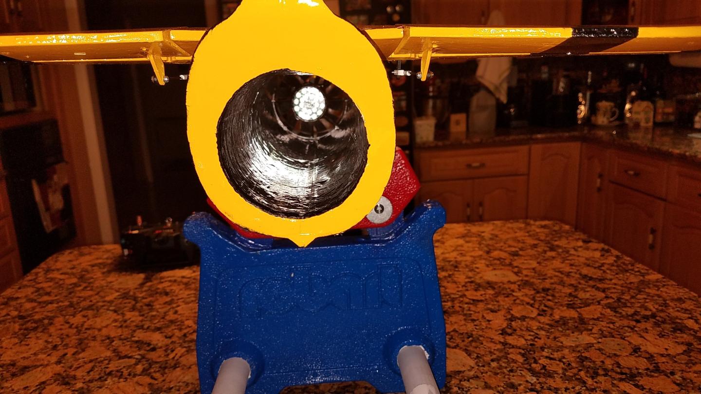

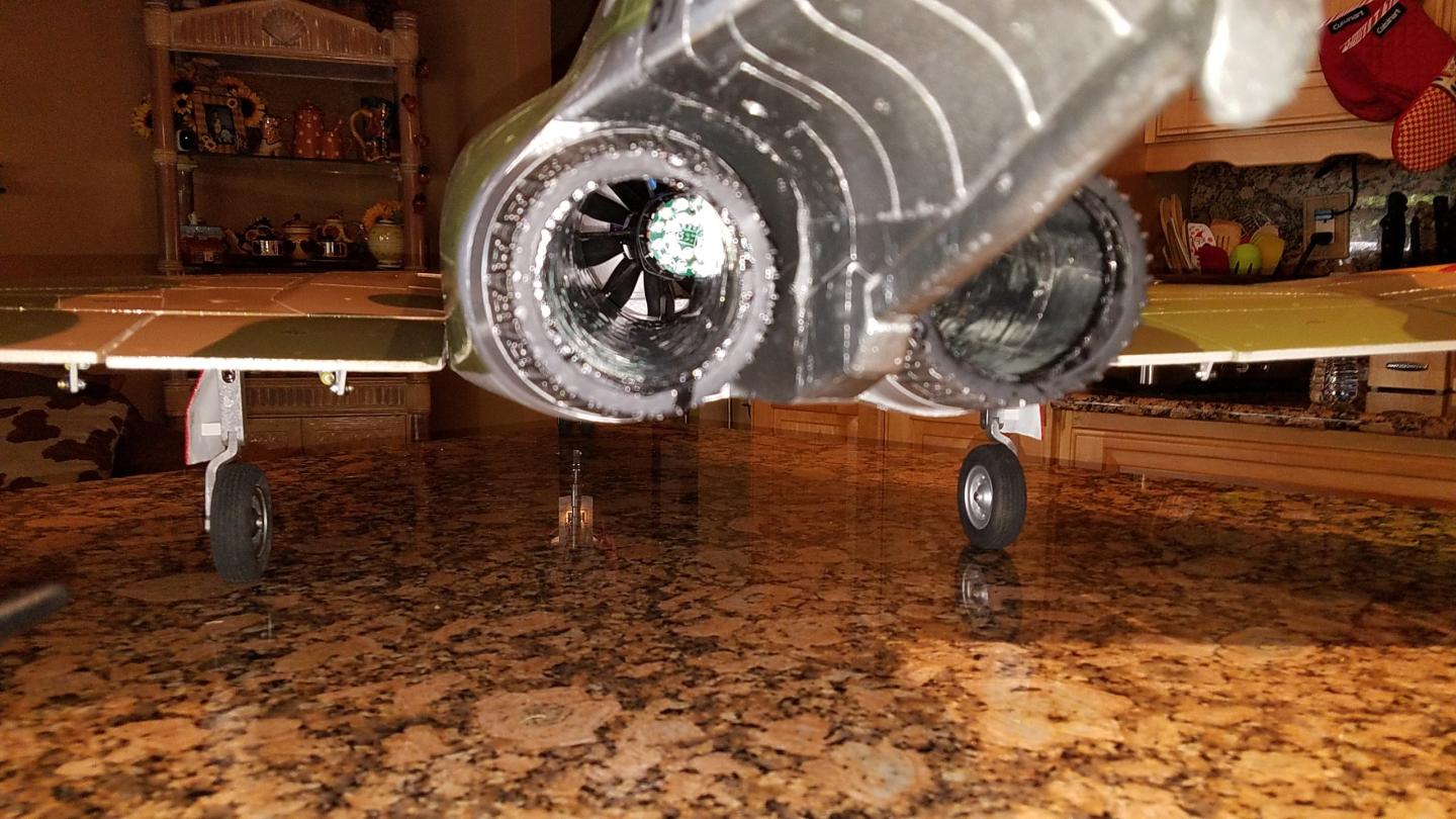

    Hey guys!
    Quick question.. Whats the best afterburner for the Phantom in your opinion?
    Thanks a lot!
    J5, great question as there are now several choices and which is best is an eye of the beholder issue IMHO.
    For example. MotionRC offers an inexpensive On/Off version, The RC Geek has a flickering/adjustable version, kallend has shown us all how to build one over on RCGroups, and 5280 RC has a multi-color flickering version.
    I have an older version from RC Geek in my Phantom and it is great and a gooniac33 in my Hornet, though I don't think he is offering his version any longer.
    So, this really comes down to how much joy you think you'll receive for the money, i.e., bang for the buck.
    I have muddied the water here I am certain, but there you have it.
    Best, LB
