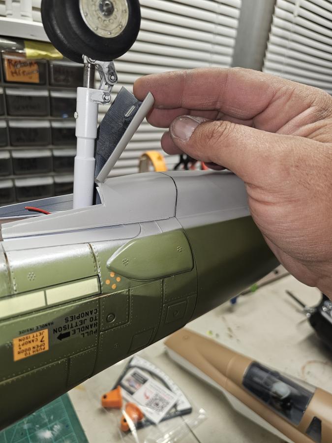

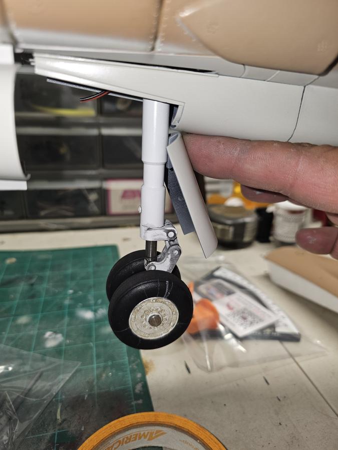

    That was my issue also with the nose door dragging the paint off the strut. I'll post something when I get it figured out. Hopefully soon, but I think your right about the c hinge helping to offset the door better.
    commented on 's reply
    Worth a shot? Maybe? I modded the nose gear doors (1:1 scale 3 doors rather than the OEM clamshell 2 doors) for my Freewing Fa-18C Hornet and added the strut door. I used 0.5" brass tubing for the strut door slide and cut it to 0,09" width to slide over the long OEM plastic strut brace. Works fine, but scratches the strut paint a little. Sounds like a good idea to start. Best, Steve
  • Maverickpro
    That was my thought also. Only issue is with the gear door pressed against the strut the stand off likes to catch the stepped down part of the strut and bind up. Maybe a piece of brass tube over that portion will help it just slide against the strut.
