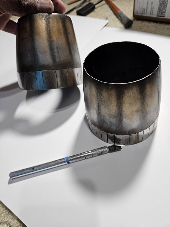

                                    Test...

                                        #319
                                        Excellent work. Can you give the details on how you got that look. Paint colors, etc. I keep trying on my F-4 turkey feathers but haven't got the look I want yet.
                                        Best regards, Rex

                                          #320
                                          Sorry, I didn't mean to be misleading...I needed to test the forum's ability to embed images so I selected a random image I had on my HD. All credit goes to a guy on FB named Ray Vaughn. He does some pretty amazing weathering work and is accepting requests. You can find him on our Motion RC Community group among others.
