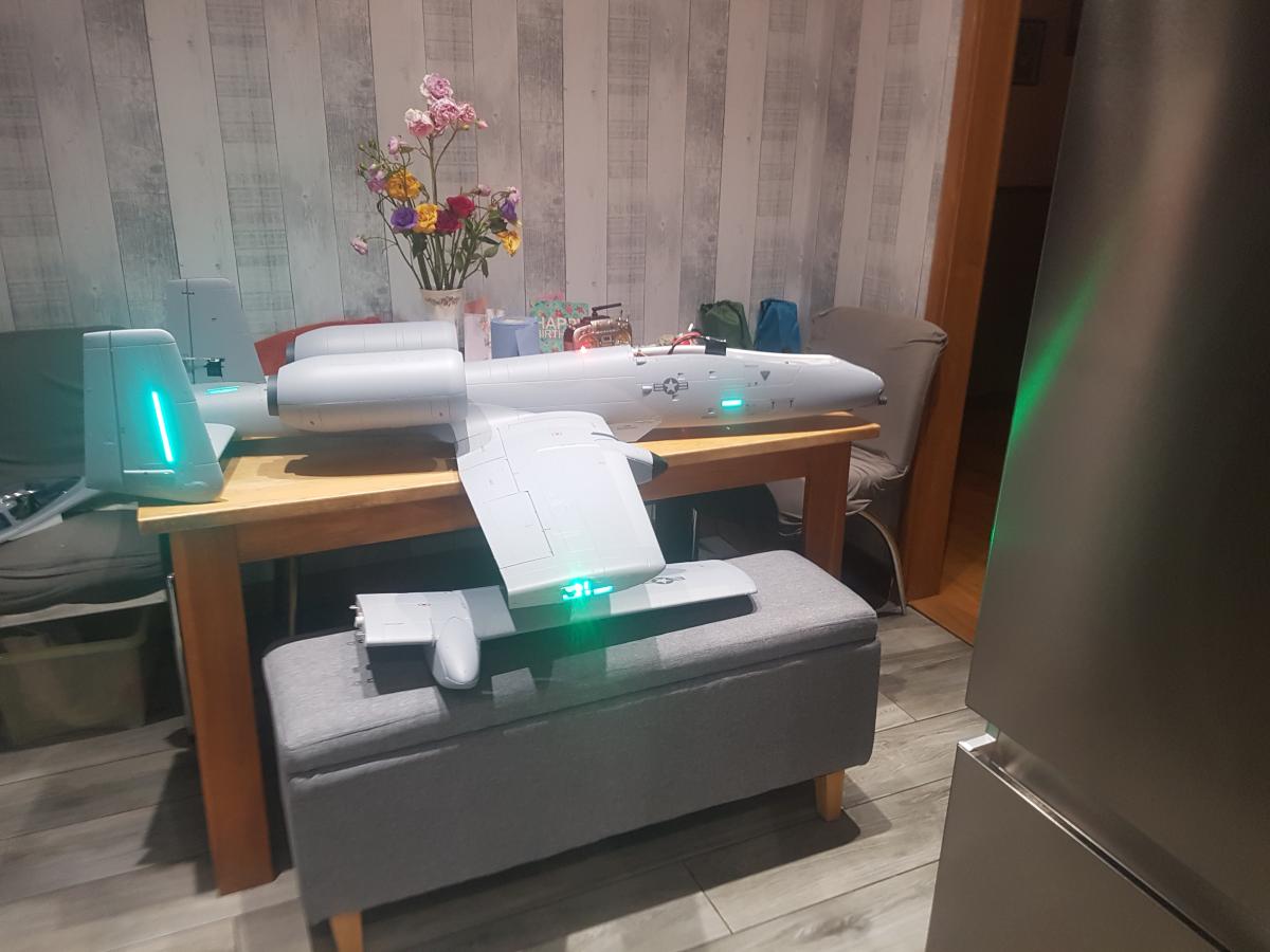

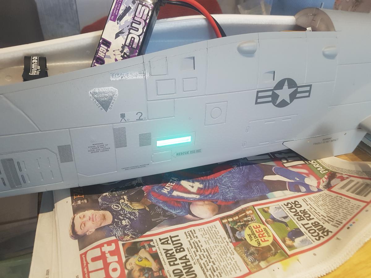

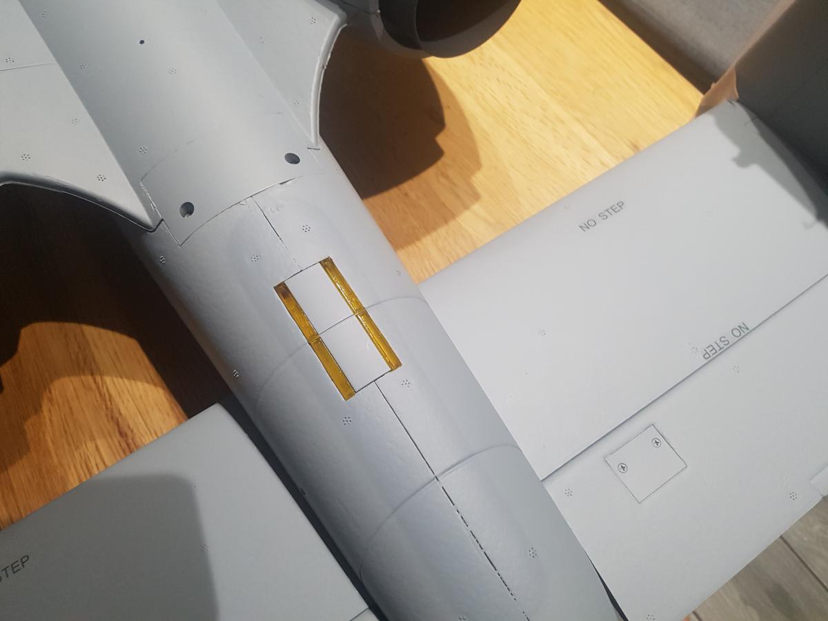

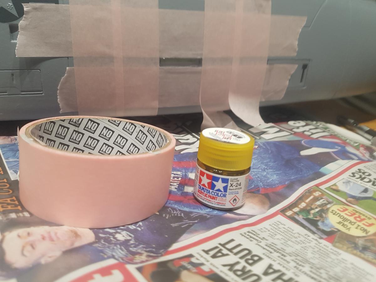

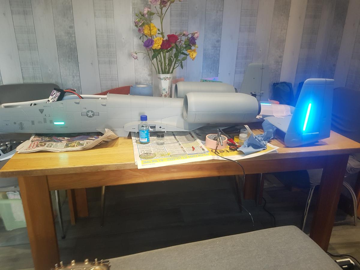

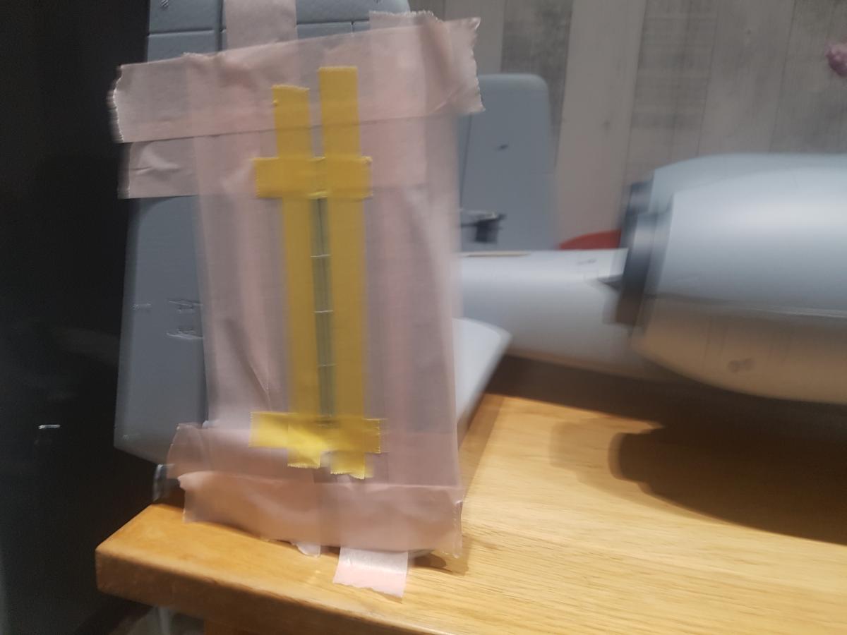

        Spent few hours correcting my slime lights. Roughly 20 coats of Tamiya X24. Its halved the brightness which is an added bonus too.
        also shown is a great masking tape, you can leave this on for days and it won't lift paint off EPO. I went over the edge of the plastic light mounts and then used Tamiya tape to give a sharp edge up to the light lense.

                        I am going to assume that you airbrushed the Tamiya Clear Yellow (looks great)... What did you thin the clear with? I have had trouble spraying that particular brand through my airbush.
                          There is enough space in the X24 bottle to add the correct amount of X20 thinner for airbrushing. You can brush it on with good results but it is much quicker to air brush as each coat dries instantly. I did the last coat heavier so it looked wet as that gave a nice shiny finish. You can't do too many coats.

                            Just to expand on my last post, I spray very light, you almost can't see the paint going on with each pass, this is the quickest way of doing it.
