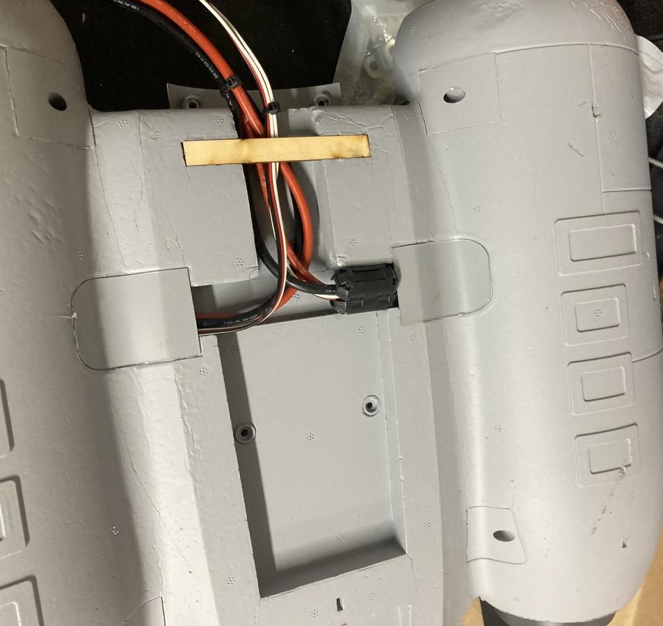

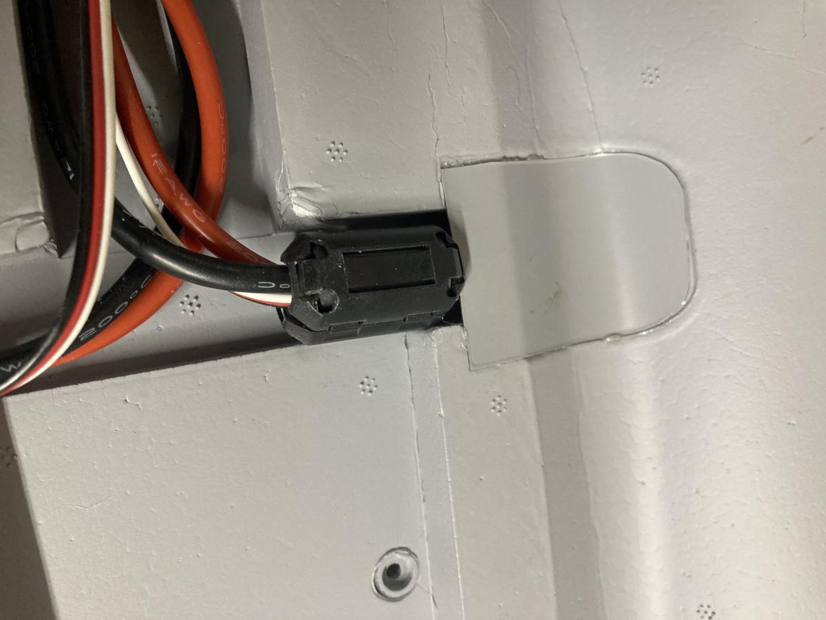

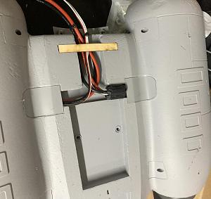

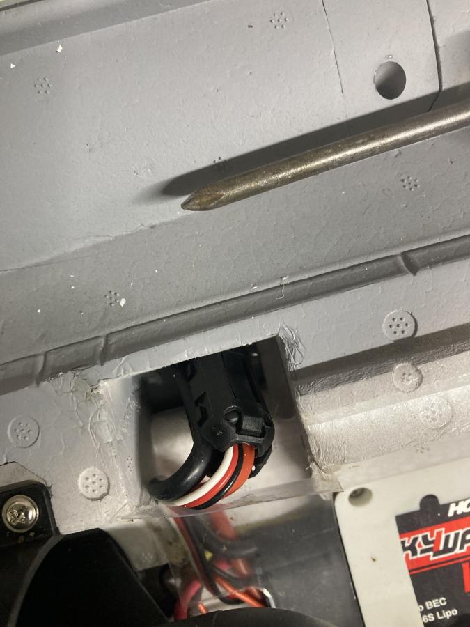

      I still have my V1 power pod from the crashed bird. So, I opened it up to investigate where one could place the RF chokes. Remember, the closer to the ESC, the better.
      Plenty of room and 2 placement options….
      Note, These are not clipped or zip tied. I was simply experimenting with placement options.
      You can bet that my V2 will have these installed. I’ve learn the hard way what happens if you don’t use them.
      Then a small one will be placed by the green ferrite ring choke up by the receiver.
      Three chokes total. Consider adding them to the SR-71, too. There is lots of room in the SR’s motor nacelles. I did…and I am confident the SR-71 is better (less chance of loss of control) for having done it.
      Photos below are from both the topside and bottom side of the power pod. Zoom in and you will see the black chokes around the big main red, big main black and the smaller red/black/white throttle signal wires.
      Only one of 2 power module RF chokes is placed and not closed or zip tied…experimenting only.
      -GG
      PS…This A-10 VERY likely crashed because the RF chokes were not used. It experienced a total loss of control one day. I was discussing this crash with a Ham Radio guru…he clued me in on the need for using the chokes.

        Great, what size do you recommend for these EDFs?

          #24
          From the variety pack (Amazon), pick what size fits in the room you have. Bigger wires will take bigger chokes to be able to close. Minor foam trimming may be needed. For the UBEC-to-RX wire, use the smallest choke from the variety pack.
          Any choke is better than none.
          -GG
