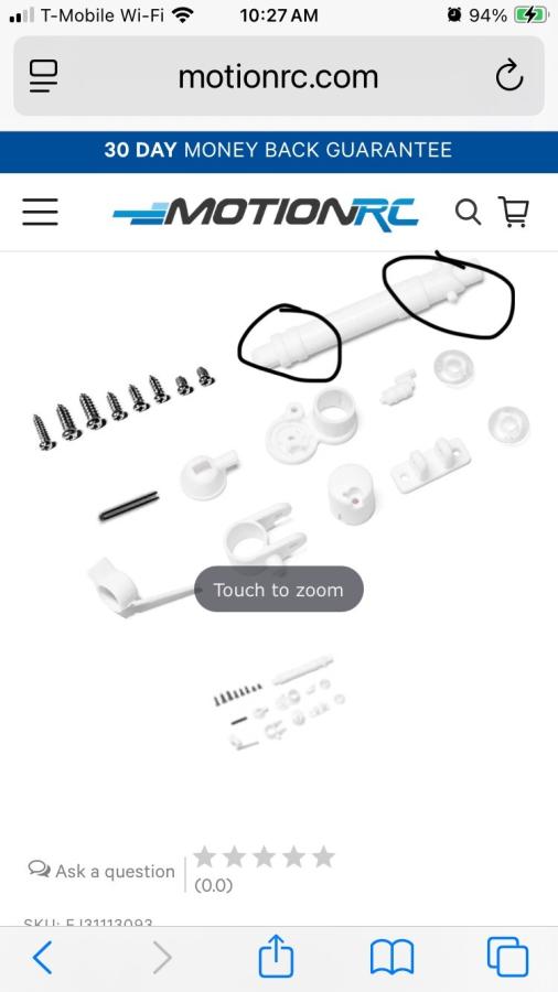

                                When these get stocked up and available, you may want to order a set or two. I had a pin break off (circled area) due to a less than perfect landing this morning. 4 flights…amazing amount of thrust!
                                I have a temporary fix in mind for this “not important…for looks only” part.
                                The protruding pins (they are on both ends) can’t take much stress. NOSE GEAR SCALE PARTS ASSORTMENT
                                -GG
                                Click image for larger version  Name:	IMG_3231.jpg Views:	0 Size:	36.9 KB ID:	424124

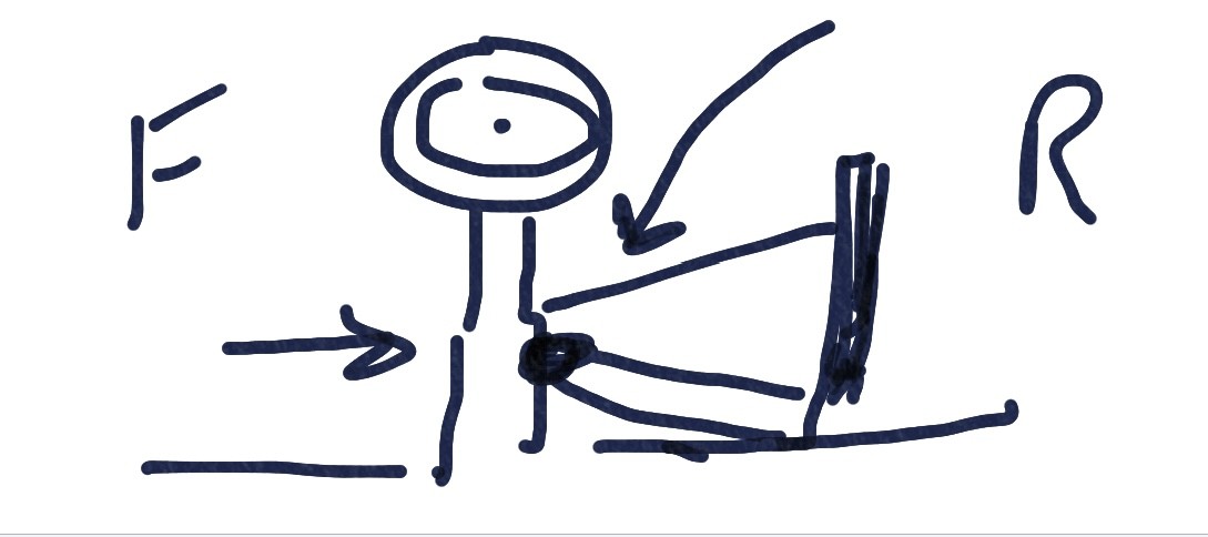

                                        Click image for larger version  Name:	IMG_3232.jpg Views:	0 Size:	55.1 KB ID:	424140 UPDATE to Post 95…
                                        Apologies for the rough sketch….F = front, R = rear
                                        Nose gear area…
                                        If you will put a dollop of RTV Silicon rubber (black glob in the sketch indicated by the arrows), and be careful not to get any “inside” the slide tube, this will hold the outer decorative slide tube shock strut in place and relieve the stress off the 2 small plastic pins at the end nearest the gear strut.
                                        I was able to repair the missing plastic pin by using a tiny screw and some minor Dremel work. Once I made the repair to the broken outer slide tube pin, I added the silicon rubber to secure it all in place to the nose gear strut and to help it not break again.
                                        The rubber allows things to flex that need to flex during retraction/extension.
                                        Works well…. Strongly suggest you add the silicon rubber “now” before you break the pins. The pin repair was a bit tricky. It required Dremelling a small trench into the inner core to accommodate the end of the screw that replaced the pin.
